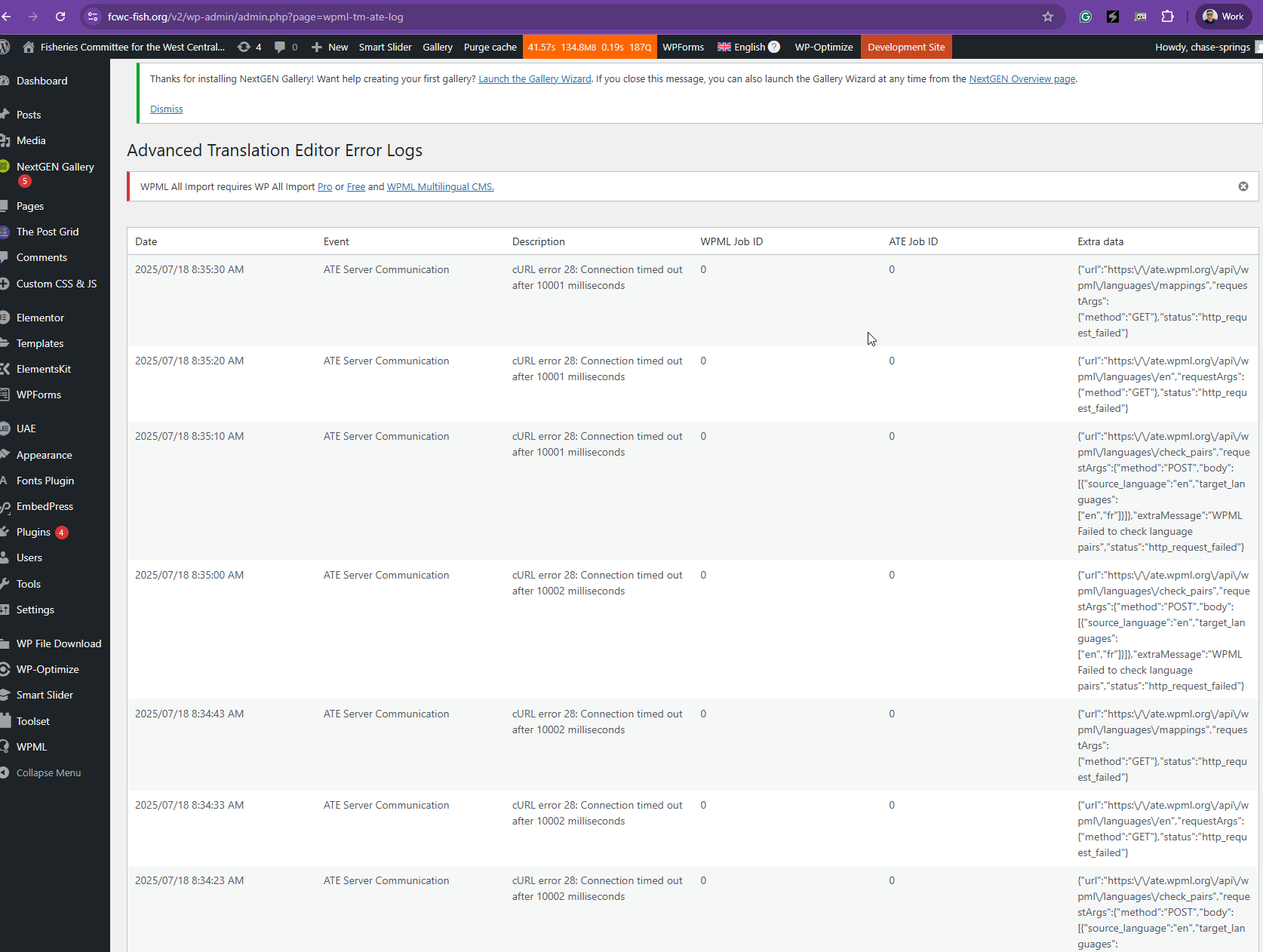

Thanks for your reply. I've rechecked here hidden link and I'm still able to see the connection issue with your hosting provider as shown in the attached screenshot. Have you checked with your hosting provider regarding the error?
July 18, 2025 at 5:42 pm #17251736
buajorP
I whitelisted the hostnames but it seems that didnt stop it from being blocked. I have disabled it one more time, please check now.

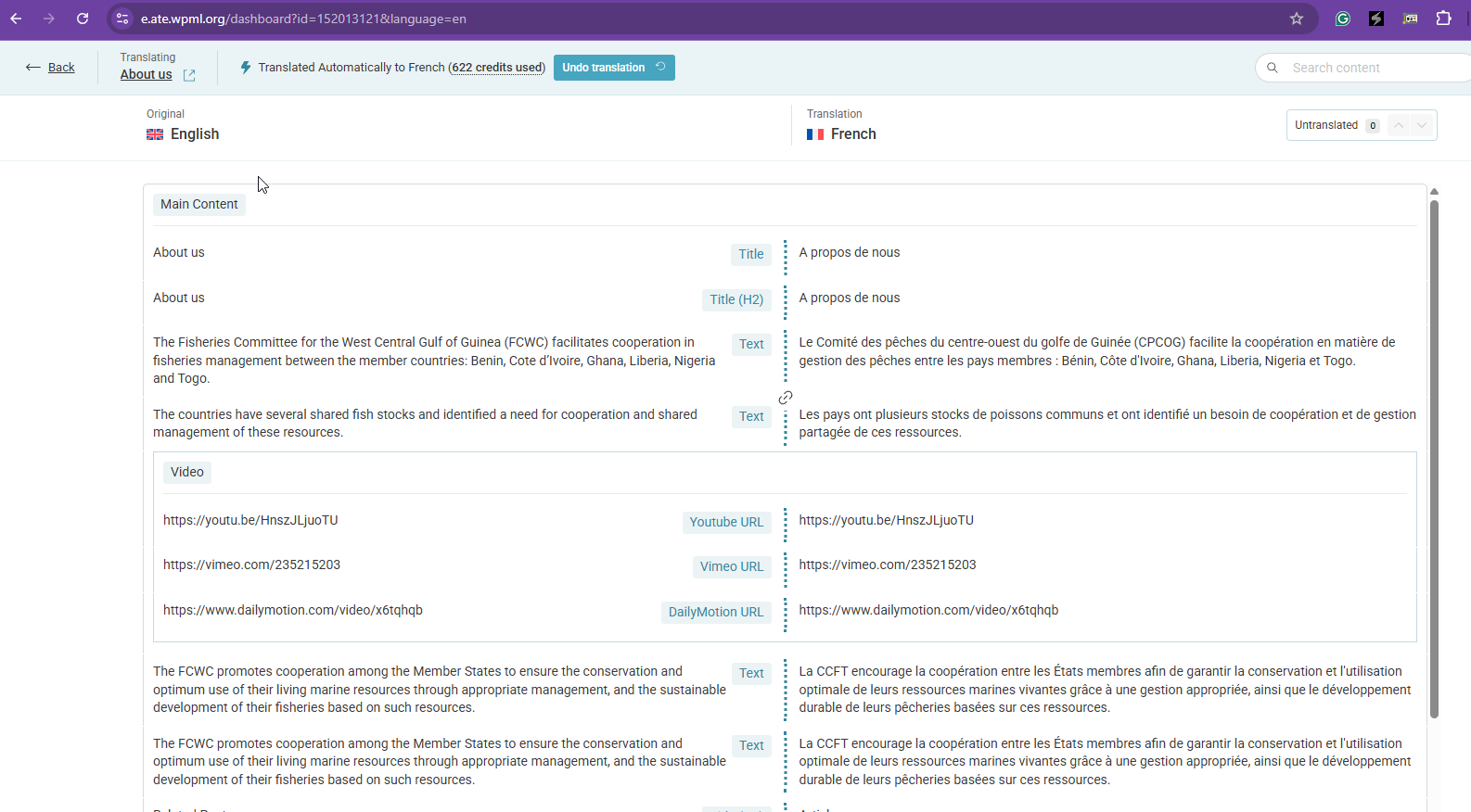

Thanks for your reply. I can see everything is working fine now. I'm able to translate the About page without issues. Could you try this on your end?
July 22, 2025 at 11:45 am #17259042
buajorP

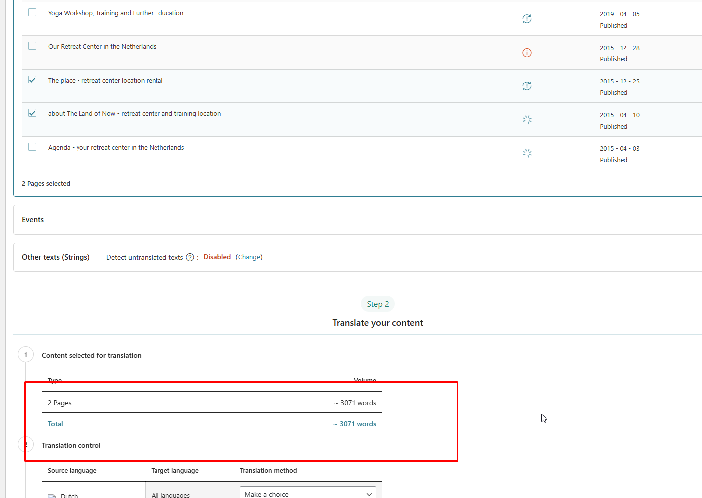

Is working fine now, however it seems we need more credits in order to translate the entire site. Please advise and how much credit worth will we need for this?
We get the attached error...
July 22, 2025 at 2:26 pm #17259730
Thanks for your reply. When you submit pages/posts for translations, you'll see the required amount of credits shown at the bottom of the translation management dashboard as shown in the attached screenshot. Then, you can calculate the cost using the feature here https://wpml.org/documentation/automatic-translation/automatic-translation-pricing/#getting-your-websites-word-count
