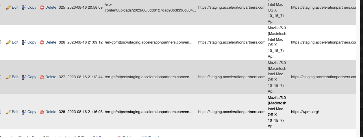

Also uploading a screen shot of the wp_redirection_404 table, you can see what's been stored.

I've checked the video and understood the issue you're having. Often, posts within the custom post type display a 404 error either due to not defining the slug correctly for the post type in WPML Setting or potential corruption in the permalink structure.
Please go to the "WPML > Settings > Post Type Translation" section and make sure that a slug is defined for the post type in both the default and secondary language. Also, make sure to resave the permalink structure by going to the "Settings > Permalinks" section.
However, I checked your site and found that all the posts under the resources post type are loading correctly on the frontend. Please check this video(hidden link) for a better understanding.
As everything is working fine now, please let me know if you need any further assistance in this matter. I will be happy to help.
