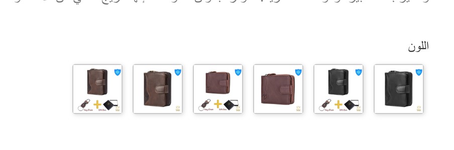

Is it the way to display the attributes coming from the plugin AliDropship Woo Plugin?
I cannot activate that plugin on the test site as it display fatal error. And without this plugin it works, but the attributes are displayed as a select input.

Could you please tell me which plugin displayed attributes as shown in the attached image?
January 3, 2024 at 2:05 pm #15147144
mhd-eiadA
First, I tried my way, I delete aliwoo plugin, and tested, still the same problem.
As for your question, in fact I do not know, I import the product through aliwoo , then modify the photos and improve SEO and publish it.
