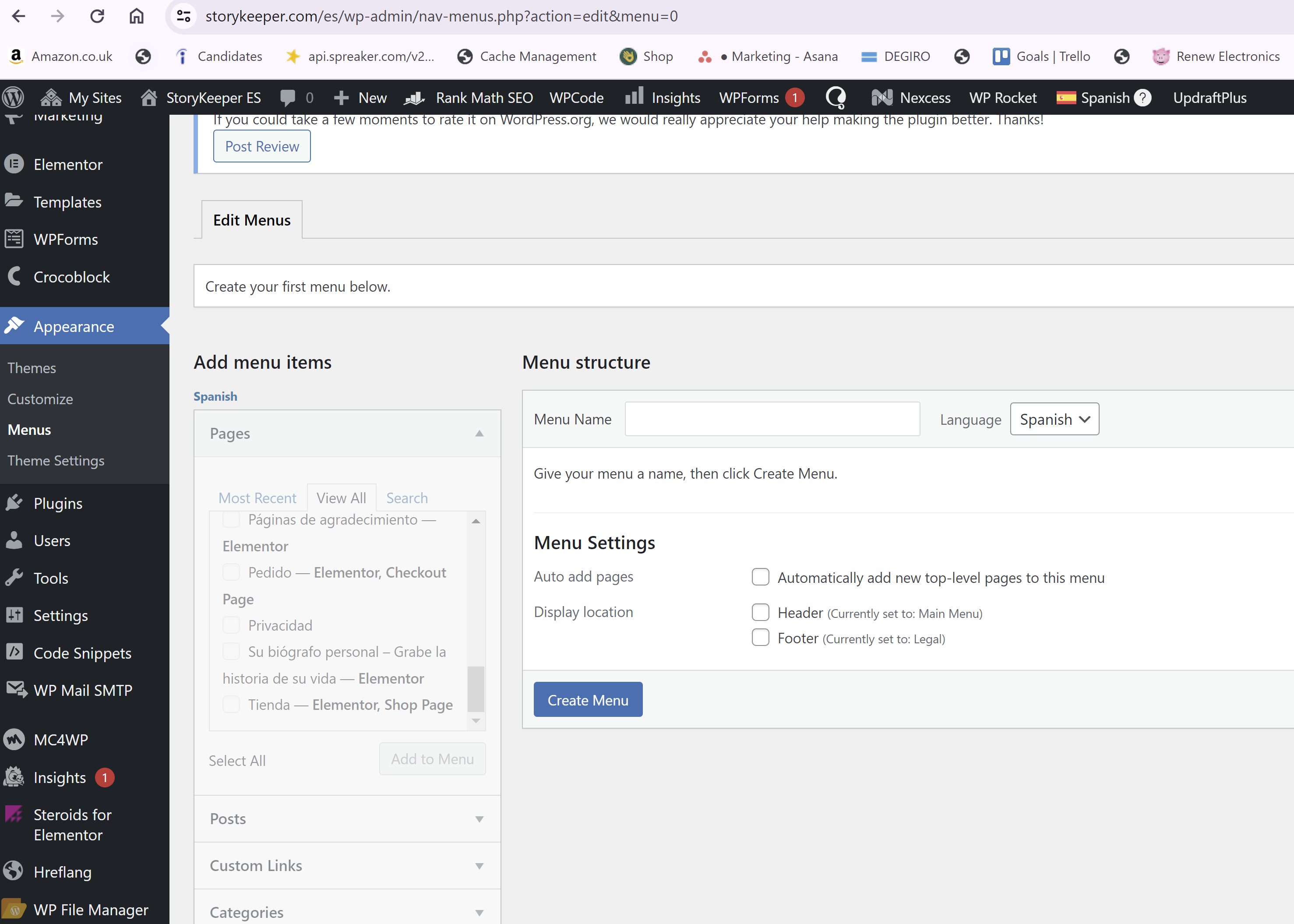

After all of this the menu is not enabled when I go to edit it however it is still on the site.

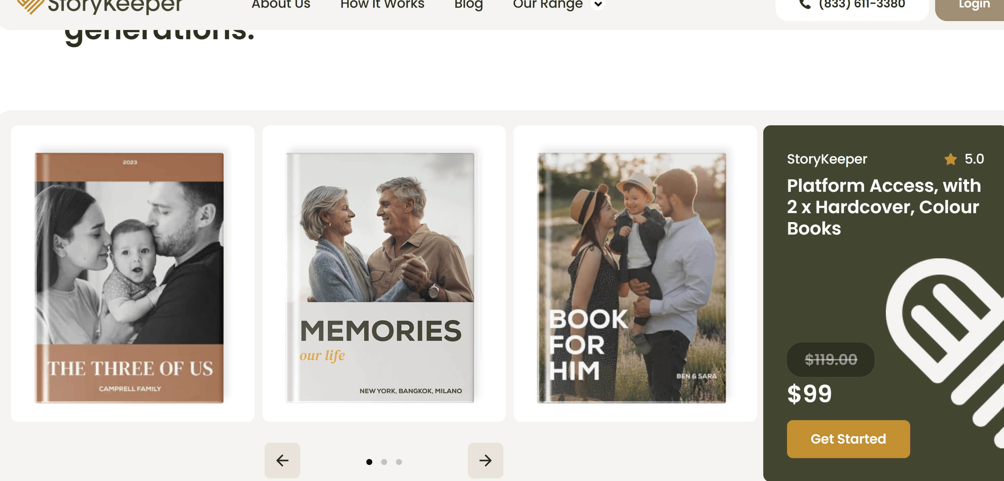

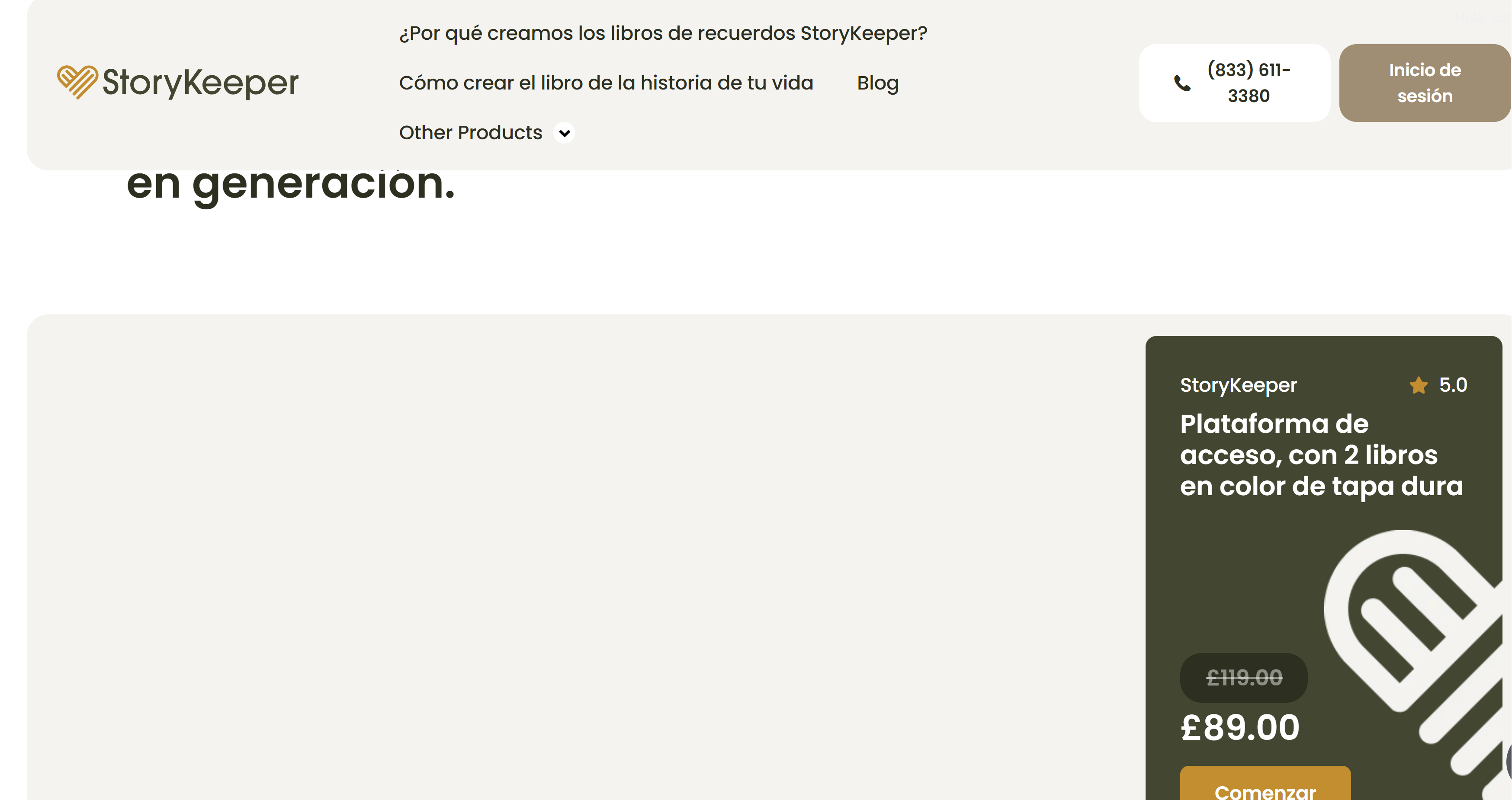

Also we have two sections where book covers are pulled from the main image of a product and shown. After we use the translate function the book covers appear to disappear. storykeeper.com/es (Translated site) storykeeper.com (Original site) storykeeper.com/de (Site that has not yet been translated for your reference)
