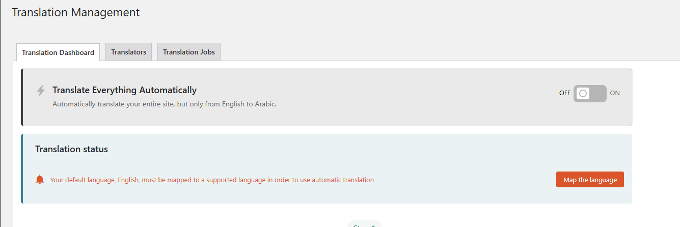

I am working on a site under development and I want to enable automatic translation using WPML.
I can't enable automatic translation.
How can I enable automatic translation in WPML?

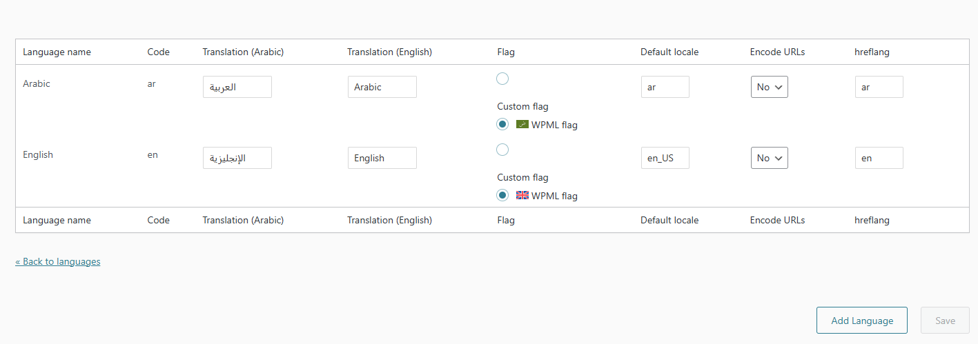

May 23, 2025 at 1:04 pm #17066440
innovexA
here all correct I match with another websites also

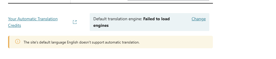

May 23, 2025 at 1:11 pm #17066465
innovexA
Also Failed to load engines for automatic trasnslation

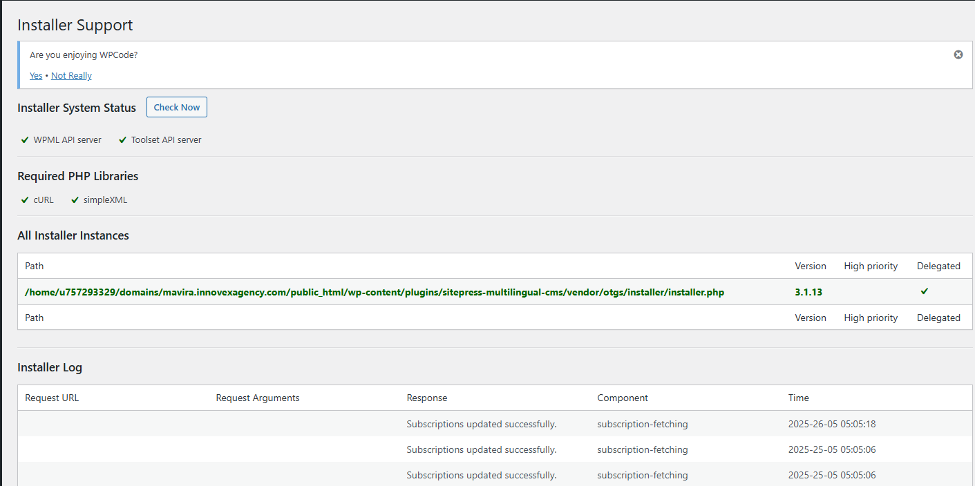

May 24, 2025 at 5:53 pm #17068986
Did you recently migrate this site?
Please revise WPML > Support > Installer Support (last link on the page).
Click "Check now".
Do you see any issues regarding API connection or site key registration?

May 26, 2025 at 5:14 am #17070813
innovexA
There is no issue in support installer I think I am attaching the screenshot also and on the Troubleshooting page I cannot find the section "Your Automatic Translation account id is".

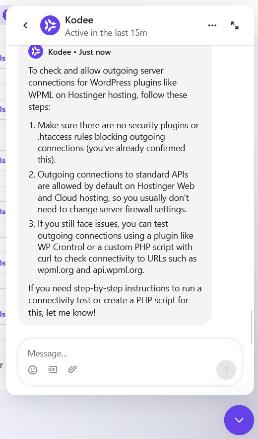

May 28, 2025 at 5:15 am #17081180
innovexA
Sir we are using hostinger hosting service and this is our development server our all development websites on this server.
May 28, 2025 at 6:30 am #17081295
innovexA
I contact the support they mentioned this if the issue is in hostinger my other development websites also gets infected but it is working fine so issue is something else please check
