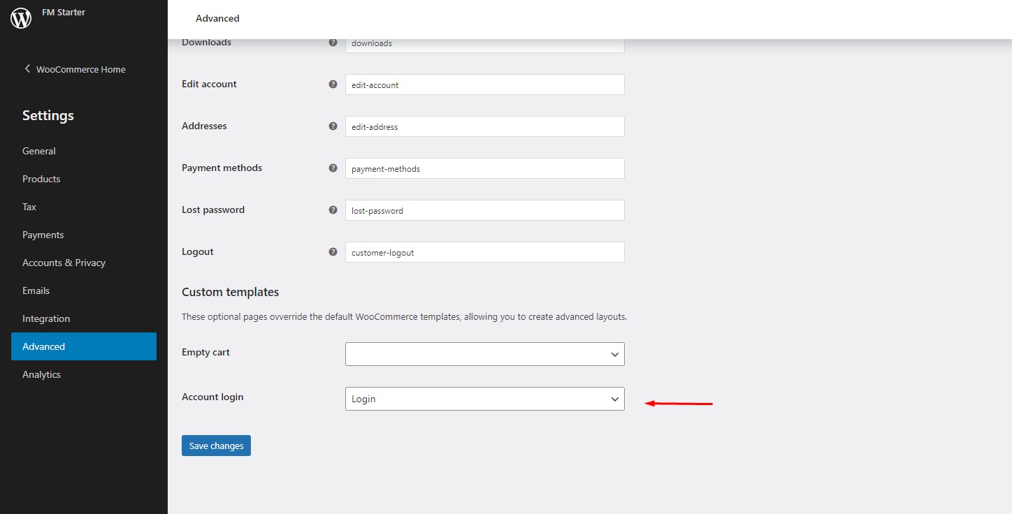

I have checked your website and was able to see the issue, then reproduce it from scratch on a new website and confirm this bug with the Uncode theme.
Seems you are creating a custom page named Login and then setting this page as a custom login template via WooCommerce settings. The issue here is that 2nd language page is not being set in this option, should be auto-synced from the default language option.
I have escalated this to our compatibility team and we will contact the theme author and work on a permanent fix.
In the meantime you can use a simple workaround:
- From topbar in admin, switch to 2nd language (English)
- Go to the same option and select the correct login page for English
I have checked and it works fine. Image attached.
Please check also yourself and it works fine, You are free to remove the staging site.
Drazen
