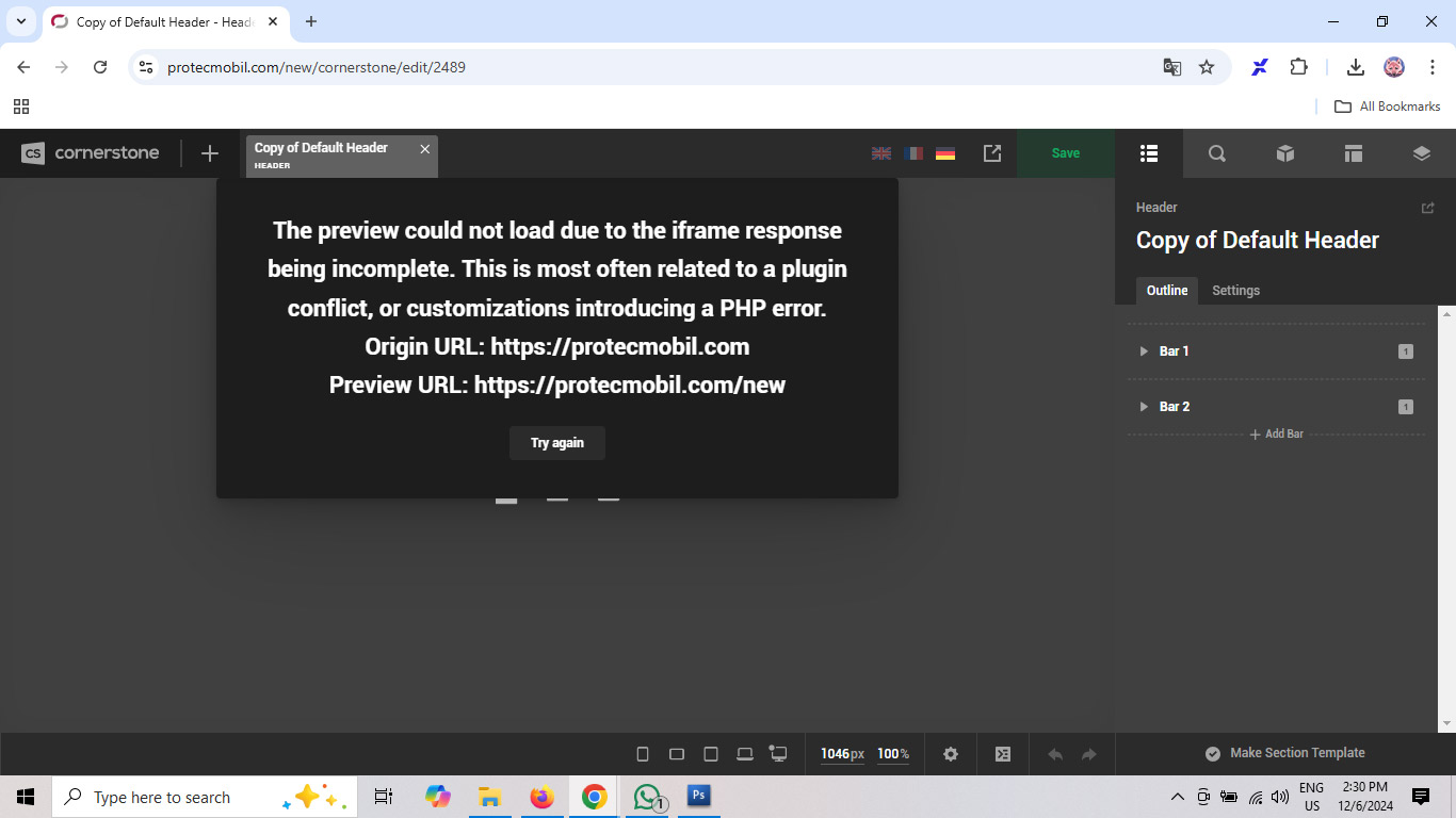

I have copied the site from hidden link to hidden link for WPML. After setting up WPML in hidden link, I tried to edit the header but it is showing error.
The preview could not load due to the iframe response being incomplete. This is most often related to a plugin conflict, or customizations introducing a PHP error. Origin URL: hidden link, Preview URL: hidden link. Edit pages are working fine, but the issue is just with the header. Deactivating all plugins except WPML did not resolve the issue, but deactivating WPML plugins allowed the header to be edited fine.
Why does the header edit show an error when WPML is active?
How can I resolve the iframe response error related to WPML?

We found a difference that doesn't exist on the sandbox and might be part of the problem here
When we try to load the header, we get a 301 redirection from hidden link (which is the site URL according to the settings) to hidden link (notice the last trailing slash).
This is the only thing that seems to differ between the test we made and your site. Changes like these seem irrelevant but are usually part of a bigger situation.
Do you have plugins that create redirections automatically or are you aware of this redirection? There shouldn't be any redirections at all, especially in the back-end so it might be this that's causing WPML to break the page.

Oh seems like its font issue. Fonts are loaded from hidden link site. I have reset the fonts to load from hidden link and now header editing is working fine.
Thanks for your support!
