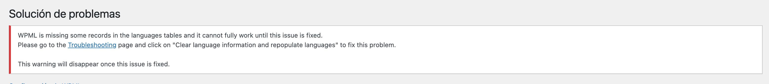

We are having a problem with the translations on this site. We use WPML with Jet engine often and haven't seen this issue before. Actually, when we initially installed WPML we got a message about an error and it asked us to reset the translations, I have added a screenshot of this for reference, we did that and the alert was gone but we were still having problems.
We have tried a full reset and complete uninstall and reinstall but there still seems to be an issue with the translations working correctly.
