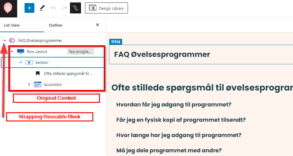

thanks for spending the time to get this to work. I do feel however, that this work around is fairly involved and I am concerned with the long-term maintainability. I did thus explore a different solution and I believe that my alternative is much easier, more straight forward and applies generally to Kadence Elements without any extra work from customer or WPML side. As a matter of fact, I feel that this alternative is much better than the official how-to (https://wpml.org/documentation/translating-your-contents/using-different-translation-editors-for-different-pages/#how-to-use-manual-translation) and the related forum article (https://wpml.org/forums/topic/translated-kadence-elements-fail-to-show/).
The trick is to wrap all content residing in an existing Kadence Element into a "Reusable Block". Nothing else! No enabling "Translatable" for Kadence Elements, no classic translation interface, no content duplication, yada yada - none of that. Just a Reusable Block - that's it!
Further comments:
All placement rules that can be configured for Kadence Elements (of course) still work and even shortcodes can be used to place Kadence Elements for instance on Product pages. WPML will automatically create a translation job for the Reusable Block as soon a page containing that Reusable Block is translated. The exception is shortcode placement of the Kadence Elements (for instance on Product Pages): using a shortcode, WPML doesn't automatically create the translation job for the Reusable Block. As a work-around, I create a private page containing all my Reusable Blocks as pure Reusable Blocks, i.e. not using any Kadence Elements placement mechanics, at all, and simply translate that page through WPMLs ATE. WPML will create translation jobs for all contained Reusable Blocks automatically and once these are translated (using ATE!), the translations of these Resuable Blocks will apply to all places where the Reusable Block was used - also when reference by a shortcode.
I haven't tested this solution very thoroughly, i.e. there might be scenarios, where additional work-arounds are necessary. I do feel however, that this is much easier to handle Kadence Elements than using the classic translation editor and what not...
