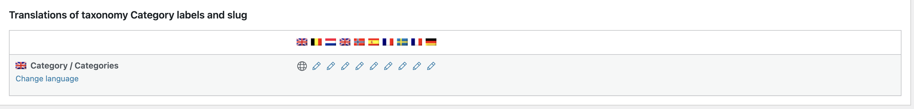

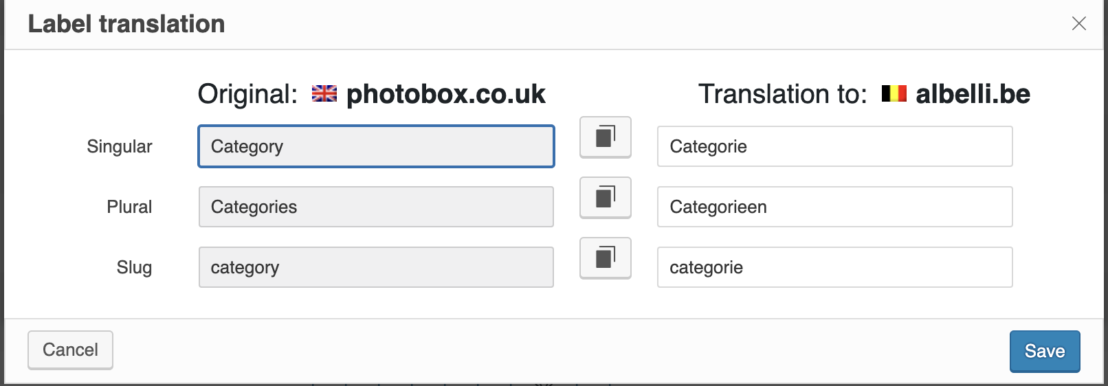

In relation to the suggested solution, I believe we already have a category base slug assigned to the site's default language as well as the category base slug is translated into all other custom languages. Attaching two screenshots that demonstrate this.
Please correct me if the screenshot don't confirm this.
Also, did you try the steps recommended by your 2nd tier team? Did it help?
July 16, 2024 at 11:10 pm #15962965
Ilyes
Yes, I did try the solution and since I didn't have the clear steps to test this correctly, I assumed it was working,
So I went ahead and found out that this doesn't help to solve the problem, so I escalated it back again,
