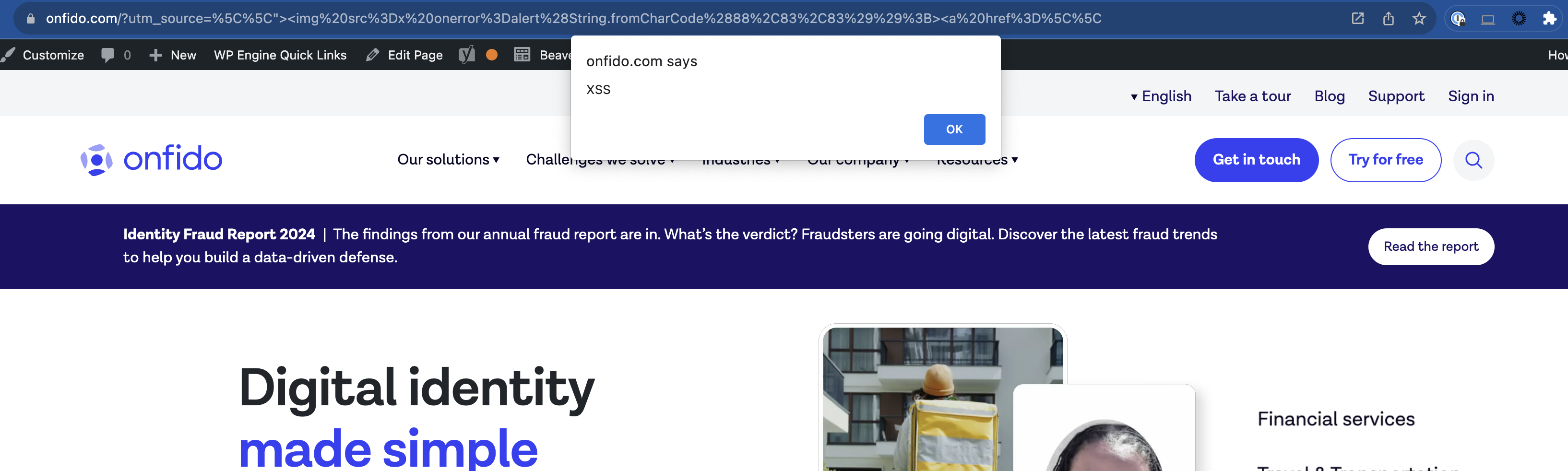

I am trying to:
Link to a page where the issue can be seen: onfido.com/?utm_source=%22%3E%3Cimg%20src=x%20onerror=alert(String.fromCharCode(88,83,83));%3E%3Ca%20href=%22
I expected to see: no xss alert
Instead, I got: the alert which indicates reflected xss vulnerability exists (on language switcher - when parameters are allowed to pass - which we need for UTMs)

December 1, 2023 at 3:01 pm #14974081
dylanH-10
Hi Laura and team,
thank you for your quick response. Unfortunately after update to 4.6.8 (and clearing caches) this issue is still persisting for me here
Could you assist with this? Seems to me there were some updates, but in my case it doesn't seem to address the bug.
thank you for your help

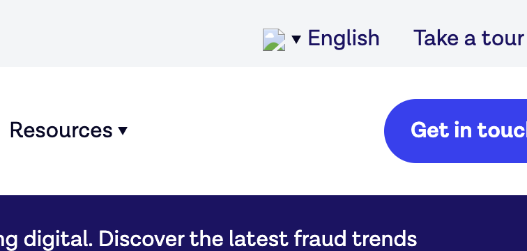

dylanH-10
an update.. I do see that the utms are stripping script info on the links, but it is providing some strange behavior on the language switcher. Maybe this is intentional or just a behavior from adding cruft to the params, but it seems strange, perhaps one of your team can take a look.. Language switcher is on top menu as seen in pic.. Thanks again for your help

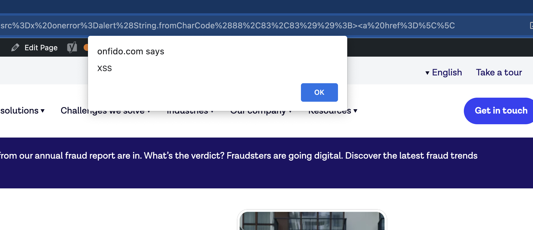

Hello and thank you for your help
1) Strange behavior: it is adding empty images to the language switcher (where flags would be if I set it up that way) and still opening xss dialog which means <script> is still usable in the parameters
2) The issue happens with all themes even with other plugins turned off
3) On this test site you sent me there are no languages set up or language switchers. I can't set up a whole site from scratch to test this... I need something with a language switcher. We have a very small team with a huge workload. Could you set up a test site with a language switcher in the menu, or at least tell me what I'm supposed to do with an empty theme?
if you look at the page hidden link. the issue still persists, I even tried on a stripped down version of site, which did not have any different results.
the issue persists, and we are having to provide bonus's for vulnerability scavengers at this point..
