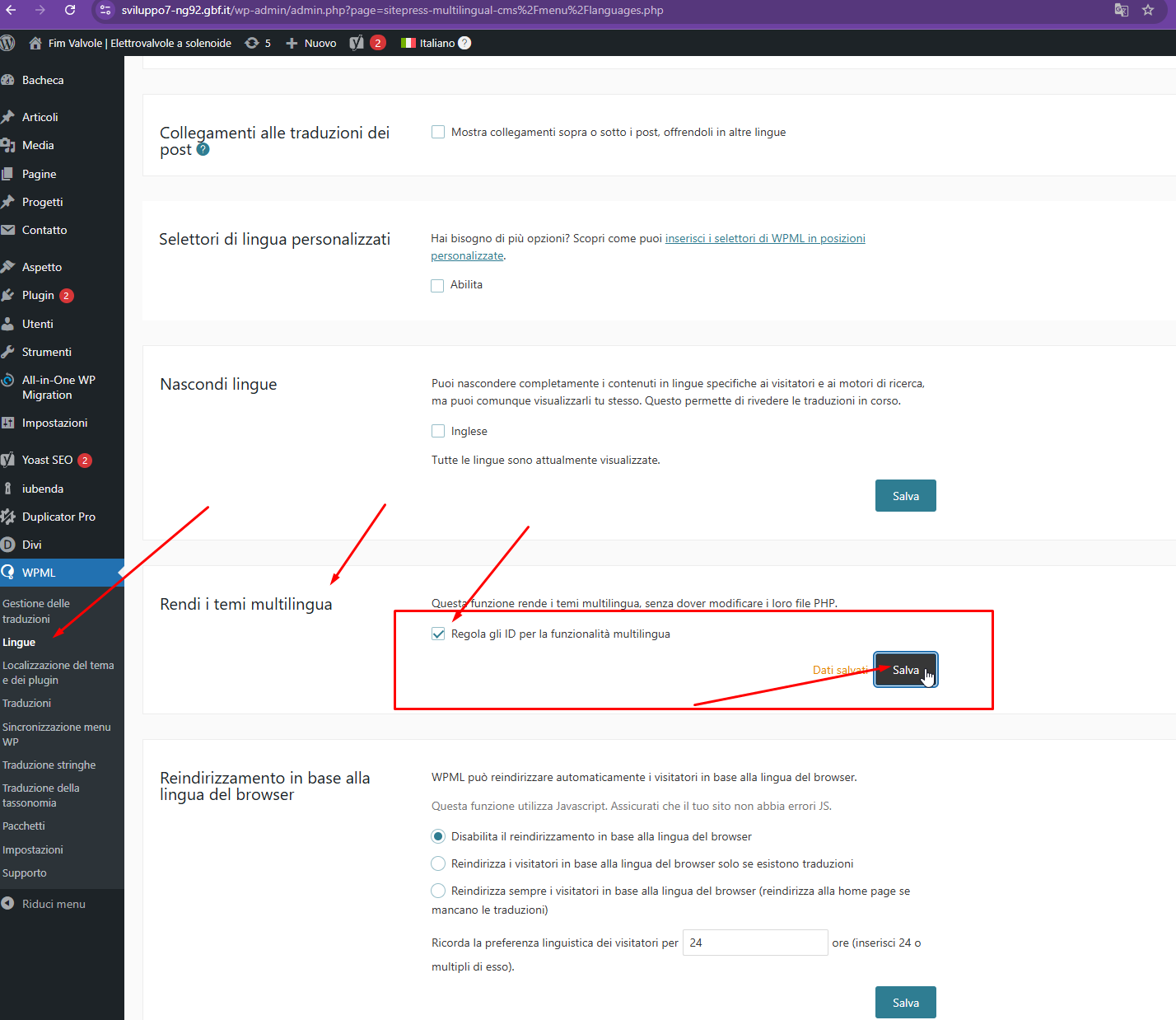

Thanks for your patience. I have some feedback, and kindly enable this "Set IDs for multilingual functionality" option as shown in the screenshot in WPML > Languages > Make themes multilingual to fix the issue. Please let me know how it goes.
July 6, 2025 at 5:52 pm #17205334
mauroG-14
Hello, I changed the settings as suggested and it works.
Thanks very much for your support!
