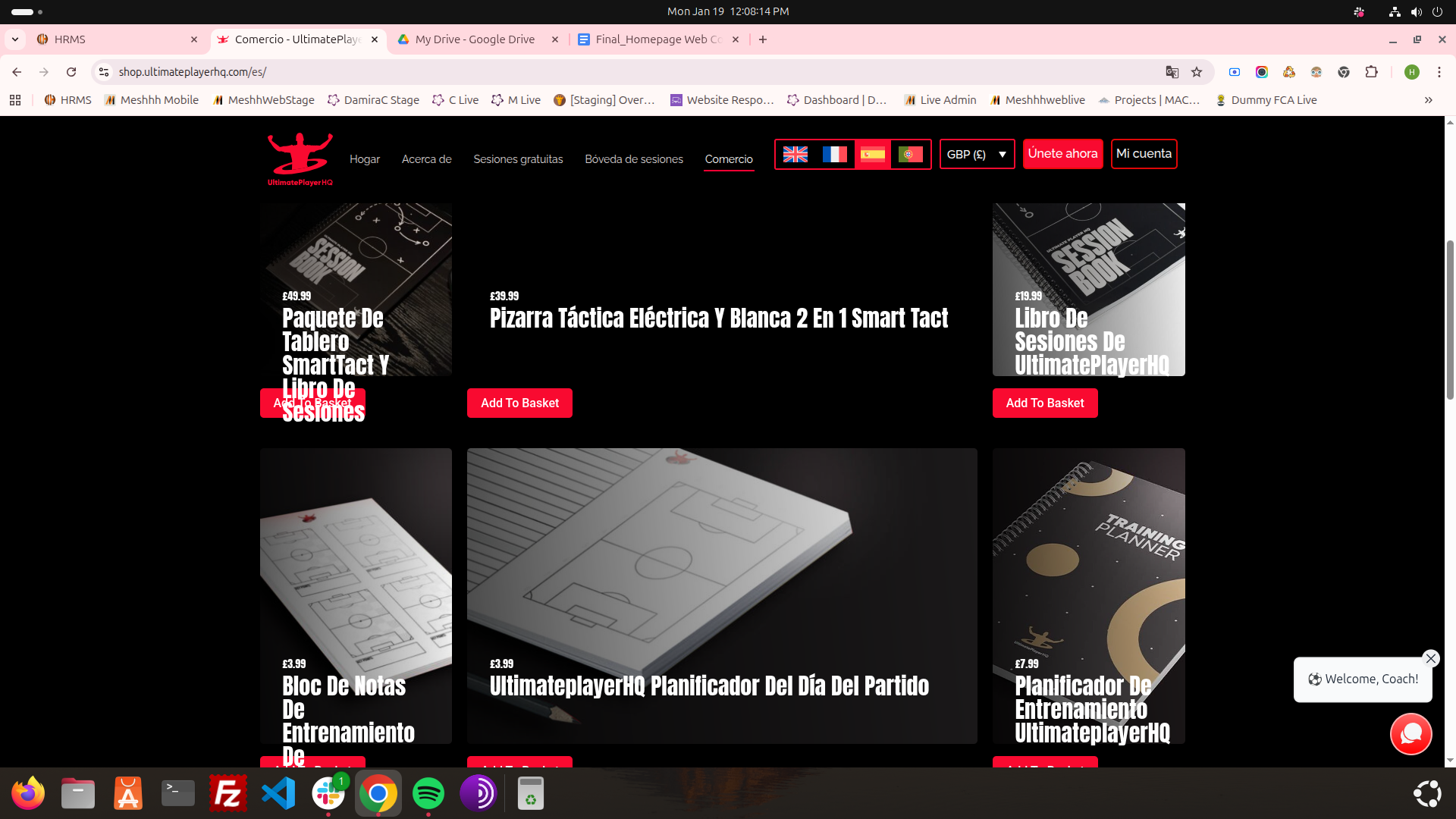

I am facing an issue with media translation. My media files are stored on DigitalOcean Spaces and are saved under this path: hidden link
However, on translated pages (for example, the French version), the site is trying to load media from the following URL instead: hidden link
Previously, this setup was working correctly. I have applied a code fix as a temporary solution; however, I want to understand why this issue is occurring and find a proper solution that does not require a custom code fix.
