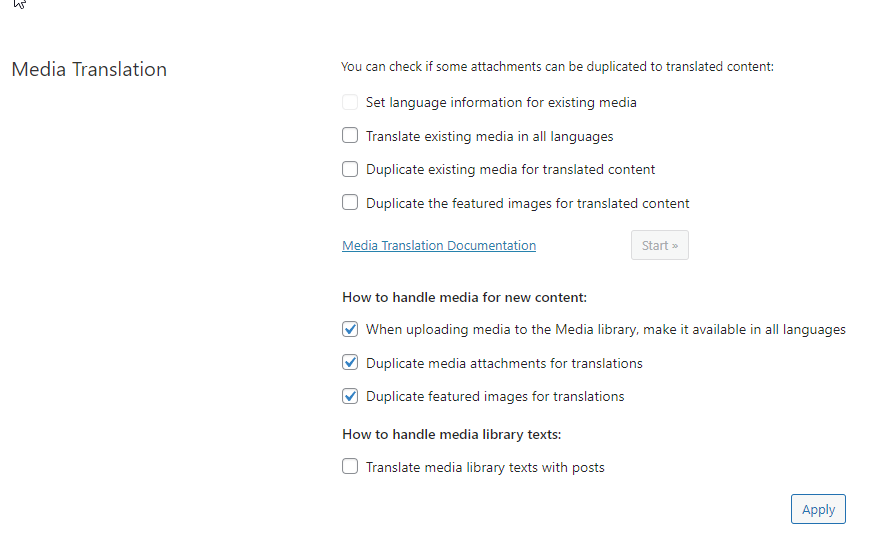

Thank you for contacting WPML support. While you are waiting for one of my colleagues to take this ticket and work on it, let me provide you with first debugging steps or if I can perhaps help with the issue quickly.
The most important thing to answer your question is that the term "duplicate" as it is used here does not refer to duplicating the actual image file. It means that the image meta will be duplicated in the database so that it can be used for the other languages.
The option you have selected in your screenshot means that when you create new content, if you upload media, it will be available for all languages to use. It will not, however, copy any media uploaded to a post to its translation, and it won't copy the featured image to the translation.
The best thing to do to use image from the original language for all other languages is to set all of the fields to duplicate. This creates the entry in the database (not the file on your server) so that it shows for all languages automatically. You will want to check the options to duplicate for translted content and click start to run the sync as well. I hope I have answered your question.

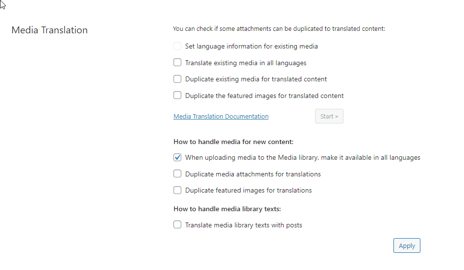

May 2, 2024 at 6:46 pm #15588842
The J
So the options should be like this?
And this wont' physically duplicate anything, but simply add to translations the same image ID for feat image and attachments ID of the main language?
So what happens if I dont select those options, and only leave " When uploading media to the Media library, make it available in all languages"?
If I dont slect those options, then simply if I clone a content, then feat image and attachments will be empty right? But I can still re-attach them from the same media files I uploaded through the main language content? or not...? are there others differences?
Finally, the 2 "duplicate" options above (unchecked) are simply to do the operation I just described above automatically, right?
Can you confirm that NONE of these options duplicate physically the images in the hard disk? but simply re-use the 1 single physical original image, in all translated content?
Final question: why the need to duplicate media entry in db, for translations? cant you use the same id as the main language? it seems like chaotic db management like this and hard to keep track over time... leading to bloated db tables.
May 4, 2024 at 3:20 pm #15593583
None of these options will create duplicated physical files on your server.
WPML only needs to create one entry for each image in each admin language inside the WordPress Media Library.
If you go to the Media Library switch the language inside the top admin bar and review the media count you will be able to verify how much of your media is already available in other languages.
If a media entry does not exist in a different admin language, then the images will not be able to show up on translated content.
The option WPML > Settings > Media Translation > Start will go through the whole media library and create missing language entries. The first checkboxes above this "Start" dialog refers to what WPML should do if you click "Start".
The option in the lower section refers only to how WPML should handle media for newly created content.
The synchronization of media is essential for media to be available on translated content.
Please let me know if you have any further doubts or questions.
