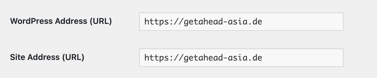

I believe I see the issue.
Your default language (WPML->Languages) is set to English.
With the URL Format "different domain per language" you have correctly set the domain to .de for German, but the English domain is also by default set to .de
If I go to WordPress->Settings->General, I can also confirm the SiteURL and HomeURL in the database are set to the .de domain.
In this case, you would want German to be the default language and English secondary with the .com set as the domain.
Otherwise, you can keep English as the default language but you will need to work with your hosting team to change the URL of your site to the .com one.
Without WPML activated for example your site's URL is .de and not .com.

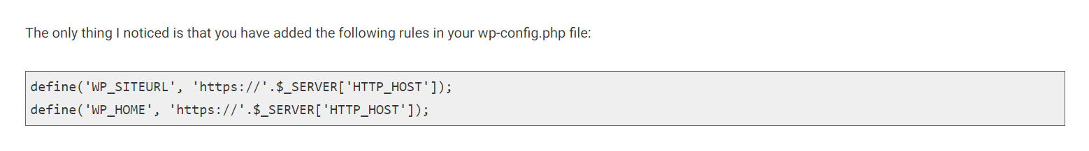

Hello, we have contacted our server host and they came back:
the server and domain settings seem to be correctly set up, the only thing they noticed as odd was the code that set the WP_HOME and WP_SITEURL to 'hidden link'.$_SERVER['HTTP_HOST'])
this was done to override the default behavior of the parked domain, initially the .de would simply redirect to .com, and not stay to show the translations. This code fixed that; but now we are wondering if that could influence the workings of the wpml-plugin
Could that cause the issue?

November 13, 2023 at 9:38 pm #14792555
Bobby
WPML Supporter since 04/2015
Yes, that code in your wp-config.php would cause the issue we are seeing here and has been known to cause issues in the past with other behaviors as well.
If possible, please remove it and ask your hosting company the following:
"When using separate domains: I want to add a parked domain (alias) to my existing domain. My existing domain is “example.com”. I want to park the “example.de” domain."
They should be able to fix this without the need of that code.
See more info here:
https://wpml.org/documentation/getting-started-guide/language-setup/language-url-options/how-to-use-wpml-with-different-domains-per-language/#2-configure-the-dns-settings
November 14, 2023 at 12:09 pm #14797341
joH-4
Thank you for your insight. We will try it out.
Edit:
After removing the code, the site seems to work as expected.
The issue is resolved.
Thank you for your help!
