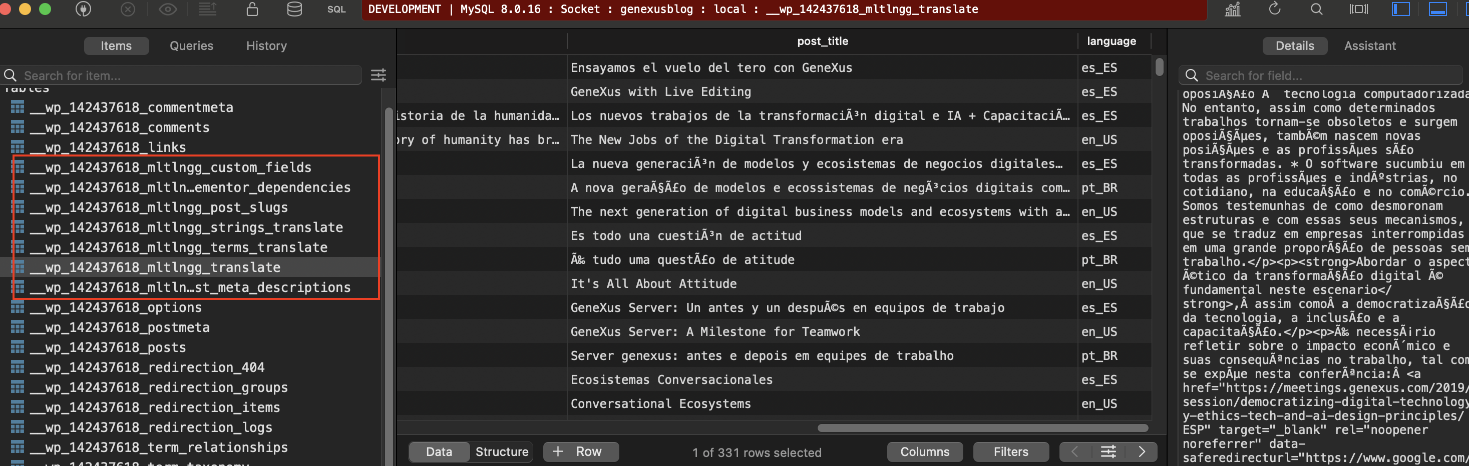

I understand that doing SQL queries might be risky. But I have just checked, and our current translation plugin, saves the translations on its own tables, which is why it is quite unprobable that any export plugin will be able to export the translated posts. In this scenario, I think my only option is to:
1. Import my posts in the default language
2. Install WPML and set the translation languages
3. Then do custom SQL queries to insert the translations the way WPML would do as If I translated the posts manually.
What are your thoughts about this approach?
As I said, our current translations are stored on the plugin tables, so I don't think any export/import plugin would be able to recognize them.

There are some plugins that support exporting data from the custom table and are compatible with WPML so I think you can re-import it to your site in the second language. For example WP Sheet Editor, WP All Export ...
You can follow these links
hidden link (needs a custom code)
If you want to use the SQL queries, I suggest you follow two steps:
- Import posts normally.
- Set the language of the post and relation (original and second language of a post) in the table icl_translations. Refer documentation https://wpml.org/documentation/support/wpml-tables/
If you are not able to accomplish this, I would recommend you contact one of our certified partners who will be more than happy to help you with this. In this link, you will find a list of our certified partners: https://wpml.org/contractors/
