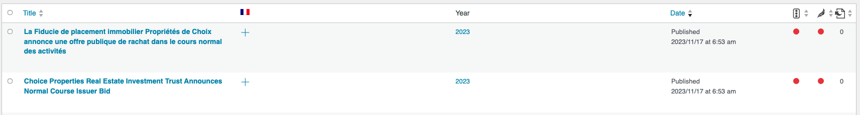

I have an issue on my wordpress with a custom post type that was created, it was created incorrectly and posts where being stored with Block Recovery Validation issues. The solve required to rename the custom post type so everything was consistent.
The issue is we I have 300 posts that will all be affected.
I've updated the custom post type from the name of news_release to news-release. Soon as I do that, I lose the connection between my EN and FR posts. They are both still present in the database (actually the entries are in now doubled in the database). The EN and FR posts are essentially now acting like EN posts. I need to make this update and ensure I'm not losing the relationship netween the EN and FR posts for the custom post type.

I noticed the posts are doubled after updating the settings to include the custom post type news_release
How can I possibly solve this issue?

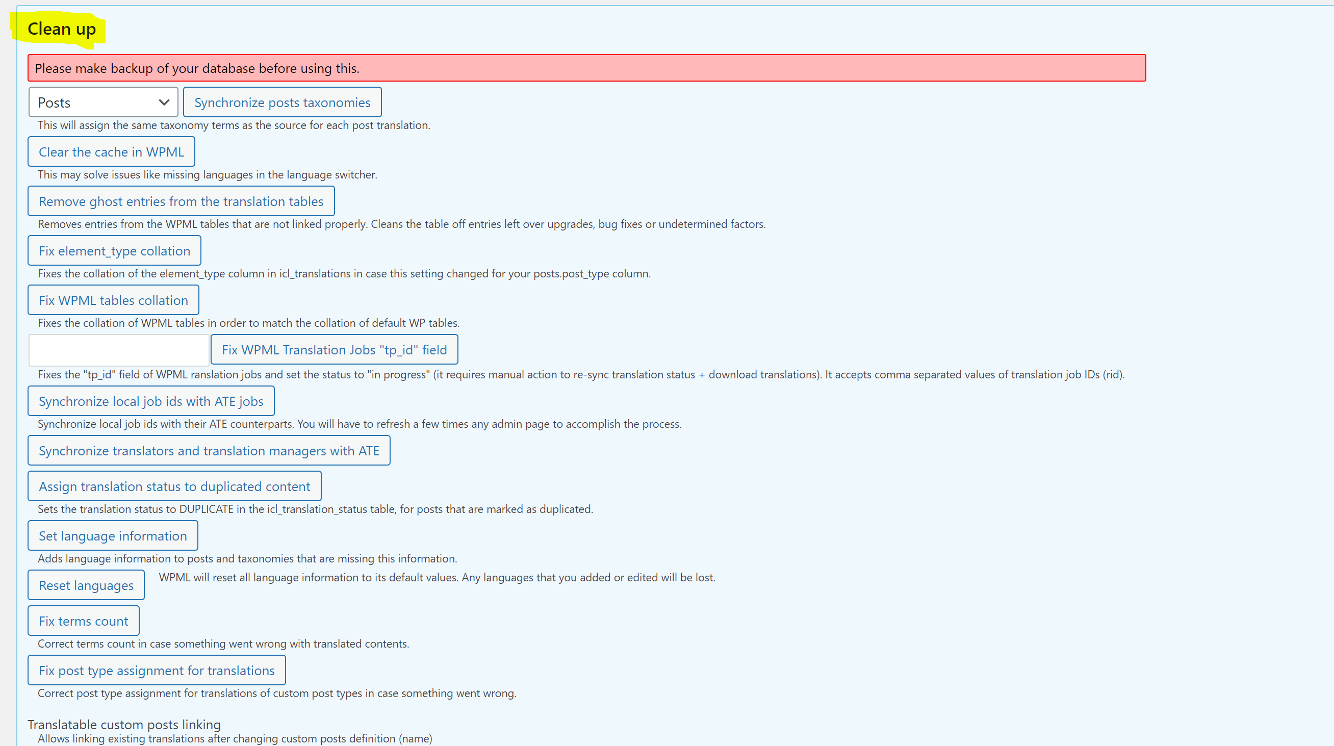

2) In WPML > Support > Troubeshooting, you'll find a section "cleanup", all the options in that page can be clicked to try to have the database link the content correctly.
at the same time, in that page, you'll find a section with a white box where you can see all the post types and their connection to the slug. can you check if the CPT that is creating issues on your site, is there and appears linked to something or if instead it allows you to do it yourself?
Only try this after a site backup so you have a checkpoint in case something goes wrong (nothing should, though, the steps i gave you are quite harmless).
Let me know what happens there so we can understand how to continue.

I could not locate the clean up section, when looking under support > troubleshooting, can you provide a screen grab.

I attached a screenshot of the section. Please create a complete backup of your site and database and try at least the following options:
- Clear the Cache in WPML
- Fix element_type collation
- Fix WPML table collation
- Set language information
More information about the options, you can find here: https://wpml.org/documentation/support/wpml-troubleshooting-options/.
