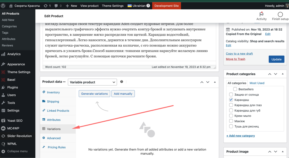

I duplicate a product with variations. Open the duplicated product to check. See all contents successfully copied except the variation section which is totally empty - no variation products in the list which I can see in the original product. The obvious solution to solve it - add new variations manually by generating new ones based on the selected attribute of the original product but this should not be the case. Why are variations not copied from the original product?
I followed the recommendations described here as similar issues
no sure

However, I've checked and found that the WooCommerce Multilingual plugin is not Installed on your site. To translate WooCommerce Products and their variations effectively, it's essential to have the WooCommerce Multilingual Plugin.
Please check this link for more information: https://wpml.org/documentation/related-projects/woocommerce-multilingual/
You can Install and Activate the plugin from the "Plugins > Add new > Commercial" tab.
Once the plugin is activated and the setup is completed, please try the following:
- Delete the existing duplicated product
- Open the default Product in Editor and make a small change
- Save the changes and then try to translate the product again
Please let me know how it goes. I will be happy to help if you need further assistance in this matter.

I understand your request, however, what you're asking for is not possible. WooCommerce variations are stored in a non-public custom post type called 'Product_variation'. The functionality to retrieve posts from this post type and include them correctly in the variations section of the translated product is exclusively a feature of the 'WooCommerce Multilingual' plugin. Therefore, even if you duplicate the products, the variations will not be duplicated without using the WooCommerce Multilingual plugin.
This plugin is not just for adding functionality to translate WooCommerce products accurately, but also because it manages various settings within WooCommerce. The WooCommerce Multilingual plugin ensures these settings function effectively in a multilingual setup.
I hope you can understand the matter. If you want variations in your translated products, then you must need to activate the WooCommerce Multilingual plugin, otherwise, you have to manually create the Variations for the translated product.

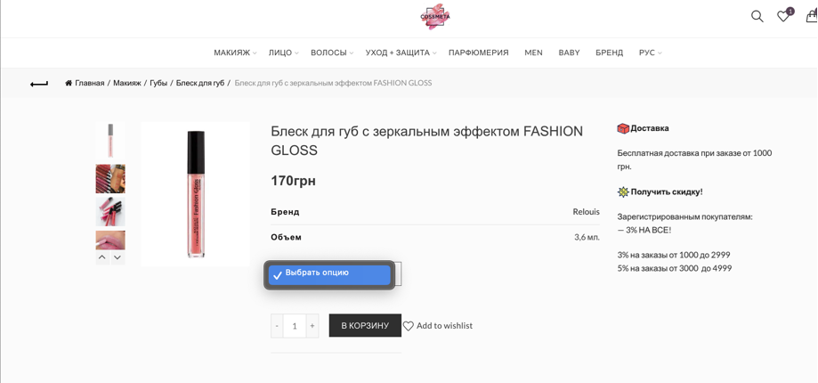

I duplicate a product with variations to another language. The duplicated products display all product variations in the dropdown but the original product variations in the dropdown somehow dont show up at all. Can you investigate and provide a solution please?
Original product: hidden link
Duplicated from original: hidden link
