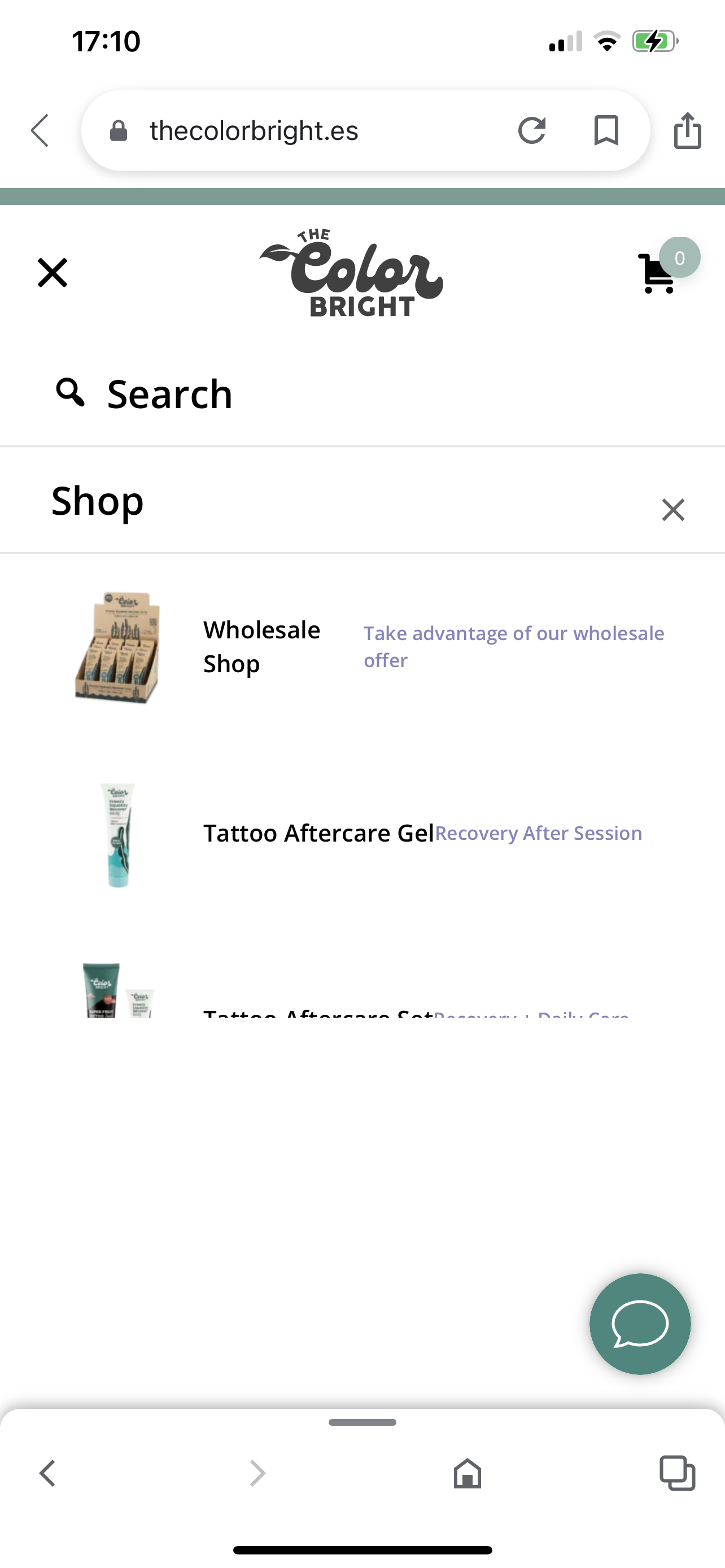

tomaszS-57
Hi Kor, thank you but unfortunately, now the menu gets cut in weird place. It doesn't show full but on half of the screen and you don't even see the rest of the menu options unless you scroll down (which not everyone is going to figure out because even I had a problem to find the rest of the menu). Also menu items when opened are cut in a weird spot and you need to scroll even though there is a lot of free space on the screen. Please see the attachment

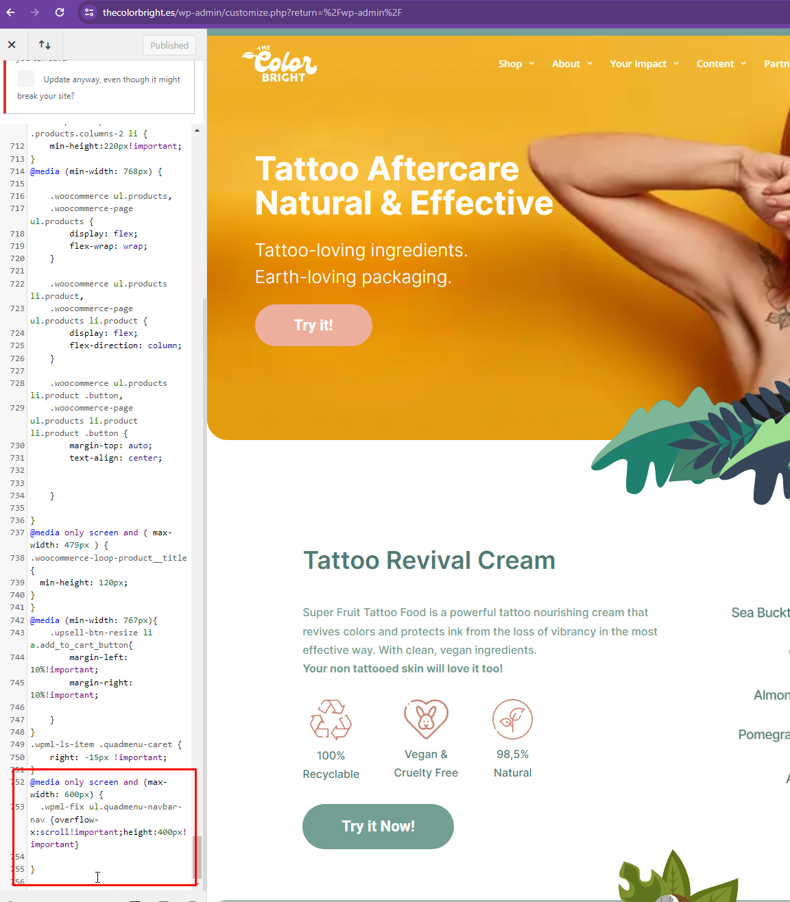

Thank you for getting back to me.
You can remove the custom CSS code displayed in the attached screenshot via WP > Appearance > Customize > Additional CSS and it will revert the changes.
Regarding the menu, as it's created using the "Quadmenu" plugin, I recommend reaching out to the plugin author to explore potential solutions. It appears that the plugin may not be optimized for mobile devices and could benefit from improvement.

@media only screen and (max-width: 600px) {
  .wpml-fix ul.quadmenu-navbar-nav {overflow-x:scroll!important;height:800px!important}

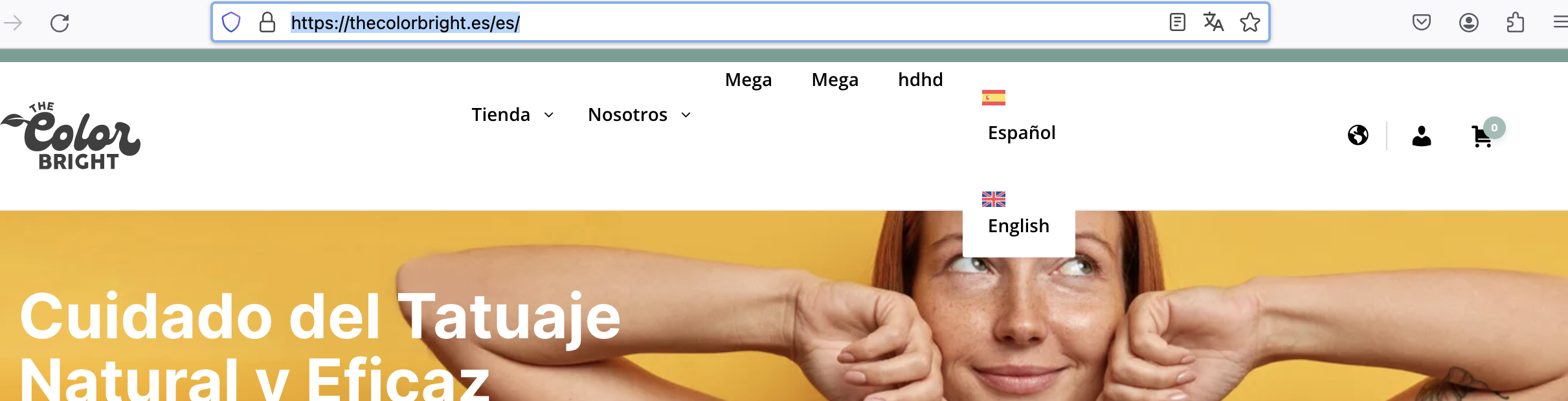

tomaszS-57
Brilliant, thank you. I just run into another issue. I was translating my menu and everything was going ok until one moment something happened and my menu stopped working properly in the translated language. You can see here hidden link it is working ok but when you change to spanish this is what happens; hidden link the language switcher is all over the place and only ''tienda'' and ''nosotros work ok'' everything else started to show without dropdown, higher, bold. No idea what happened. I deleted those menu items and troed to add again but the same keeps happening in the spanish version. The first two seem to act normal. Any idea how to fix this?

Thanks for your reply.
It looks like the Quad Menu is breaking the WPML Language switcher. We apologize for the inconvenience, but in order to proceed with troubleshooting, we kindly request a site snapshot. Alternatively, with your permission, we can create a snapshot on our own.
