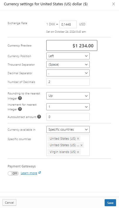

I am trying to implement rounding for different currencies on my site hidden link using WPML. I am following the documentation at https://wpml.org/documentation/related-projects/woocommerce-multilingual/multi-currency-support-woocommerce/#setting-currency-options-and-rounding-rules.
I have tried different options, but it does not change anything.
Multicurrency rounding does not work.
How can I fix that?

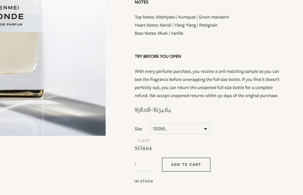

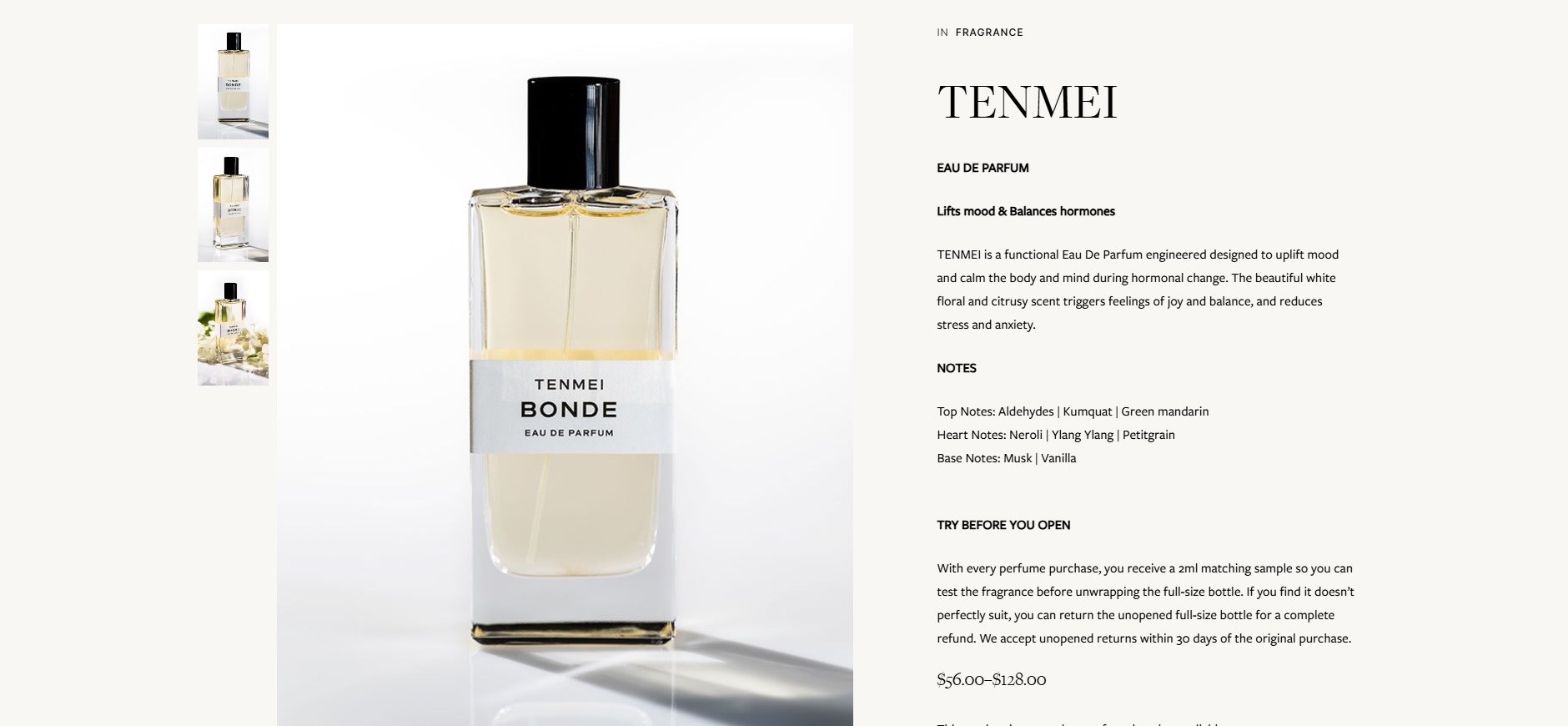

I’ve imported your site to our staging environment, and the rounding issue does not occur there. Here are a few examples where the rounding works correctly:
However, on your live site, the same products still exhibit the issue:
It seems likely that this issue is related to either a hosting-specific configuration or caching, such as object caching (e.g., Redis). Could you please check if your site is using any object cache and clear it to see if that resolves the issue? You may also want to contact your hosting provider to review and clear the cache on their end.

After performing those actions in the staging/testing site the prices seem to be rounding up accordingly now, please check the screenshot.
