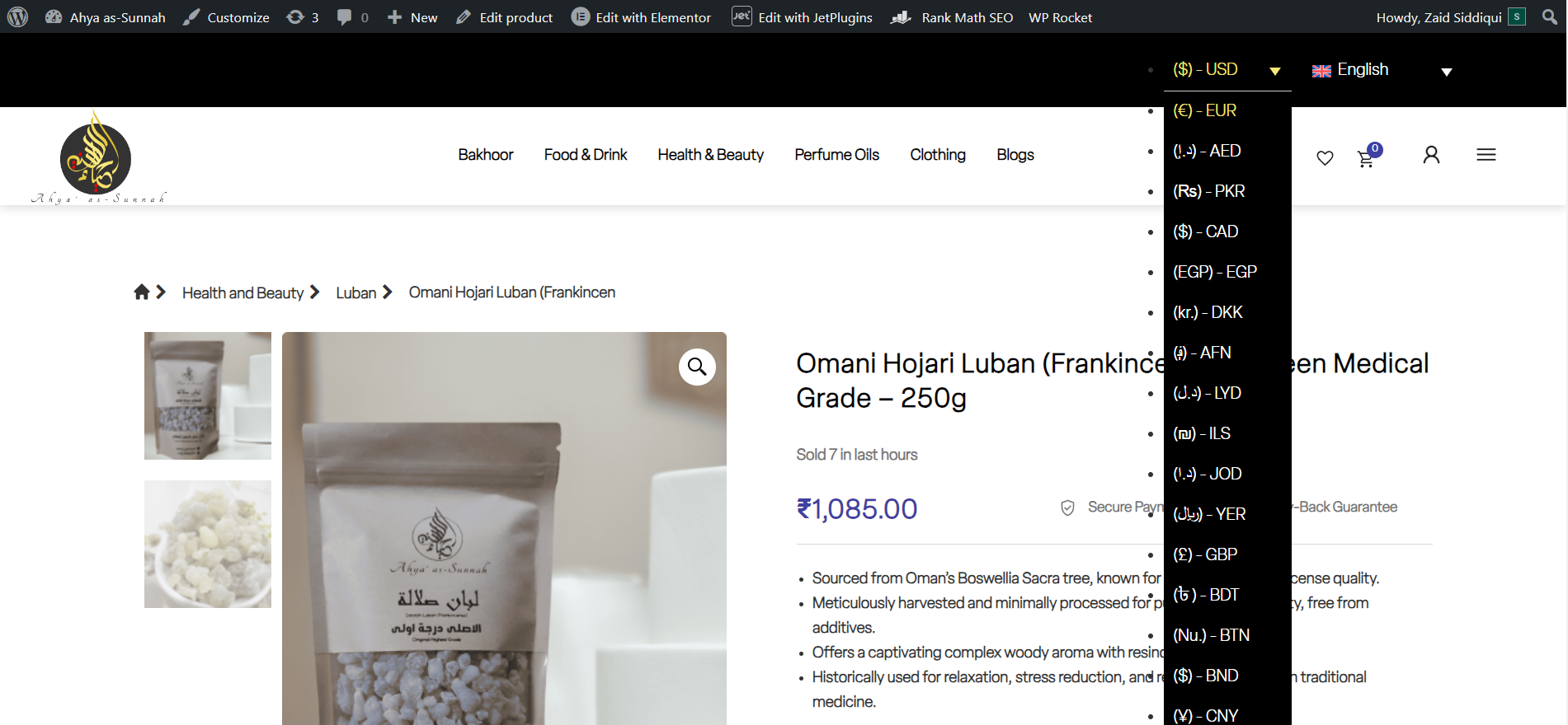

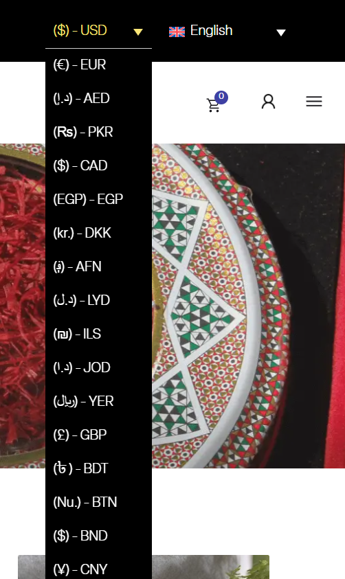

I am facing and UI issue in multicurrency switcher on single product page in multicurrency switcher I can see bullet points which is spoiling the UI I don't know where they came from as this issue is only specific in single product page pls check screentshot.

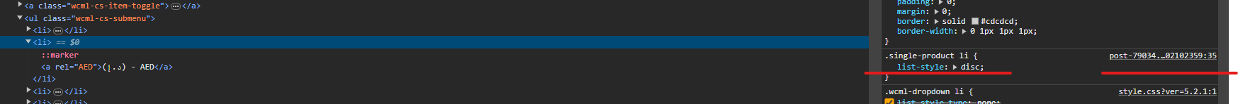

I was able to check and it seems that there is a CSS property set that is causing that UI issue (check image attached):
.single-product li {
    list-style: disc;
If you change the code to the one below it fixes the issue:
    list-style: none;
* IMPORTANT: Please before you make any change to the website CSS code, make sure that the code I mentioned doesn't affect any other part of your website
Also, the code I provided is just to put you on the right direction on solving your issue as you might require custom coding which is beyond the scope of this support forum, we recommend that you check our contractors' page: https://wpml.org/contractors/.

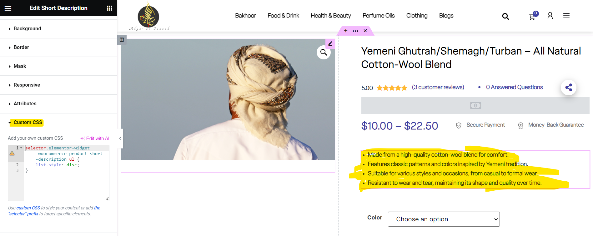

Yes, I used custom css for product short description widget but I selected proper class for that than why this causing issue for multicurrency switcher

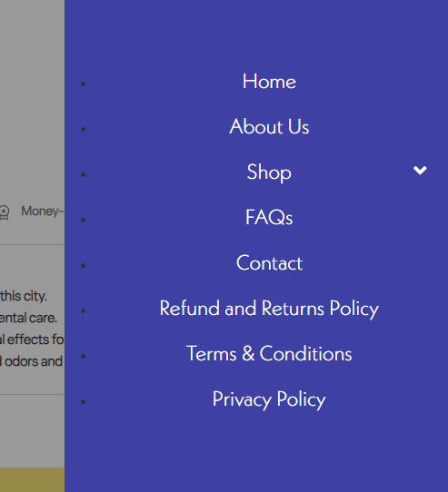

I am not sure why that code is targeting all li elements on the product page (as you see on the attached image it is affecting the website menu as well).
Try adding:
list-style:none;
to the following CSS code (as show in the attached image):
.product.wcml-dropdown, .product.wcml-dropdown li, .product.wcml-dropdown li li {
    border-color: #000000;
Please understand that custom coding work is out of the scope of this forum.
* I'd suggest to try adding the custom CSS code you are adding on the Elementor space directly on the styles.css file of your theme and see if it makes any difference, maybe that helps out.

ok I added the code given by you I think problem is solved now

I checked: hidden link and on my end the currency switcher has no bullets anymore.

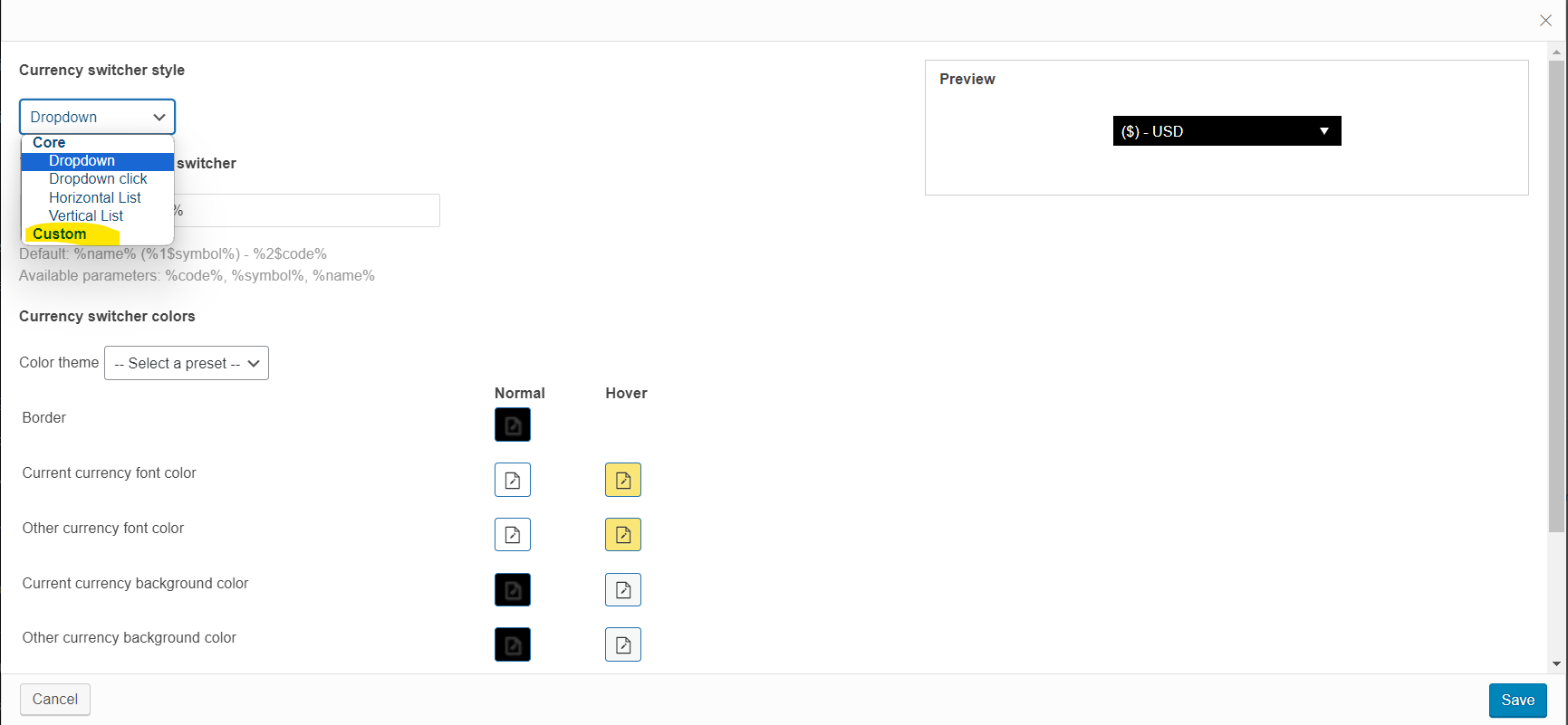

In Multicurrency switcher setting I found custom style I doubt what is this and how I am able to edit this and upload custom layout of switcher.
December 13, 2023 at 2:23 pm #15055979
Marsel Nikolli
That option is related to custom currency switchers, you can check the documentation related to all the options on the link:
https://wpml.org/documentation/related-projects/woocommerce-multilingual/multi-currency-support-woocommerce/?utm_source=plugin&utm_medium=gui&utm_campaign=wcml#adding-a-currency-switcher-to-the-front-end

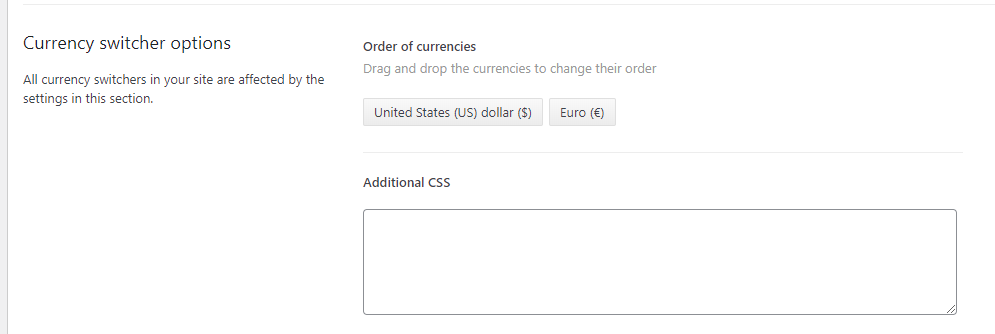

* Note: Additional CSS style customization to the currency switchers can be added on:
- go to WP admin -> WCML -> Multicurrency -> Currency switcher options section
You can add custom CSS code in the box "Additional CSS" (check image attached).
All currency switchers in your site will be affected by the settings in this section.
