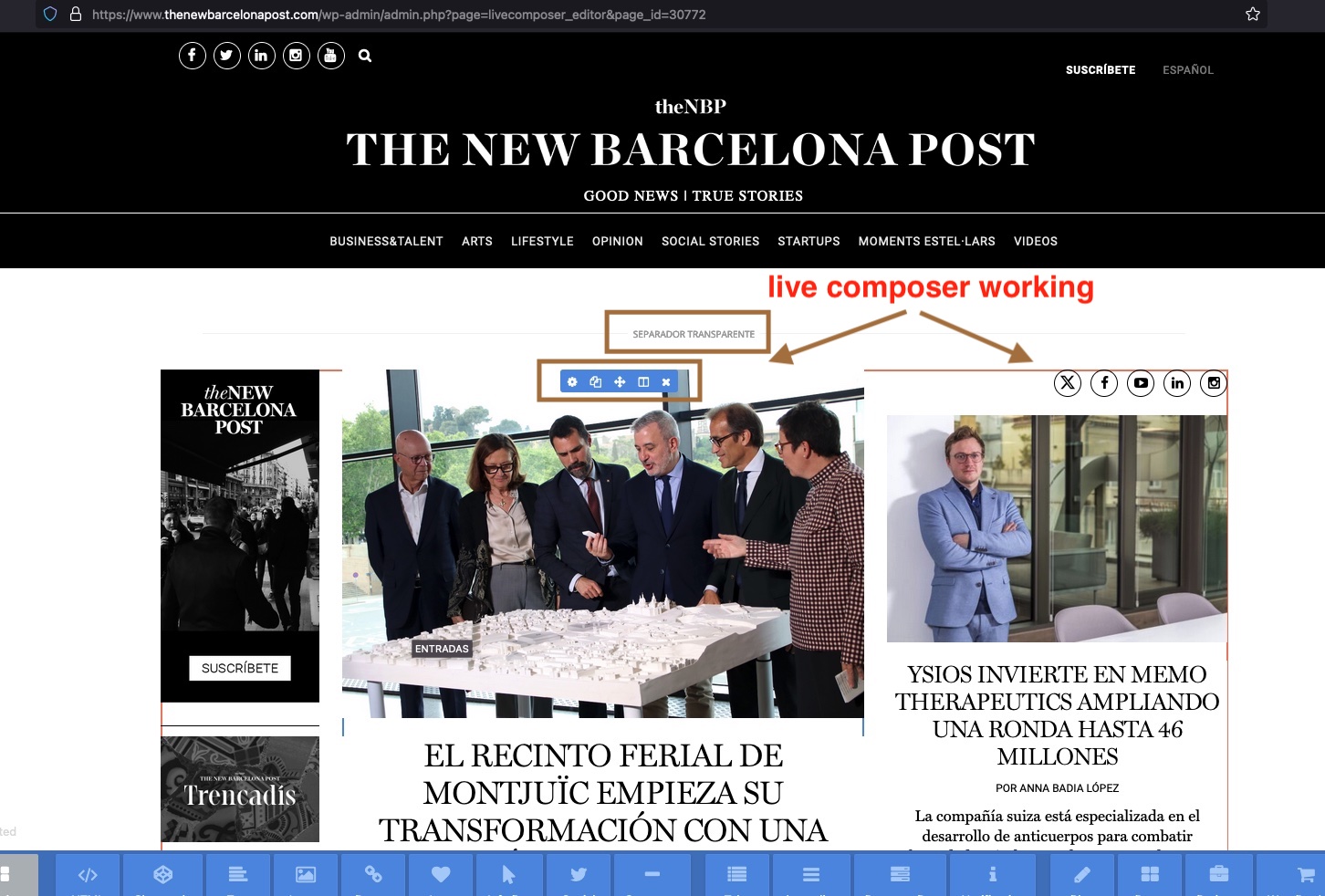

The change apparently worked fine, but there is one issue with Live Composer plugin that I can not solve.

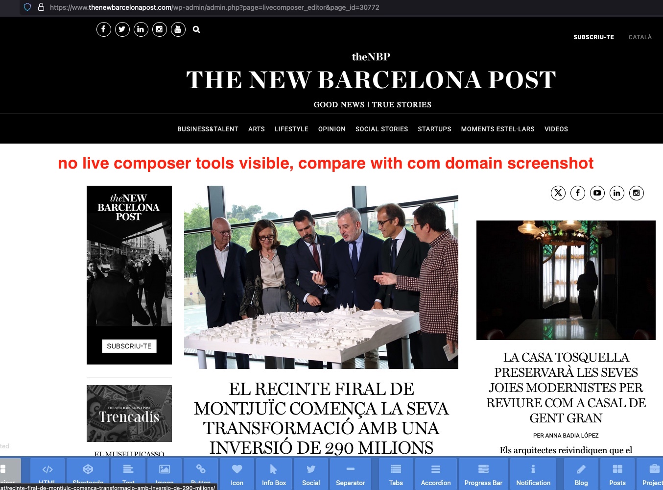

So, the problem here is that when I open this Live Composer to edit a page using the .cat domain, the tool is not loaded (If I'm not wrong it works opening an iframe, or something similar), but when I open it using the main domain (.com) it works well.

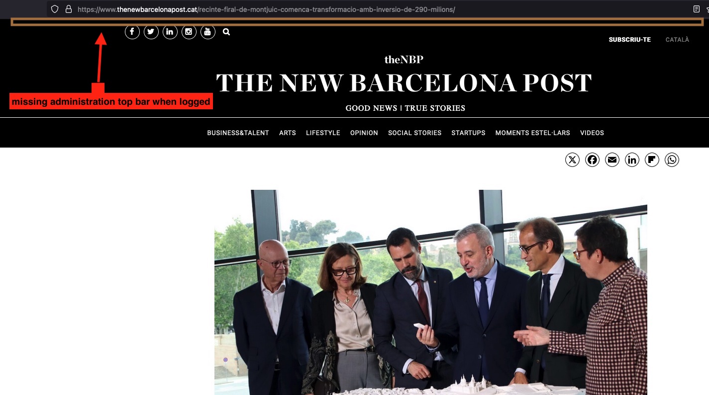

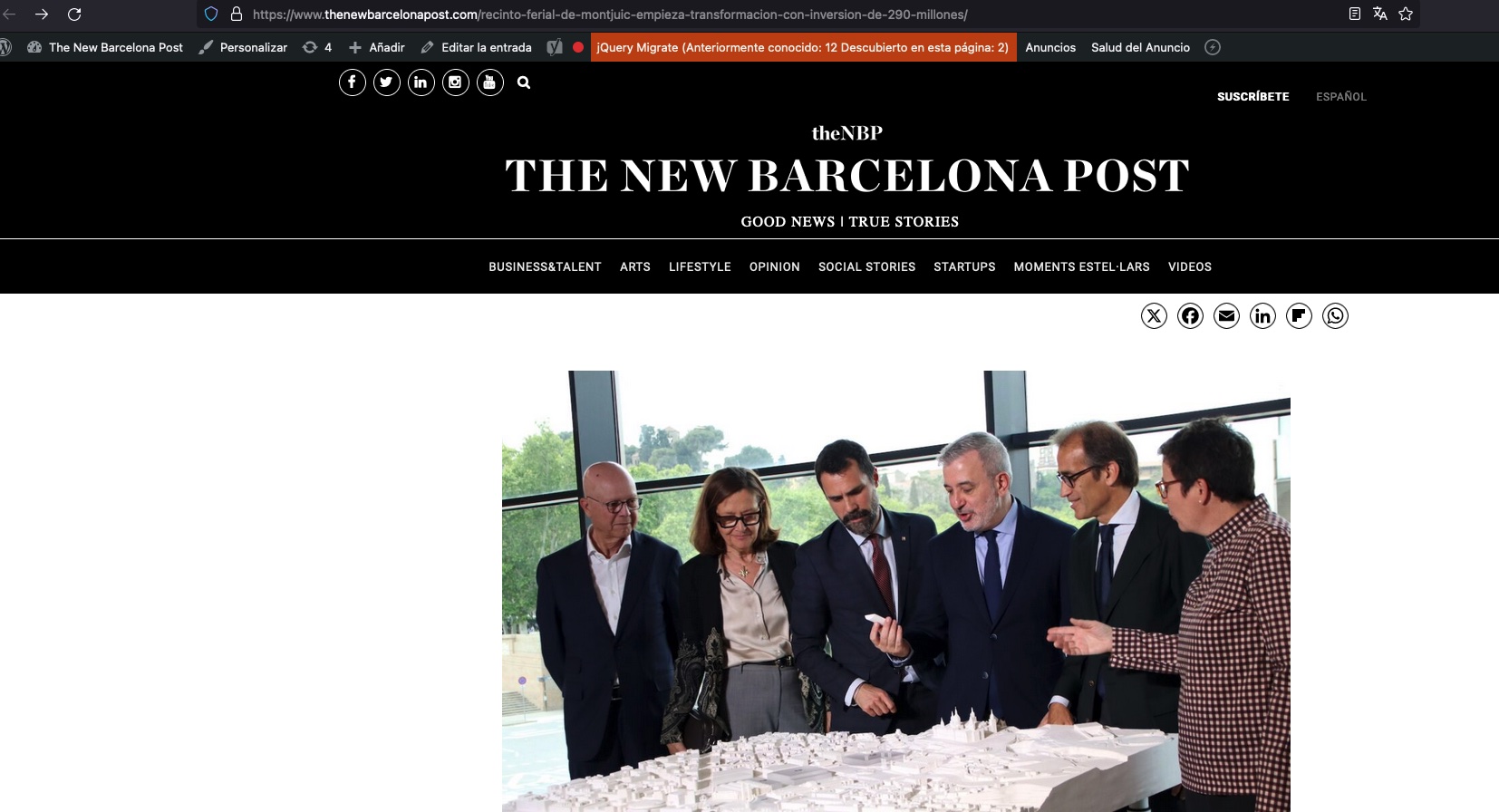

Also, the wordpress administration top bar is not appearing on .cat domain.
