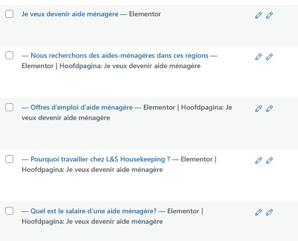

This is a page:
The translation for the URL slug of your CPT was also "devenir-aide-menagere".
This creates a conflict. The same slug can only be used once.
