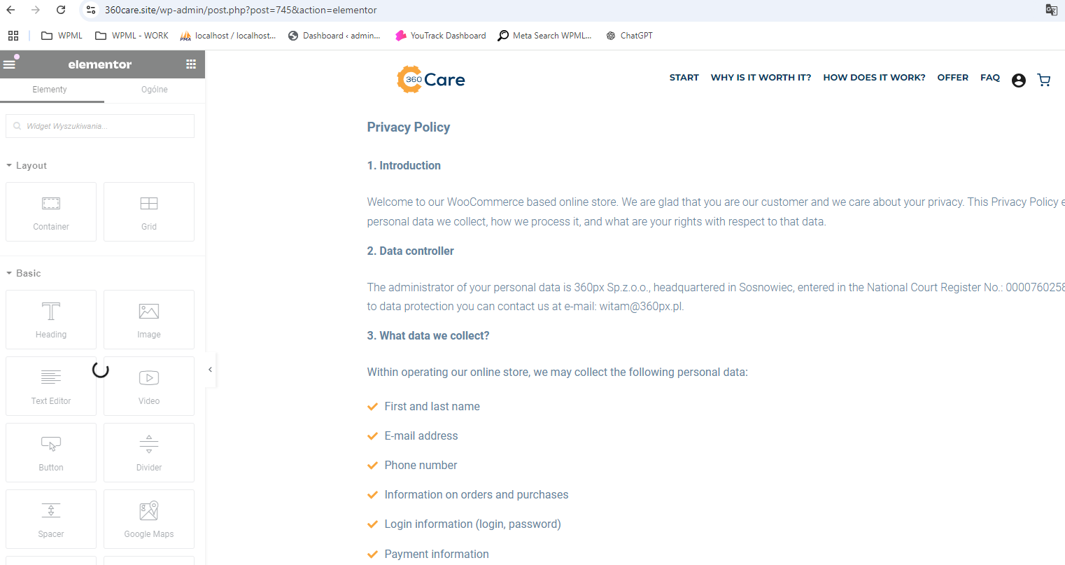

I have a multisite with two domains: 360px.pl and 360care.pl. In the second domain 360care.pl, I have WPML with separate domains (360px.pl and 360care.site). I want to edit the page hidden link. I have a sunrise.php file like in your documentation.
When I try to edit the page hidden link, the system forces a login page. After logging in, the system redirects me to 360care.pl.
Why does the system force a login page when I try to edit hidden link?
Why am I redirected to 360care.pl after logging in?

Now I can't edit site using elementor.

This time when I try to edit elementor, system redirects me to the Homepage of 360px.agency. Link to edit this page has hidden link domain, so that's correct.

We found that the issue may be "Automatycznie loguj i wyloguj użytkowników we wszystkich domenach " option which was not enabled on hidden link.
You may need to login once again when trying to open editing of this page, but it should work.
October 24, 2024 at 7:09 am #16324451
dominikC-4
I've checked this option and works fine. Thanks a lot!
