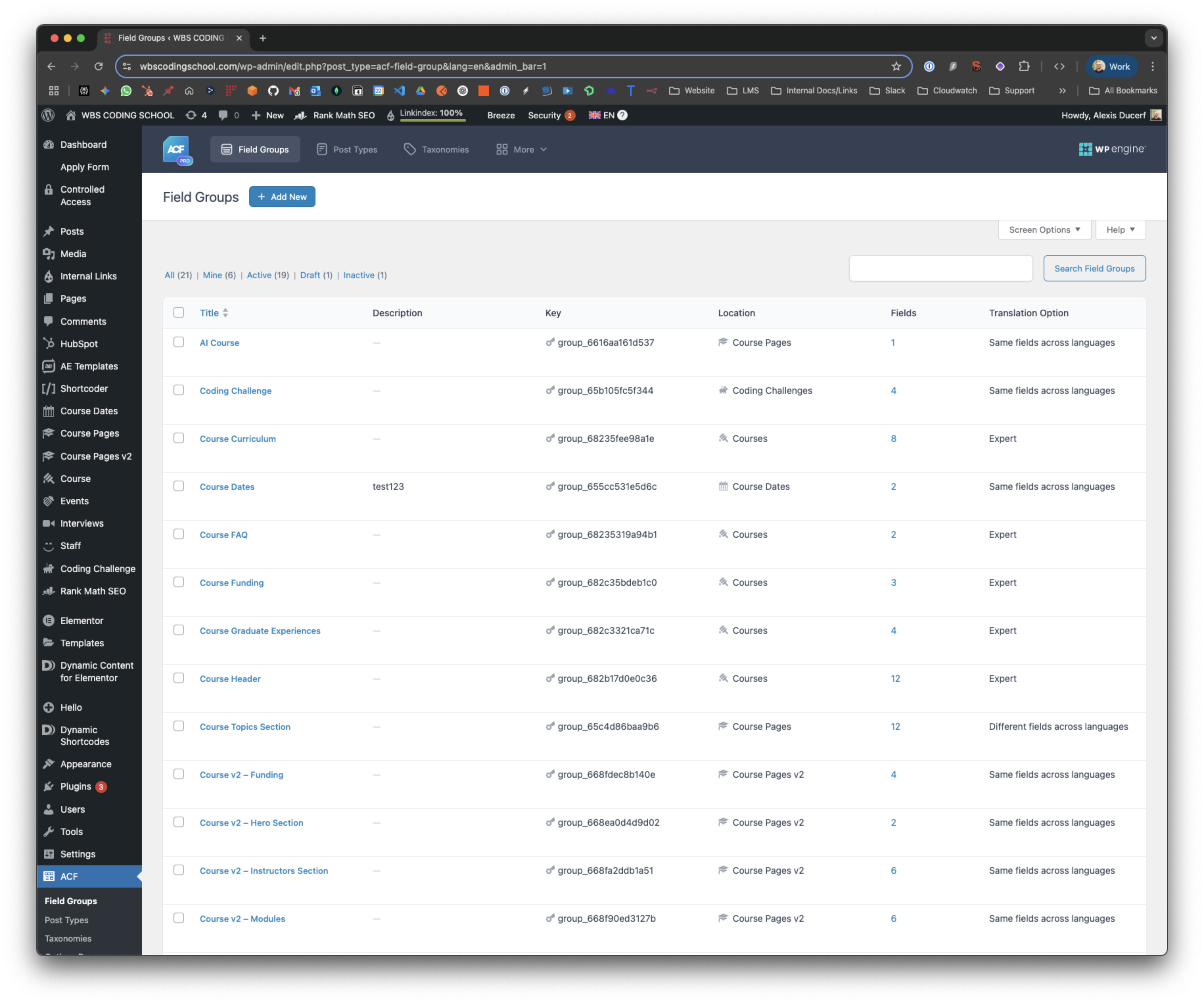

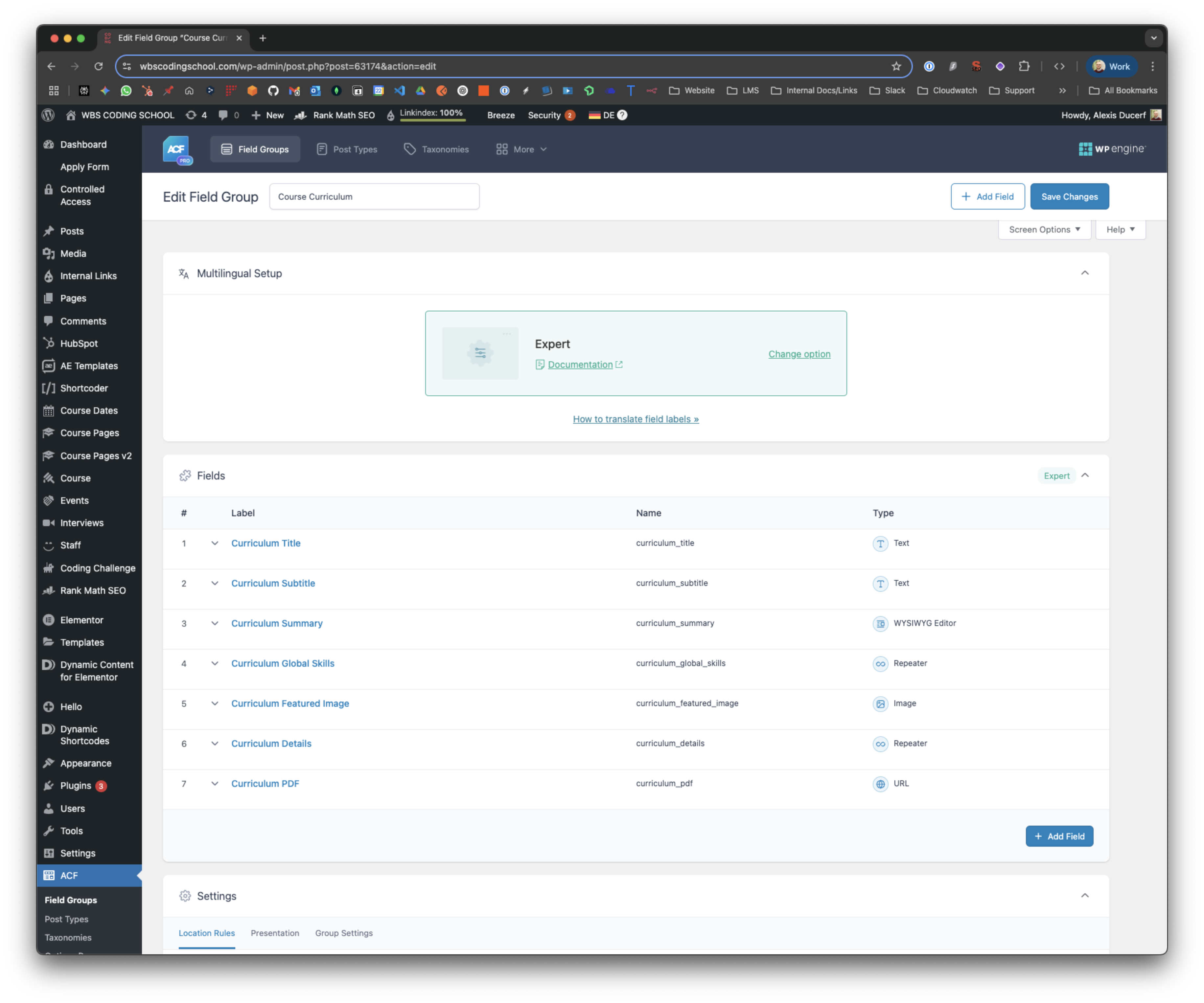

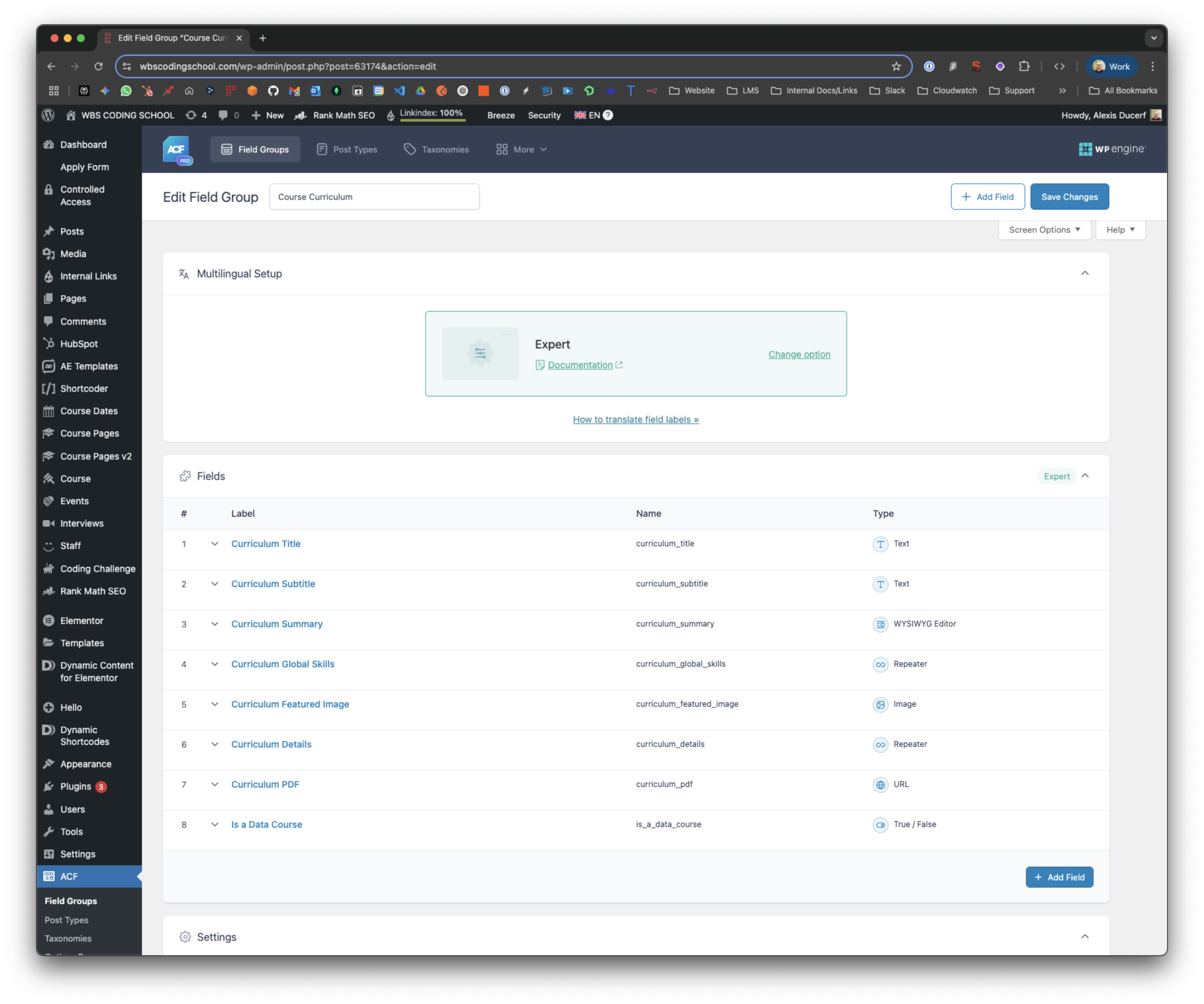

I'm trying to have the same number of ACF fields between English and German on my WordPress site. I'm using ACF Pro in expert mode and have set the fields to be translated. The issue can be seen here: hidden link
The ACF fields aren't synchronized between the two languages. I expected to see the same number of fields between English and German, but instead, I got a different number of elements between the two languages.
Why aren't my ACF fields synchronized between English and German?
How can I ensure the same number of ACF fields appear in both languages?

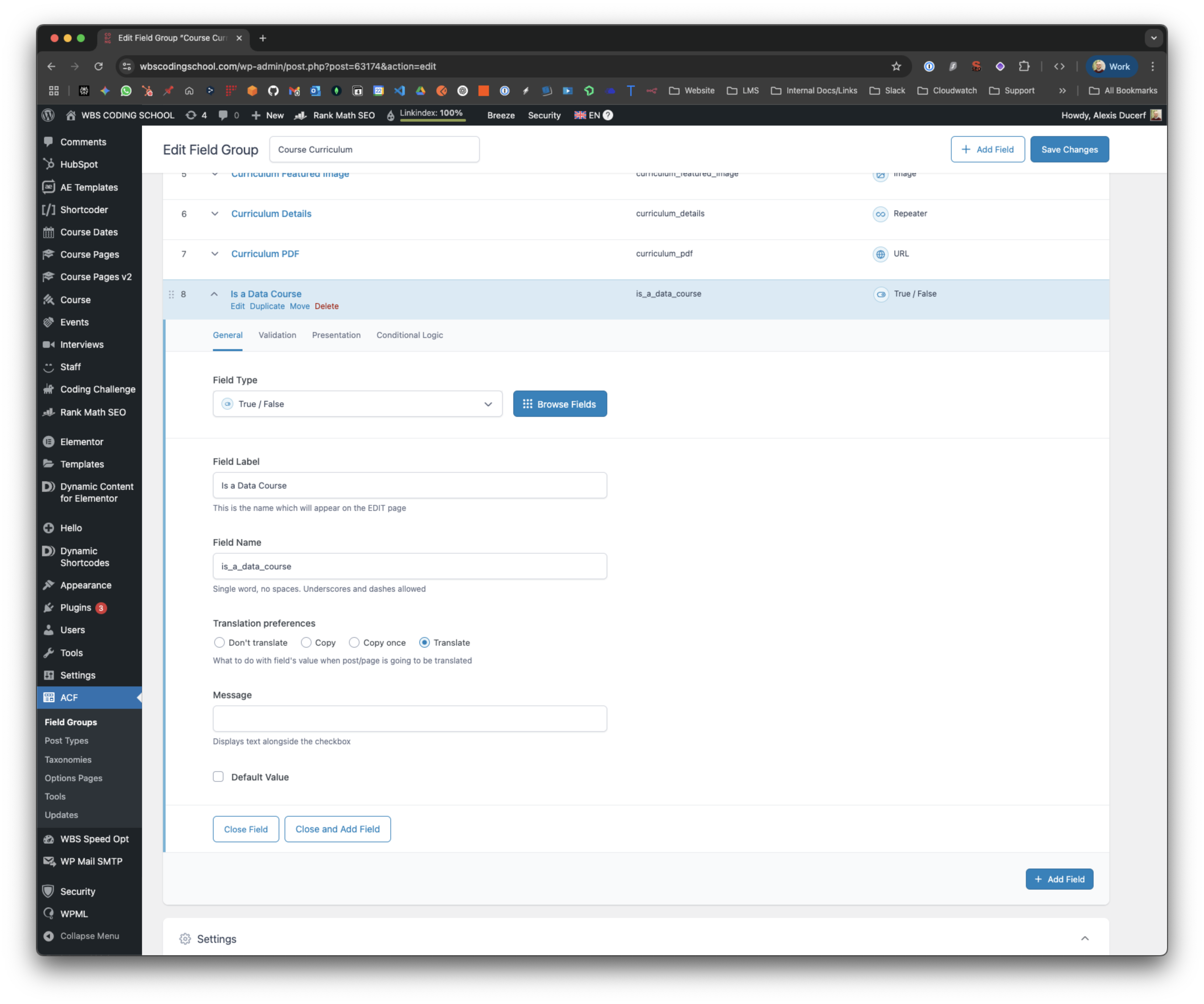

My issue is that if I use the "Same on all languages" some fields are blocked and I can't translate them, so someone from a previous support told me to switch to the expert mode back then.
One field that isn't synchronized is a boolean, so according to the doc, it should be with the "Copy" option, but after switching it to "Copy", it is still not visible in German.
Even if I switch back from "Expert" to "Same fields across languages" I keep having a different number of fields between English and German.
It's like they are completely out of sync, how could I solve that?

My issue is that the fields aren't visible at all in the German version, but I actually found a way to force the synchronization between languages. I exported the Post Type and Group Fields via the ACF tool, removed them, reimported them and now they are the same in both English and German.
Thanks a lot for your help
