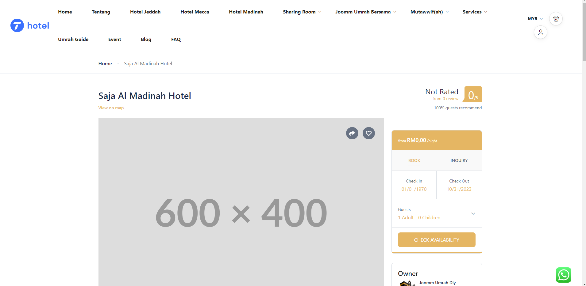

I'm dealing with another issue right now...
This is my website, I created with ShineTheme, they said they help and support for WPML integration, and WPML is compatible with their theme, they even have a documentation for WPML integration, but when I follow the step and everything to change the languages, the languages changed successfully, but when I switch to other languages, my custom header, my setting, my price, picture, alot of thing all disappear, you can check it above the link I place.
We spent months to upload all the data... but now we need to re-upload again for every languages switched ?... I try to contact their support, but seems useless...very bad experience with their support... I really need help with this... can you please help me...?

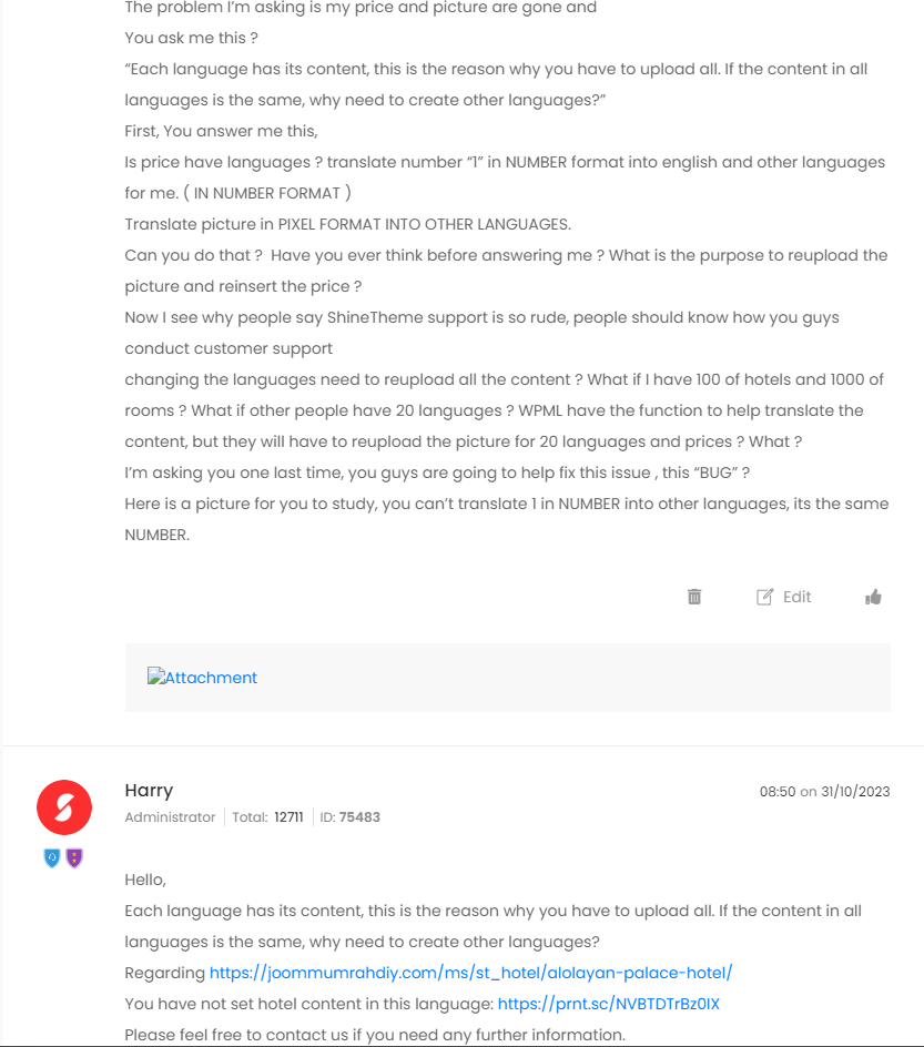

October 31, 2023 at 2:15 am #14696133
meng-hanT
Can you see how they conduct their support... So rude... Please help...
