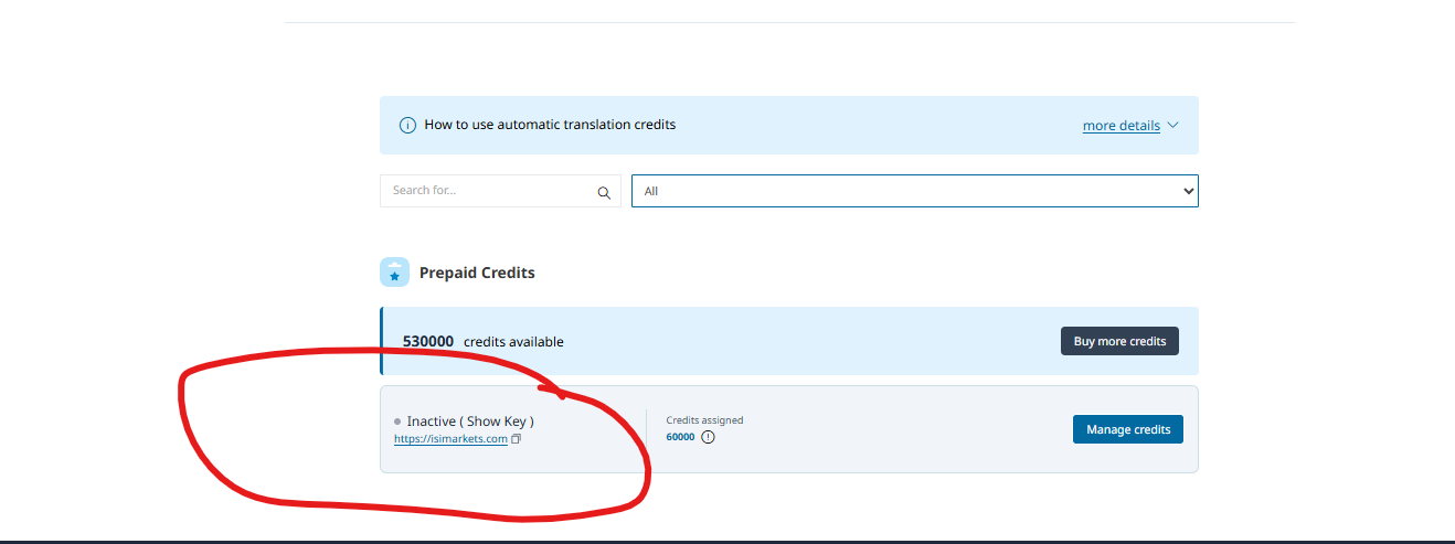

I am not able to do translation on the website, most likely because the status is showing as inactive. Please help

In the account, it i showing that isimarkets.com s in active.
In WordPress, I'm also not able to apply credit

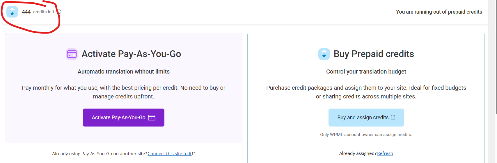

You have 530,000 credits in the wpml.org account.
In the site there are 444 credits left.
and the site key has 60,000 credits assigned.
From my side I am not able to control these credits as they are assigned to your actual account, if possible, please click on "manage credits" -> what are the options you see, are you able to move them?

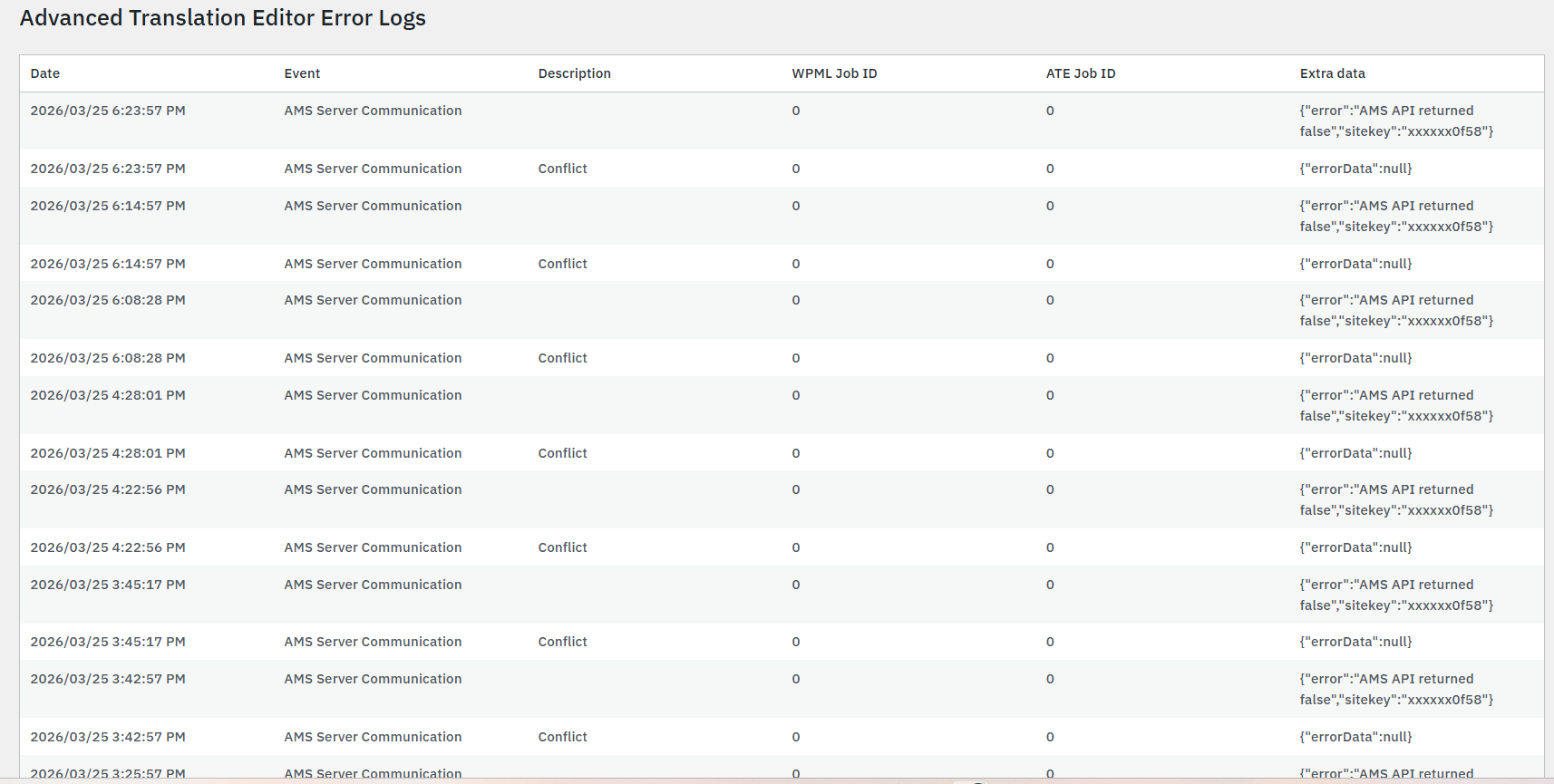

1. I found these error logs (Attached)

The site is showing the URL registered for this ID as hidden link
However, on your screenshot the one that shows the inactive key is isimarkets.com
