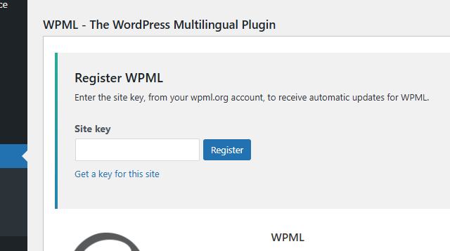

1. Ask them to go to `wp-admin/plugin-install.php?tab=commercial` and click **"Unregister WPML from this site."**
2. Log in to your WPML account and register the key for `hidden link`.
3. Ask them to click **"Register WPML"** and enter the new key.
