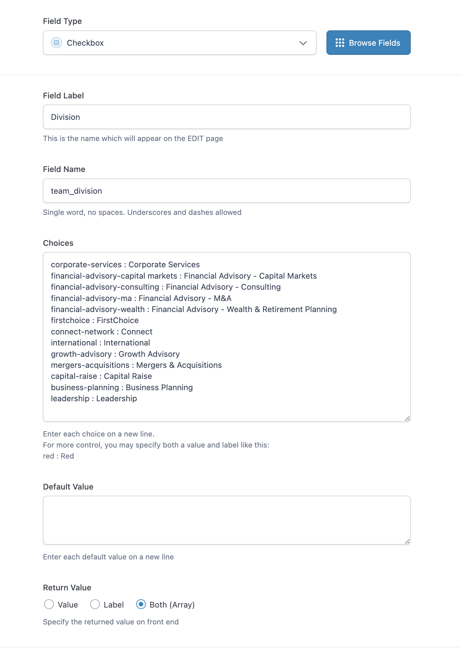

At the bottom of this page, there is an unordered list under "Divisions":
This data is coming from an ACF Checkbox field with multiple choices (see attachment). I need the Return Value for this field to remain "Both (Array)" because is use both pieces of information in the front end templating.
I want to translate the Label portion and I've done some work on this, but it doesn't appear to be returning the translated labels on the front end.

1. Admin > WPML > Settings > Custom Fields Translation section: I've set the "team_division" custom field to "Translate". (NOTE: I did this for both the main and child site.)

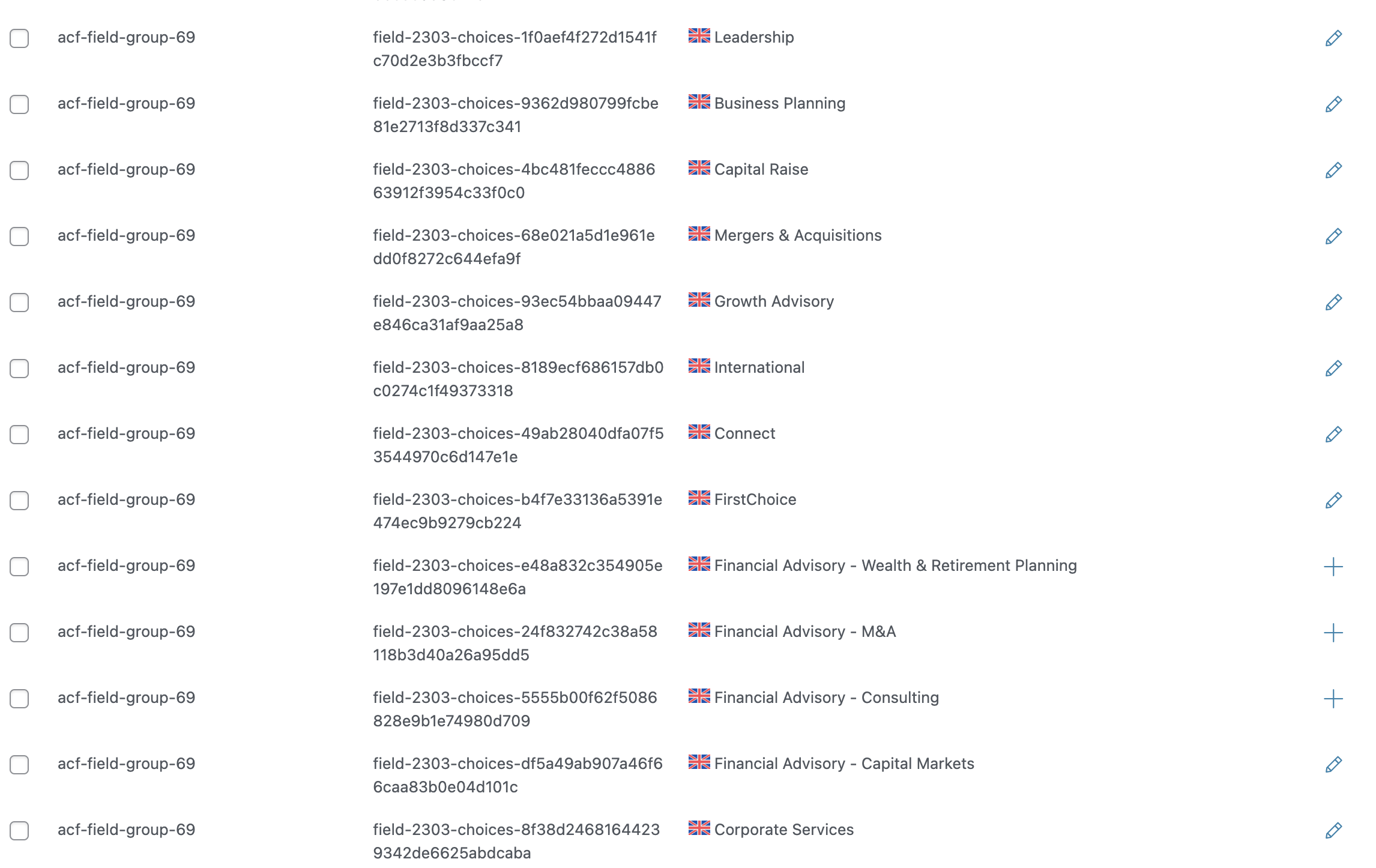

2. Admin > WPML > String translation: I've manually translated these labels in "acf-field-group-69"
When I view a Dutch version of a team member, these division labels are not being translated:
NOTE: This is a multisite environment. The ACF field groups live in the main site and what you're viewing here is a child site with translations. As noted above in step 1, I set both sites to translate the field set, but String translation is only available on the main site as the child site is using the main site's ACF field set in this case via the local /acf-json/ method.
