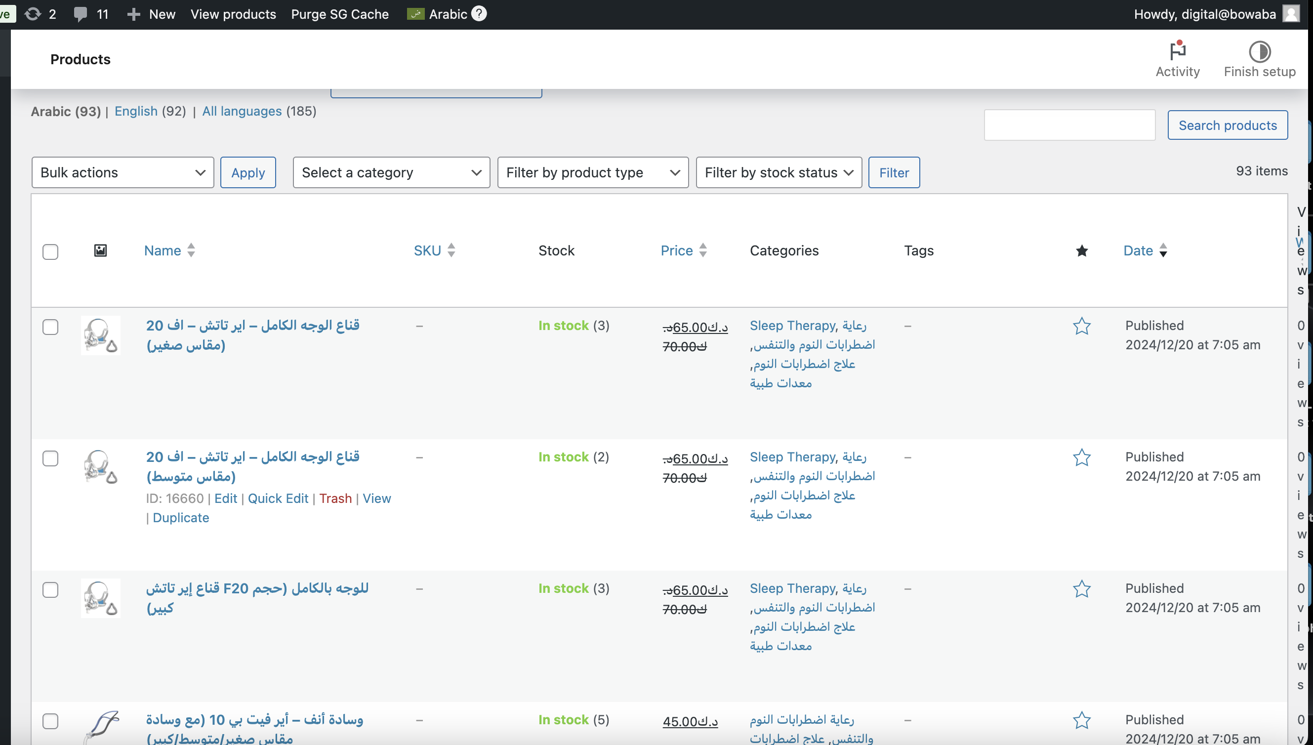

Please check under the arabic products as in the screeshot in the category column you will see the Arabic categories and then only one English category in each product. That's the issue it should only show Arabic categories.

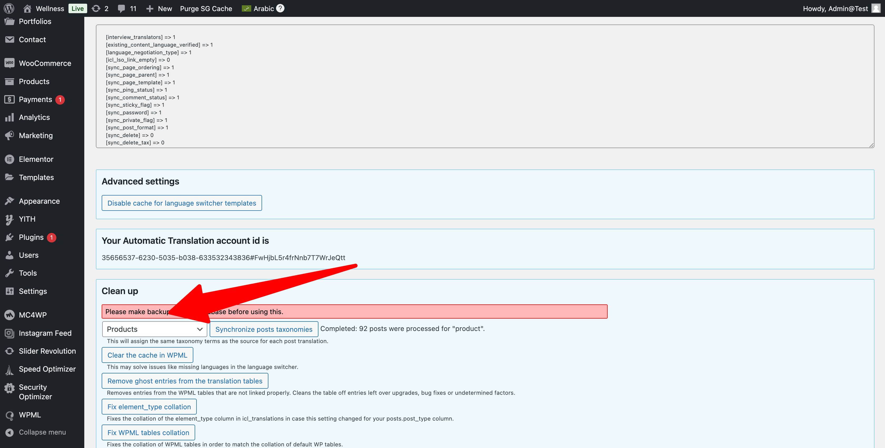

Can you check the issue now. I followed the below steps:
- Went to WPML->Settings->Post Type Translations and set "Products" as translatable (first option)
- Went to WPML->Settings->Taxonomy Translations and set "product categories as translatable (first option)
- Went to WPML->support->Troubleshooting and selected product and synchronized the categories.
Let me know if's okay now.

hi, just checked it out, so what i did is that it removed all the sub categories for most of the products, and for some it removed all categories and kept only the one in english
Video Reference: hidden link
