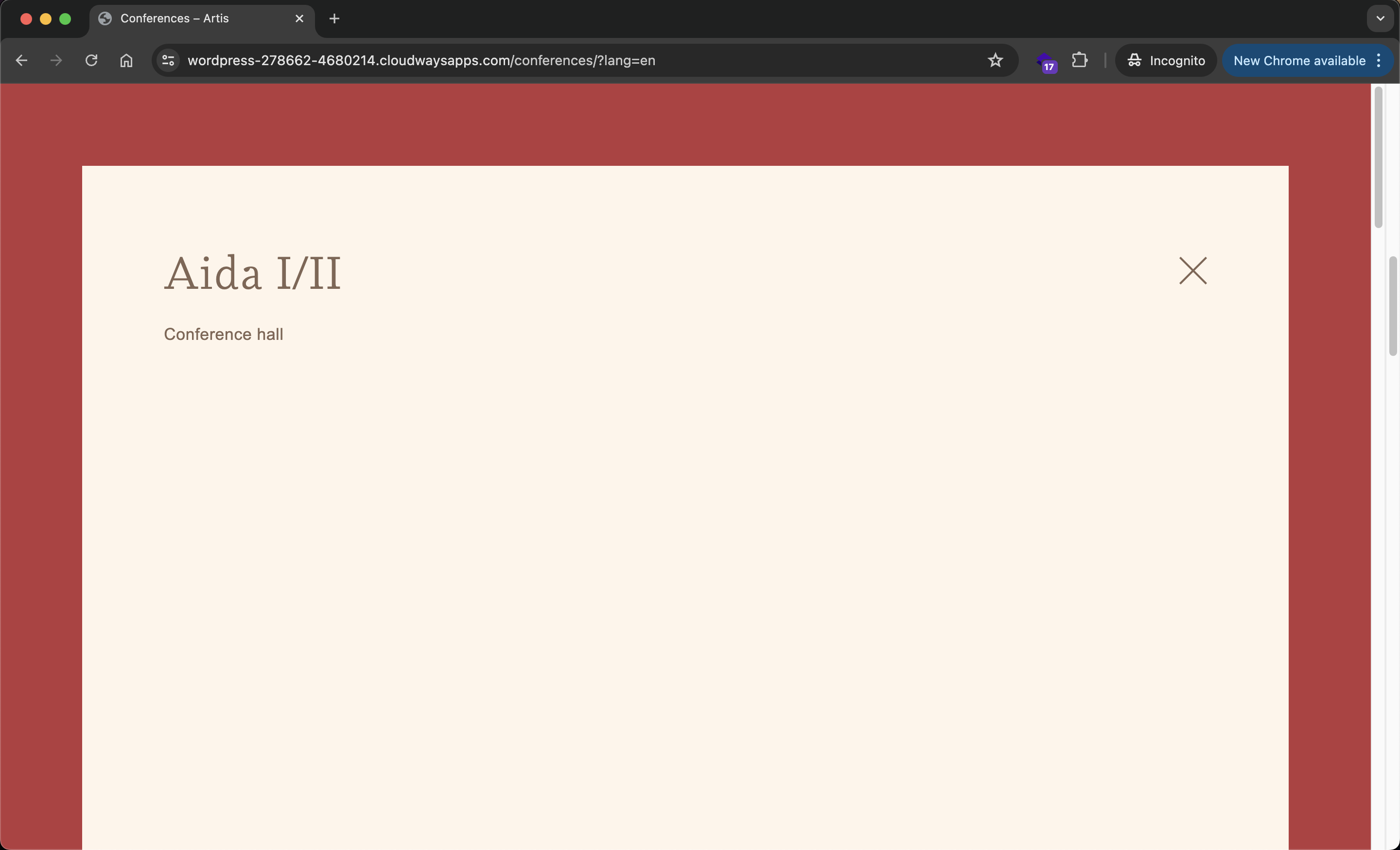

June 28, 2024 at 6:39 am #15849541
migleP
just checked the site on your cloudways environment, and the issue persists, maybe you were logged in?

June 28, 2024 at 6:11 pm #15853707
Bobby
WPML Supporter since 04/2015
I was able to reproduce.
Please visit the test site again and test using the homepage in EN, the pop up works OK there with the rooms, but the conferences still experience the issue.
