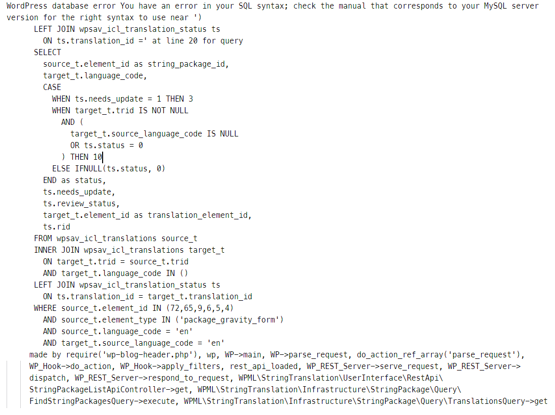

I am trying to translate a Gravity Form by creating a translation job on the Translation Management page. This process works, and I can translate the form, which displays correctly in both Danish and English. However, I encounter an issue when opening the 'gravity forms' section on the translation management page. This issue occurs on both my development site (hidden link) and live site (hidden link). The error log shows a WordPress database error related to SQL syntax when attempting to display the translation status of the forms.
I receive a WordPress database error in the error_log file: 'You have an error in your SQL syntax; check the manual that corresponds to your MySQL server version for the right syntax to use near \') LEFT JOIN wpsav_icl_translation_status ts ON ts.translation_id =\' at line 20'. This error occurs when I open the 'gravity forms' section on the translation management page. The translation management shows the forms as not translated (indicated by a red circle), even though they are translated.
Why am I receiving a WordPress database error when opening the 'gravity forms' section on the translation management page?

The image I shared in my original post shows the exact error message that is in the log.
There is no 'warning' message in the admin.
I'm not sure a screen cast would show any more than what I have explained

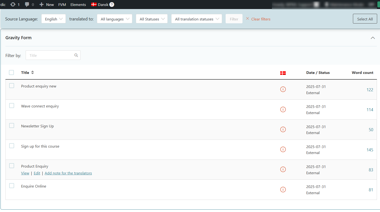

1. I go to WPML / Translation management
2. I scroll down and expand the 'gravity forms' section
3. All the forms are shown as not translated when they actually ARE translated
After performing steps 1 and 2 the error message appears in the error_log file.

July 31, 2025 at 2:31 am #17283439
Natalie Wood
thanks for looking in to this
As I explained in my previous message:
"You will need to have 'English' chosen as your language"
This is at the top of the screen
In your screencast the language is 'Dansk'

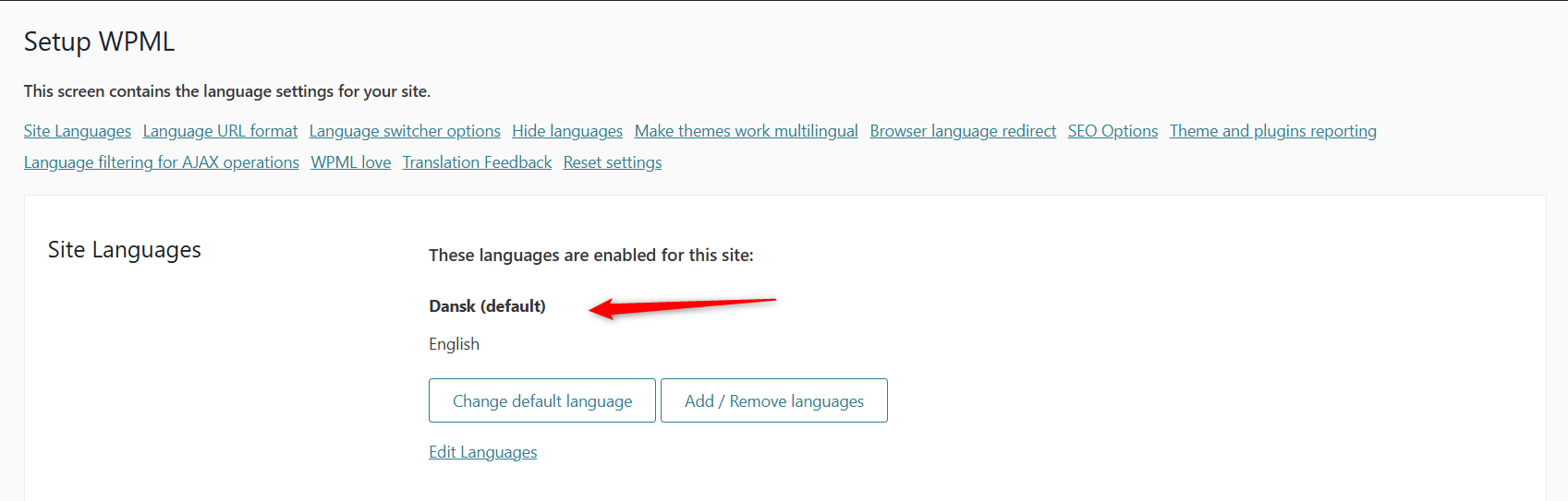

Thank you for the updates. I can now see the forms. In general, creating posts in a secondary language and translating them into the primary language should not cause any issues.
However, have you ever changed the default language of the site (for example, from English to Danish)? This may affect how translations behave.

August 1, 2025 at 3:36 am #17286967
Natalie Wood
No we haven't changed the default language of the site
