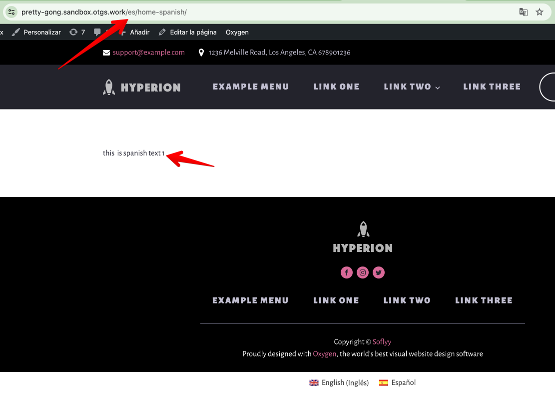

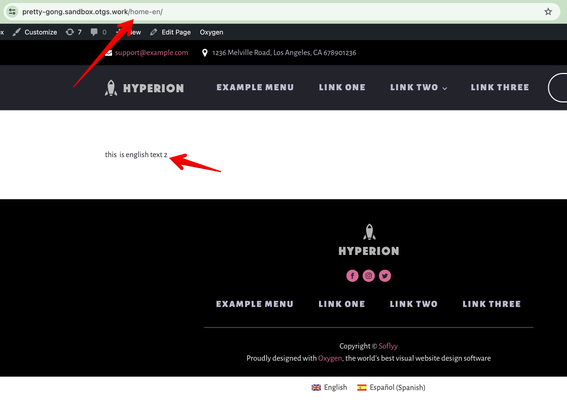

I followed those steps to update the text and page title in both English and Spanish languages but did not see that issue. Please check screenshots attached.
Can you please share a screen record of the steps you do on your end?
Look forward to your reply.
