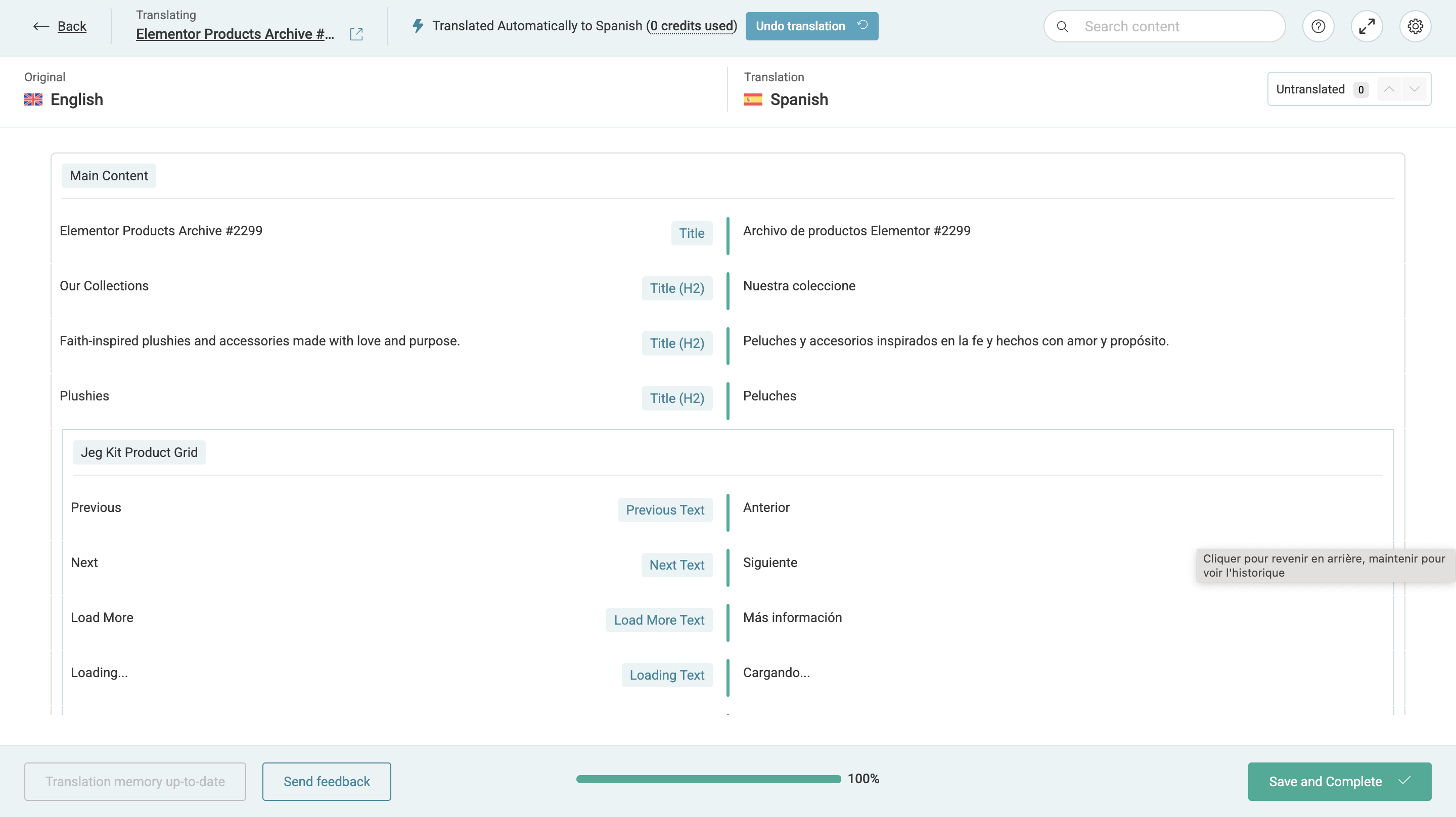

Hello Marcel, The template is translated at 100% this is the issue. It is translated yet nothing is happening. Go to the translations page and check it for yourself.
Here is a screenshot:
Also, Once I click save translation or if I try to cancel it, nothing happens.
Is there a way we could schedule a call? it would be easier to discuss this in person?
Thank you

The status symbol remains in progress, displaying the "Clockwork wheel". For some reason, WPML can not complete the translation.
I will investgiate further and then get back to you. I suspect that this could be an issue between WPML and the Product Grid Widget from Jeg Kit for Elementor.
