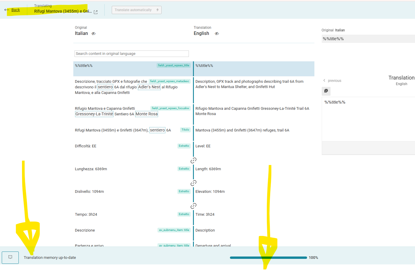

Picture 1) I randomly select any page where both EN and FR versions have the pencil icon
Picture 2) Before doing any change to the original version, just to be safe, I open the EN version. You can see that the translation is 100%. I click on "COMPLETE AND SAVE" at the end. For me, the translation is now refreshed.

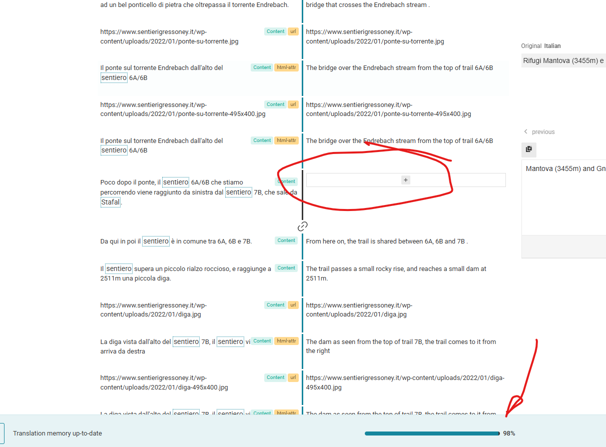

Picture 3) I open the IT page, and I add a space in the place I am showing
Picture 4) When I open the EN version, I have 4 segments missing, and none of them is the one where I've added the space.
This is happening on EVERY portfolio page.
