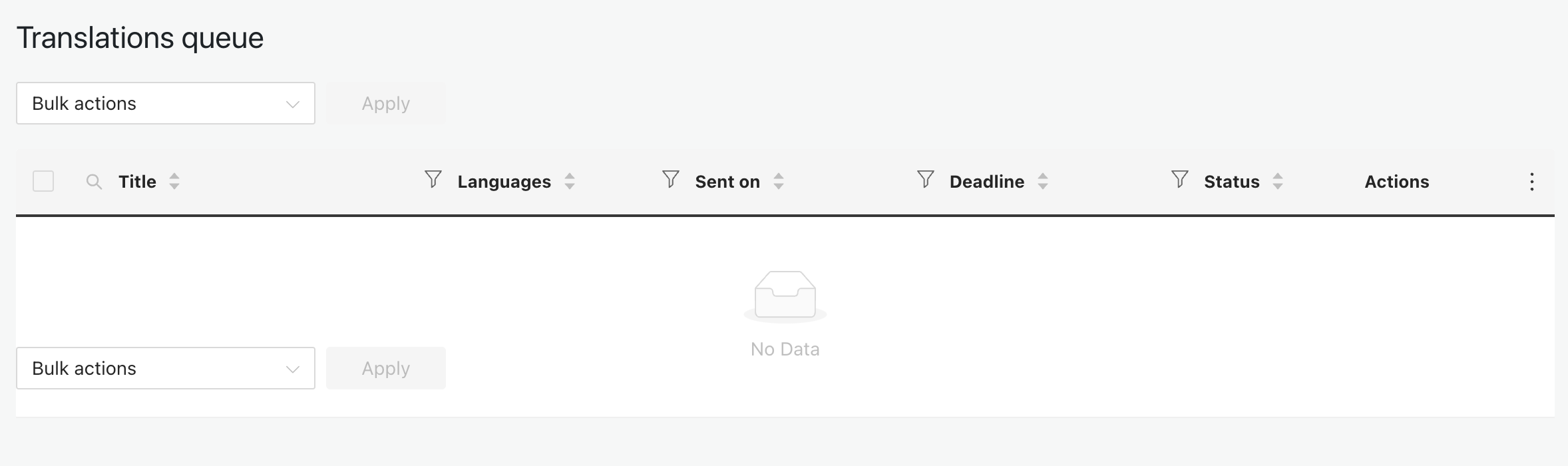

Hi, the translated pages status are pending review but doesn't appear in the translation queue. could you find out why?

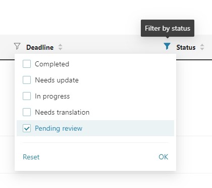

Can you try the following (as shown in the attached screenshot)?
- Go to the translations queue.
- Click the filter icon on Status column.
- Select "Pending review".
- Click "Ok".
And see if anything appears?
Please let me know.
Regards.

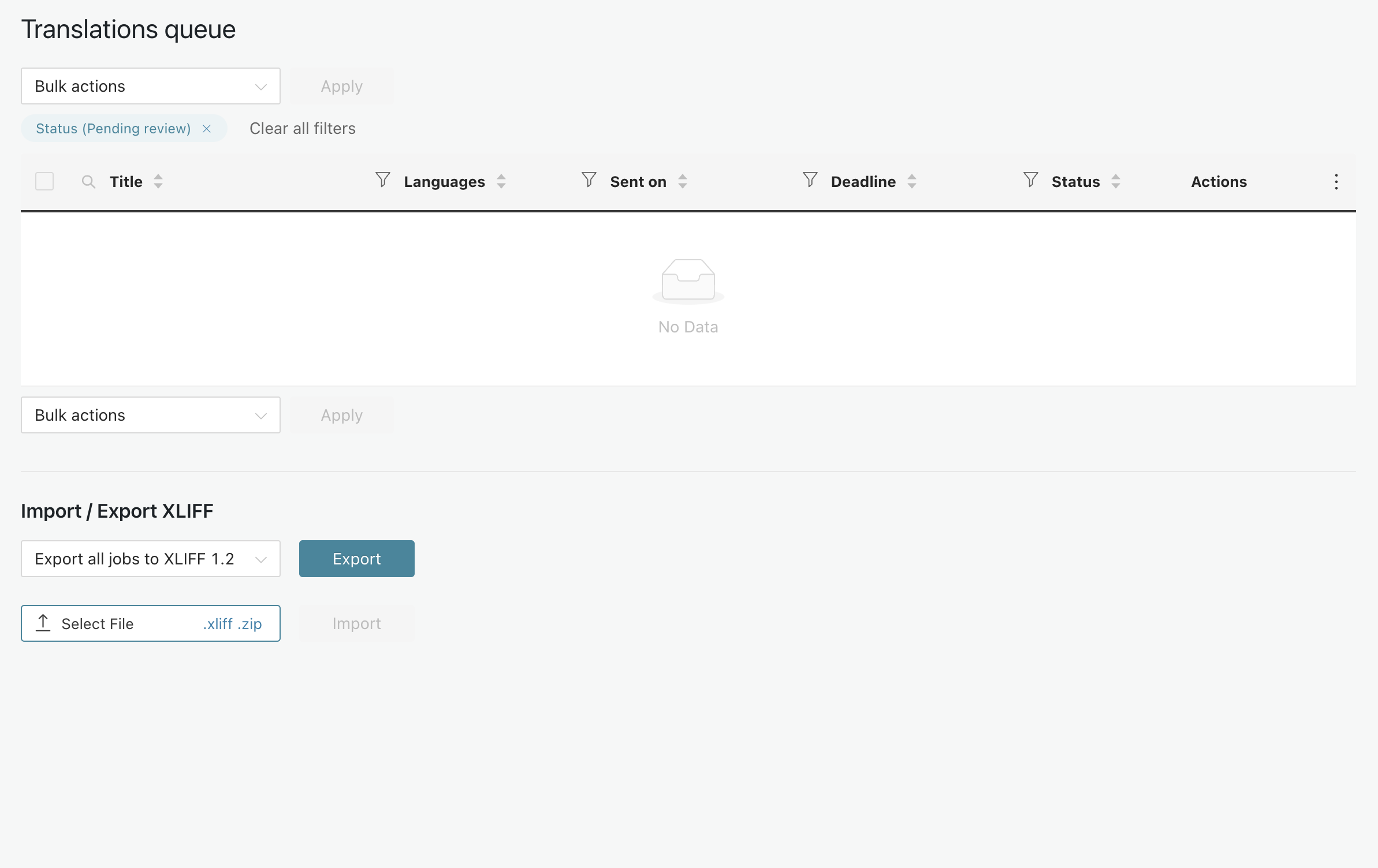

shafira-anjaniA
I tried, but it shows nothing

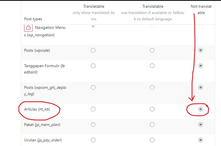

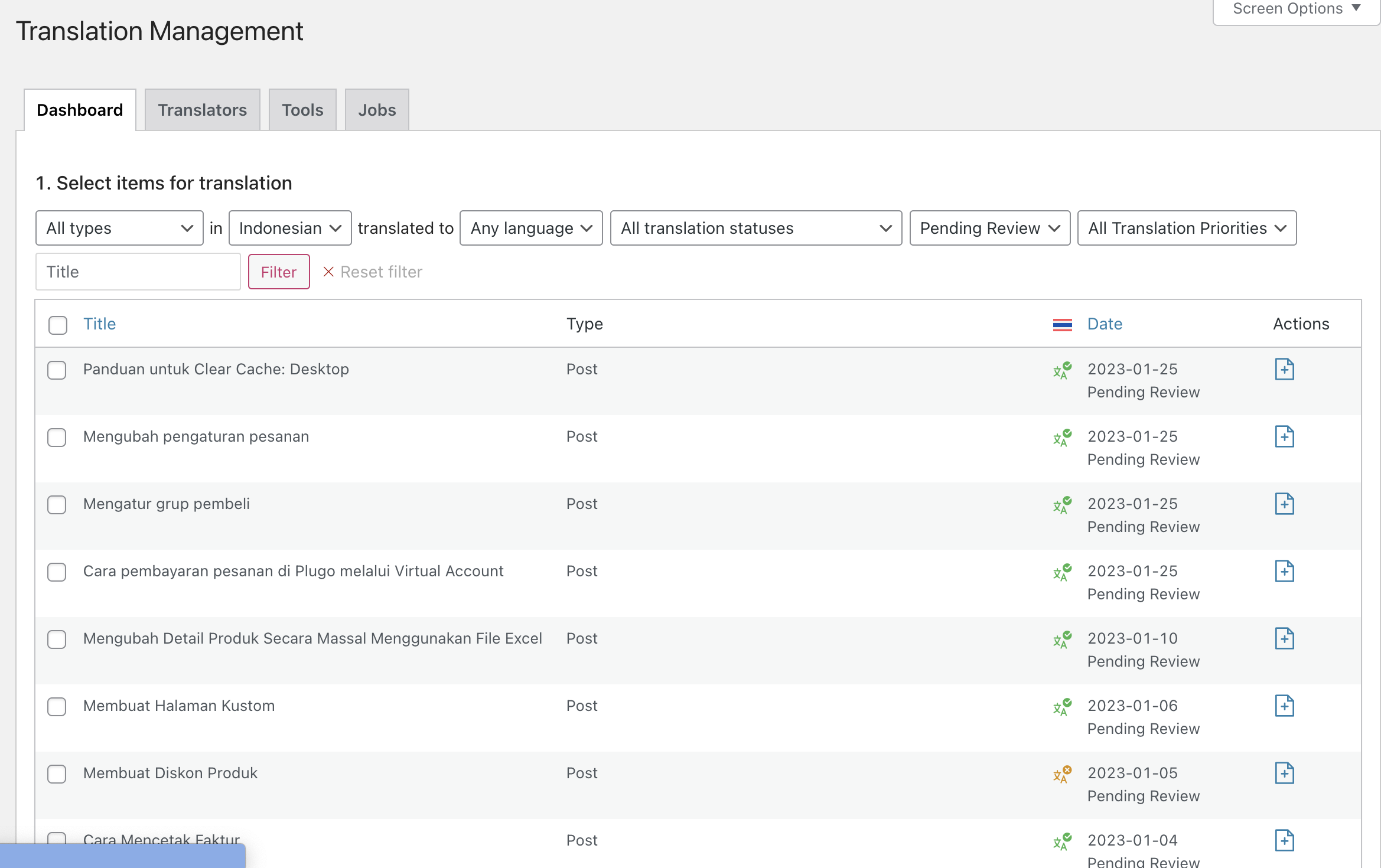

I am wondering how did you translate those Heroic KB Articles? Because I see those are set as "Not translatable" in WPML -> Settings -> Post Types Translation (see attached).
Since these aren't set to translate, they won't appear in Translation Management also (see attached).
You'll need to set those Articles as translatable and then translate accordingly. See https://wpml.org/documentation/getting-started-guide/translating-custom-posts/ for details.

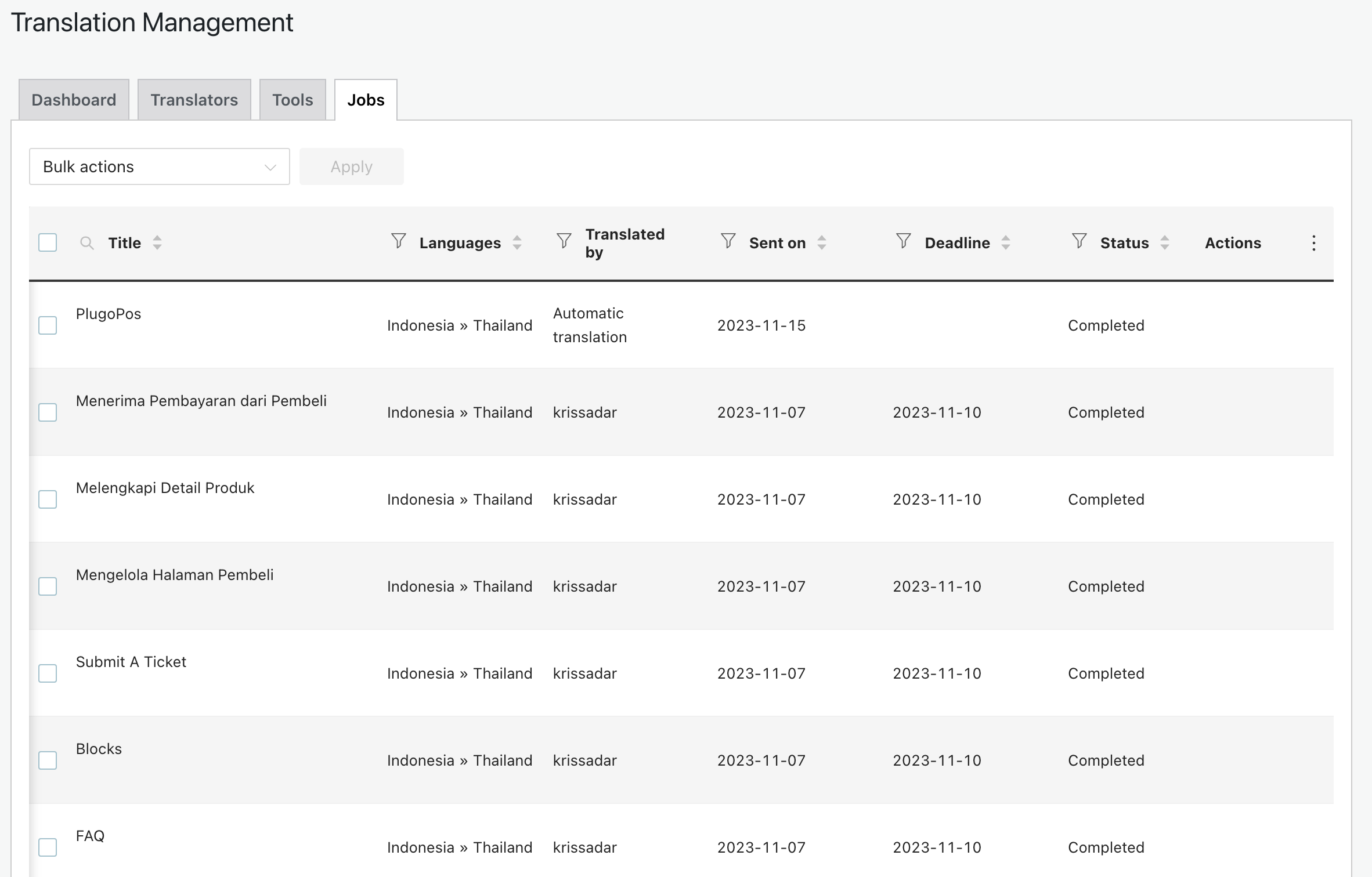

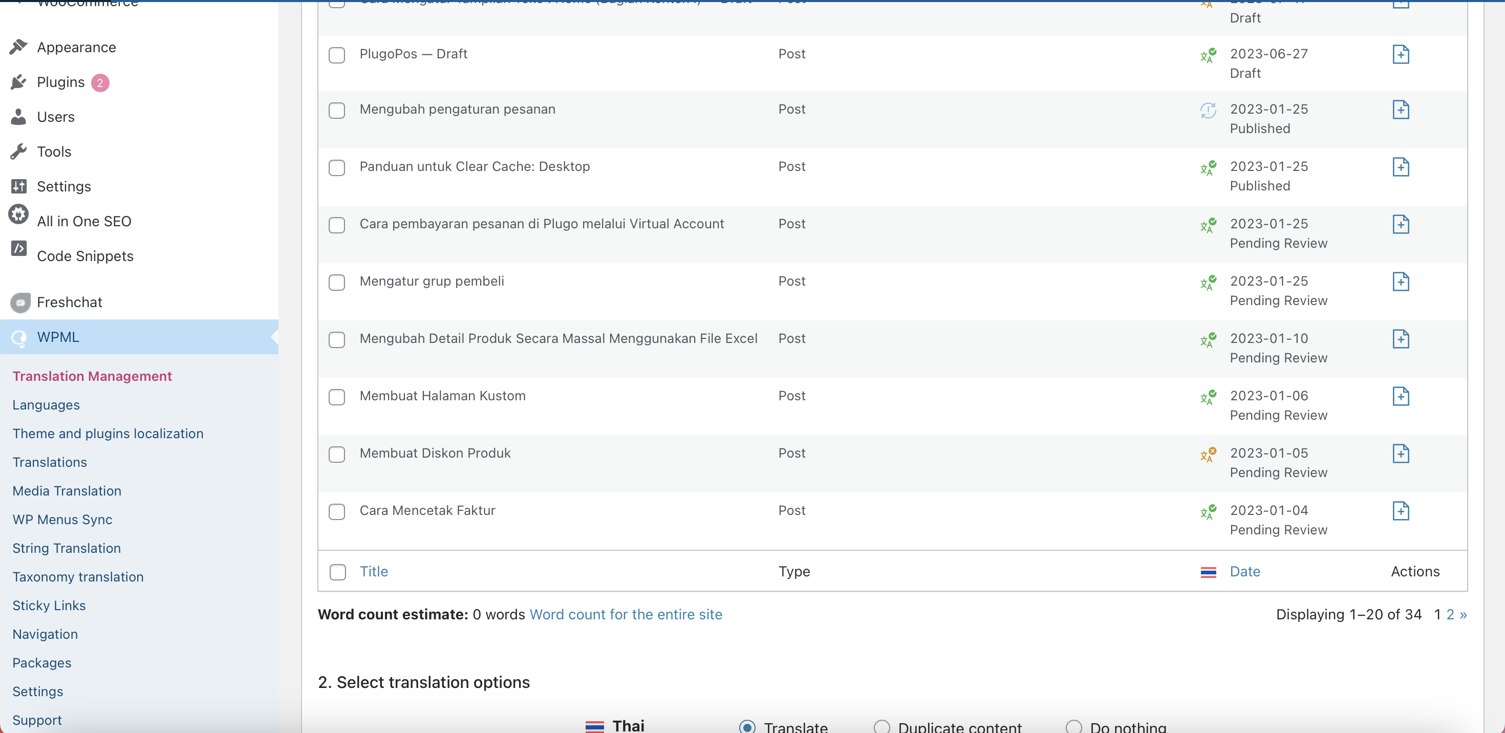

It's weird because I went to Translation Management and can see all the articles on my website. I then assigned the articles to the translator, and they managed to translate them okay.

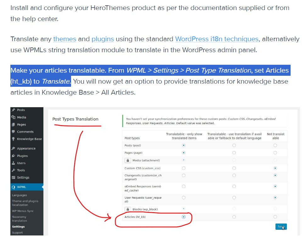

Also, the theme provider (HeroThemes) said that WMPL is fully compatible with their theme. They suggested it, and that's why I used the plugin.
They have the working documentation: hidden link

I think there's a confusion between Posts (standard post type = post) and Articles (custom post type = ht_kb). In your recent screenshot, if you notice, the post type column lists these as "Post", which means somehow theme is registering Articles as standard posts (even Articles CPT is registered separately), because perhaps these aren't set as translatable in WPML settings. In this case, you have to deal these as standard WordPress Posts. And I stand my previous comments about it (the private message earlier).
Otherwise you may need to contact theme support that if you created Articles, why these are registered as (standard) Posts. This is however a different problem than the current one.
If you want these really treated as translatable Articles (custom post type = ht_kb), you 'll need to make this translatable, just like they also mentioned in their guide (see attached). The guide also talks about related custom taxonomy, please read and follow the guide carefully.
Once these are registered (custom post type and taxonomy), these should appear in TM as Articles. You should also translate these accordingly (either from TM or from Articles listing page) and review accordingly.
