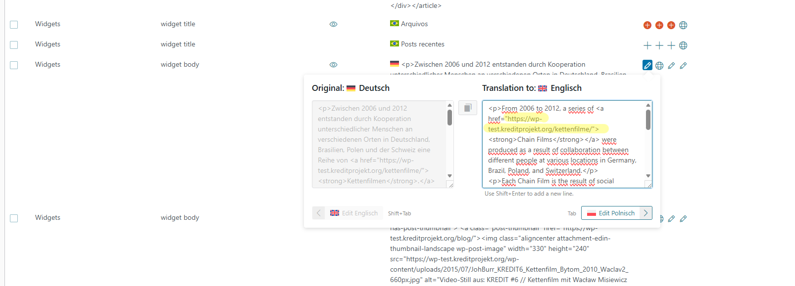

When it comes to Widgets, you will create the translations at WPML > String Translation, and I see that the links are not translated here. In this case, you will need to adjust the links in the translations, as internal linking only works for content created on the WordPress Editor.
See screenshot for an example of a widget translation.
I am still investigating the issue, when it comes to the internal links on the pages and their excerpts on the homepage, for I need to ask you for some more patience.

Well, initially I thought that the links in widgets will get changed to sticky links by WPML too. But as far as I understood now, they have to be translated "hard coded", as to say...
Actually, we didn't translate any link in our content, since we thought that they will get or got already changed into sticky links. But what's quite confusing to me now is that, apparently, the links in the widgets that are working correctly, those that point to the respective language correctly, got "translated", both on your test site and on our site. See the screenshots. But I do not remember that I have translated any links in any widget, neither on your test site when I tried to replicate our scenario there. Could it be that WPML injects the correct link for the respective language in case of an internal link? Or did I really translate the links in those widgets and just do not remember?
Looking forward to your further investigating. Thanks.

Further, I have created a fix that will allow Sticky Links to adjust permalinks on widgets, but this will require code interaction inside the Sticky Links plugin.
The plugin yet does not consider the new widget structure inside newer versions of WordPress.
If you would like me to implement the fix on your site, please let me know. It solved the issue on my test site. Otherwise, it might be better to first wait for the reply from Second Tier Support and Development.
January 8, 2026 at 4:13 pm #17713674
johannesB-39
Hello Andreas,
thanks for your tests.
Just let me resume:
1) The behaviour of internal links in the body text of pages is as expected, both on my site and also on the sandbox: The permalinks get changed into sticky links by WPML and point always to the correct respective target language.
2) According to your tests, links in the content of page excerpts are changed into sticky links by WPML correctly and point to the correct respective language (in the Sandbox test example: On the German front page, they link to the German subpages and not to the English ones). You wrote that you weren't able to reproduce this issue on the sandbox and, consequently, attributed it to the Edin theme or to an issue related to my development environment, custom code or what ever. Correct?
3) Also according to your testing, widgets do not get scanned by WPML, neither on my site, nor on the sandbox. Consequently, permalinks in widgets do not turn into sticky links and don't point to the correct respective language. Right?
As for 1), this is what I have reported here in the chat since the beginning. My issues are related to 2) and 3). And I cannot confirm your results concerning 2) and 3), at least not fully:
Concerning 2):
As I wrote yesterday here in the chat and according to my tests on the sandbox that you can replicate easily, the internal permalinks in the content of page excerpts do not get changed into sticky links by WPML and always point to the original target language (English), except for the one in the excerpt of page C's content! In my tests on the sandbox, the internal permalink in page C's excerpt turned into a sticky link, yes!, although still pointing to the English target site, independently on which language version of the front page you are, or in other words: on the German front page the link points to the English subpage instead of the German. But it's a sticky link created by WPML!
Did you try to reproduce this on the sandbox with Edin theme? Or did you test this on any other theme? Could you show me your results, please? Where is it working correctly in your test environment?
Concerning 3):
I can confirm that internal permalinks in Custom HTML Widgets in the sandbox test environment (Edin theme, WPML, Classid Editor and Classic Widget plugins activated) do not get changed into sticky links by WPML. They stay as permalinks. But...: Whereas the unaltered internal permalink in widget B and C still points to the original English target page on the frontend, the permalink in widget A got changed and points to the German target page correctly, without being changed into a sticky link!
Can you confirm this, please? For me, the behaviour of the internal permalink in widget A is the desired and also expected one, independently of his being changed into sticky link or not by WPML. I just want the links to point to the correct target language. Why isn't this happening in the case of widget B and C? They are all the same? Did you try to replicate this on the sandbox with Edin theme? Or did you test this on any other theme or in any other environment?
I disconsidered now my testing with manually created sticky links, since you wrote that one should avoid to do this and, instead, always let WPML create them automatically. But even with permalinks, I really cannot fully confirm your results. Internal permalinks do not work correctly on your sandbox with the Edin theme and WPML plugin activated, neither in page excerpts nor in widgets. At least, they do not behave in a consistent and replicable manner in my tests!
Last but not least: I neither can confirm the issue you reported about the "Featured Pages" section on the front page not getting updated when content is updated in the backend of the subpages. On the sandbox, this works just fine and normally. You just have to insert your updated text in the "excerpt" box of the Editor in backend! Only changing the body text of the page won't alter the content of the excerpt, you have to do that manually in the excerpt box. See the two screenshot attached to my post here.
Looking forward to your explaining more in detail your results!
Kind regards,
Johannes
