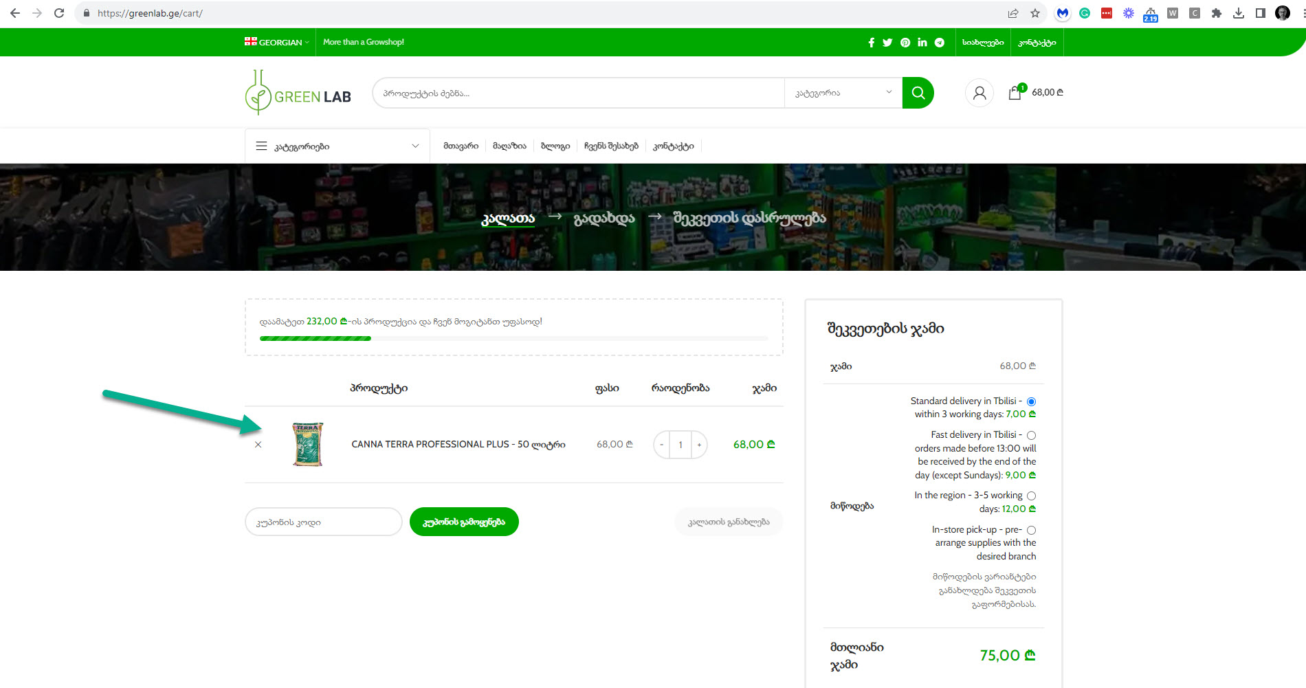

The issue seems to happen randomly because now I can add the following product to the cart. Please see the attached screenshot.
Can you confirm that it is a random issue that sometimes happens and sometimes not?

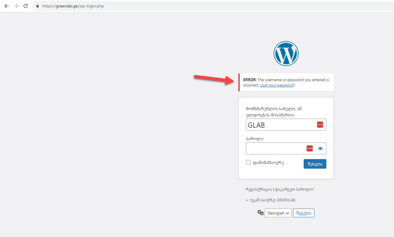

I tried to access your site to check things, but the access details you provided them do not work for me. Please see the attached screenshots. Please correct the access details and share them with me in the following private message.
If you need further help with this, please share the access details to your site with me.

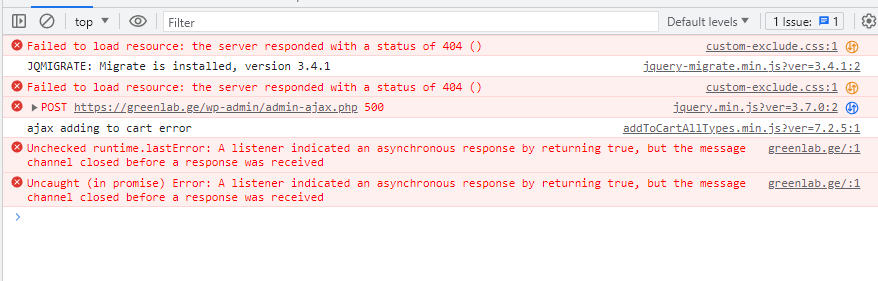

Hello! it's me again... i updated wpml and it started working, but today still same problem occured in inspect element while trying to add to cart product from single products page, i get this type of error in inspect (i will attach photo also) :
custom-exclude.css:1 Failed to load resource: the server responded with a status of 404 ()
jquery-migrate.min.js?ver=3.4.1:2 JQMIGRATE: Migrate is installed, version 3.4.1
jquery.min.js?ver=3.7.0:2 POST hidden link 500
send @ jquery.min.js?ver=3.7.0:2
ajax @ jquery.min.js?ver=3.7.0:2
(anonymous) @ jquery-migrate.min.js?ver=3.4.1:2
e.<computed> @ jquery-migrate.min.js?ver=3.4.1:2
(anonymous) @ addToCartAllTypes.min.js?ver=7.2.5:1
dispatch @ jquery.min.js?ver=3.7.0:2
v.handle @ jquery.min.js?ver=3.7.0:2
addToCartAllTypes.min.js?ver=7.2.5:1 ajax adding to cart error
greenlab.ge/:1 Unchecked runtime.lastError: A listener indicated an asynchronous response by returning true, but the message channel closed before a response was received
greenlab.ge/:1 Uncaught (in promise) Error: A listener indicated an asynchronous response by returning true, but the message channel closed before a response was received
