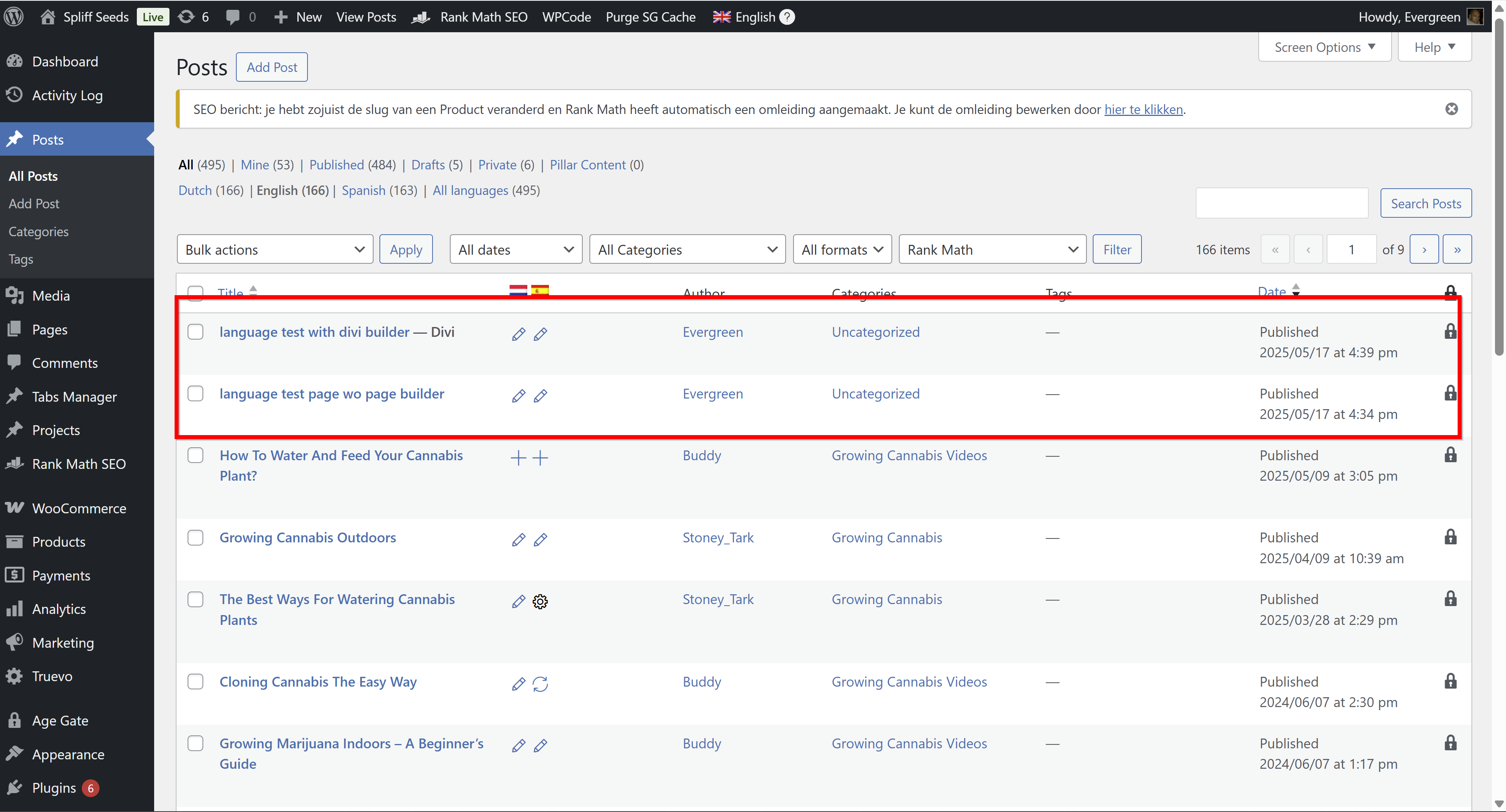

Marcel Elbers
Hi Bobby,
Ok i made 2 posts with text and link in it. 1 post with the divi builder and 1 post without the divi builder. After the post were 100% translated i changed the link in the text in the default language. After i openend the translations, but all translation were still there. This is both for with and without the divi builder.
You can see the 2 latest posts i made and test it for yourself. Let me know.
Thanks,
Marcel

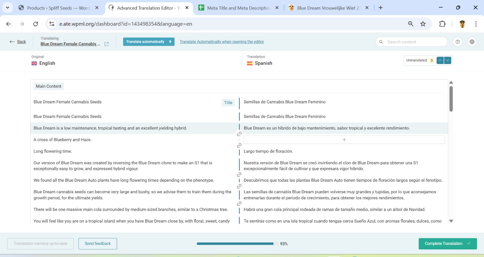

May 21, 2025 at 9:30 am #17056134
Marcel Elbers
Hi Bobby,
FYI:
This product hidden link we fixed last week we opened it just now and some parts of the translations are gone again.
This product was only translated with using ATE.
We copied the translation again in it now from the front page.
Thanks,
Marcel

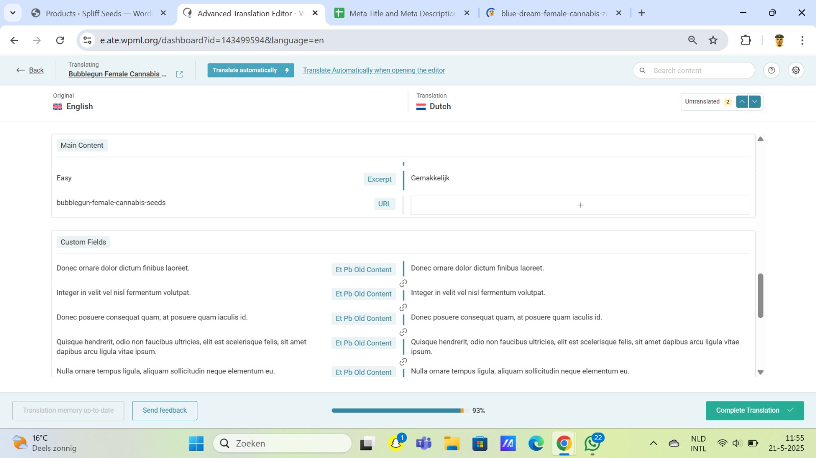

May 21, 2025 at 9:50 am #17056281
Marcel Elbers
Hi Bobby,
Also this product: hidden link
Some of the Dutch and Spanish translations are not remember.
Last week we fixed already all products and now we open it again and again part of the translations are not remembered. Also 100% sure that only ATE was used here.
Thanks,
Marcel

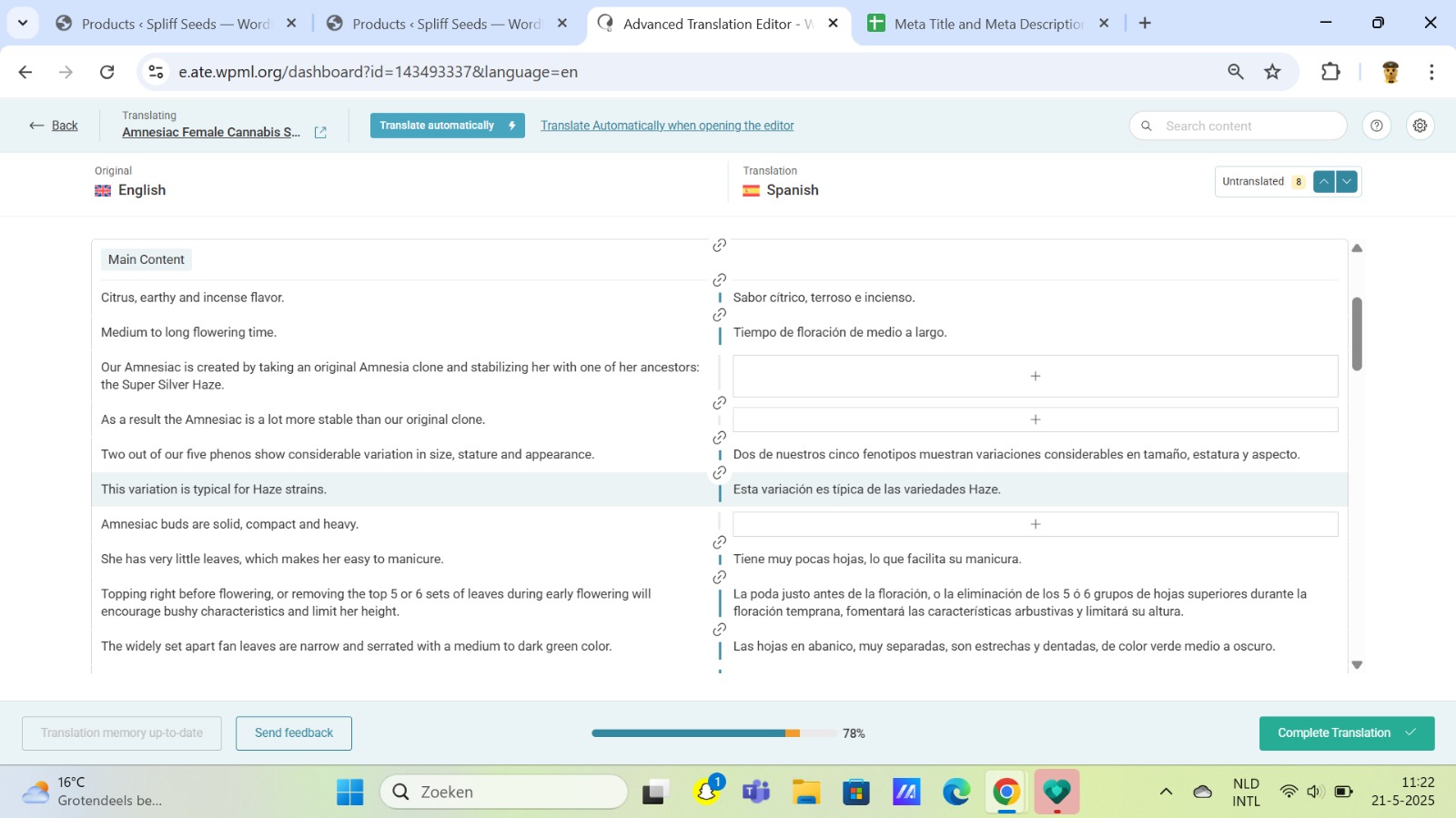

May 21, 2025 at 10:24 am #17056458
Marcel Elbers
Hi Bobby,
FYI:
Also this product hidden link
same problem.
We fixed it already manually now as we want to go ahead.
