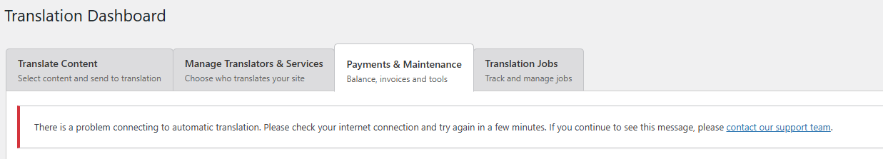

April 9, 2026 at 6:27 am #17958061
Stefan
Since always I amnot able to see the informationin Payment & Maintenance tab. I want to see my credits

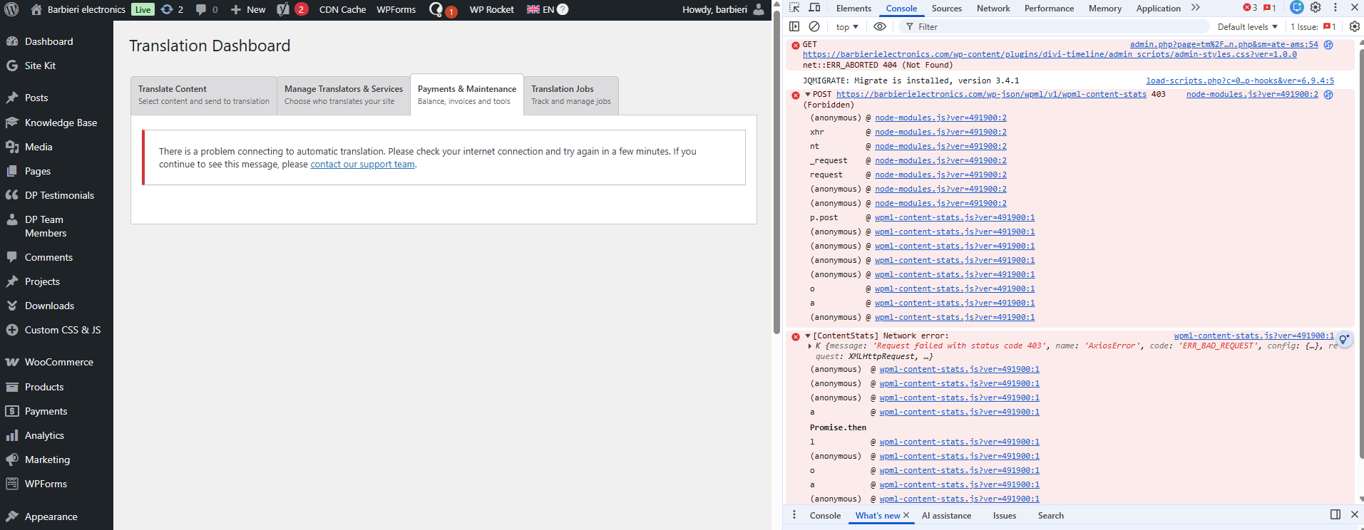

April 9, 2026 at 7:49 am #17958386
Stefan
the website is
And I need to understand where the 600 Euro credits have been usewd

April 9, 2026 at 8:47 am #17958730
Stefan
Attached please find the error messages shown in Console Tab.

April 9, 2026 at 9:40 am #17958928
Olexander Zhitskiy
Thanks for sharing the screenshot — that helps a lot.
I can see that one of the requests is returning a 403 error, which usually means the request is being blocked before it reaches our system.
Could you please share:
• Which browser and version you are using?
• Whether you are using any VPN or proxy?
Also, could you try the following:
• Open the page in incognito/private mode
• Try a different browser (e.g. Chrome, Firefox)
• Make sure your browser is up to date
• If you are using a VPN, try disabling it or switching to another network/IP
Clearing cache usually doesn’t affect 403 errors, but trying incognito mode can help rule out extension-related issues.
Let me know if the issue persists after trying these steps.
In parallel, Nik also checking the credit usage and will get back to you with more details.
Olexander
April 9, 2026 at 9:53 am #17958948
Stefan
in my first Screenshot I wa susing Chrome browser under Windows (latest version).
I tried now under Edge in incognito mode with same problem. See attached screenshot.
I amnot using VPN, just my normal Work computer Windows 11 64 Bit.
Let me know if the Firewall may block a certain port needed for this service?
April 9, 2026 at 1:05 pm #17959492
Olexander Zhitskiy
Thanks for the detailed information and for testing in different browsers — that’s very helpful.
I checked the request shown in your screenshot (wpml-content-stats), and this specific 403 error should not directly affect the Payment & Maintenance tab. So it looks like there may be another underlying issue.
To investigate this further, I see two possible options:
Option 1:
Please share a HAR file (you can upload it to Google Drive and send me the link). This will allow me to see all requests and identify what’s being blocked.
Option 2:
Provide temporary WordPress admin access, and I can check the issue directly on your site from my side.
Either option will help us quickly pinpoint the root cause.
Also regarding your question — yes, in some cases a firewall or security system can block specific requests, but we need to confirm exactly which request is failing before making conclusions.
Let me know what works best for you 👍
Olexander
April 9, 2026 at 2:48 pm #17959795
Olexander Zhitskiy
Thanks for sharing the access — I’ve checked the issue directly on your site.
I can confirm that the Payment & Maintenance tab is not loading, so this is not related to your browser or local setup. It looks like something on the site (possibly a plugin or configuration) is interfering with the expected behavior.
We’ve already identified the issue and are now working on it together with the WPML team. I’ll keep you updated as we make progress.

April 10, 2026 at 5:48 pm #17962756
Giuseppe Toto
WPML Supporter since 12/2025
I've identified the issue affecting the Payment & Maintenance tab and applied a fix directly to your site.
The problem was caused by WordPress output buffers interfering with the ATE widget script, preventing it from loading correctly.
File modified: wp-content/plugins/sitepress-multilingual-cms/classes/ATE/proxies/Proxy.php
Fix applied:
  while ( ob_get_level() > 0 ) {   //Fix
      ob_end_clean();
  include $script;
  die();
We will include this fix in our next release. Thank you for raising it.
The Payment & Maintenance tab should now be working correctly. Please let me know if you experience any further issues.
