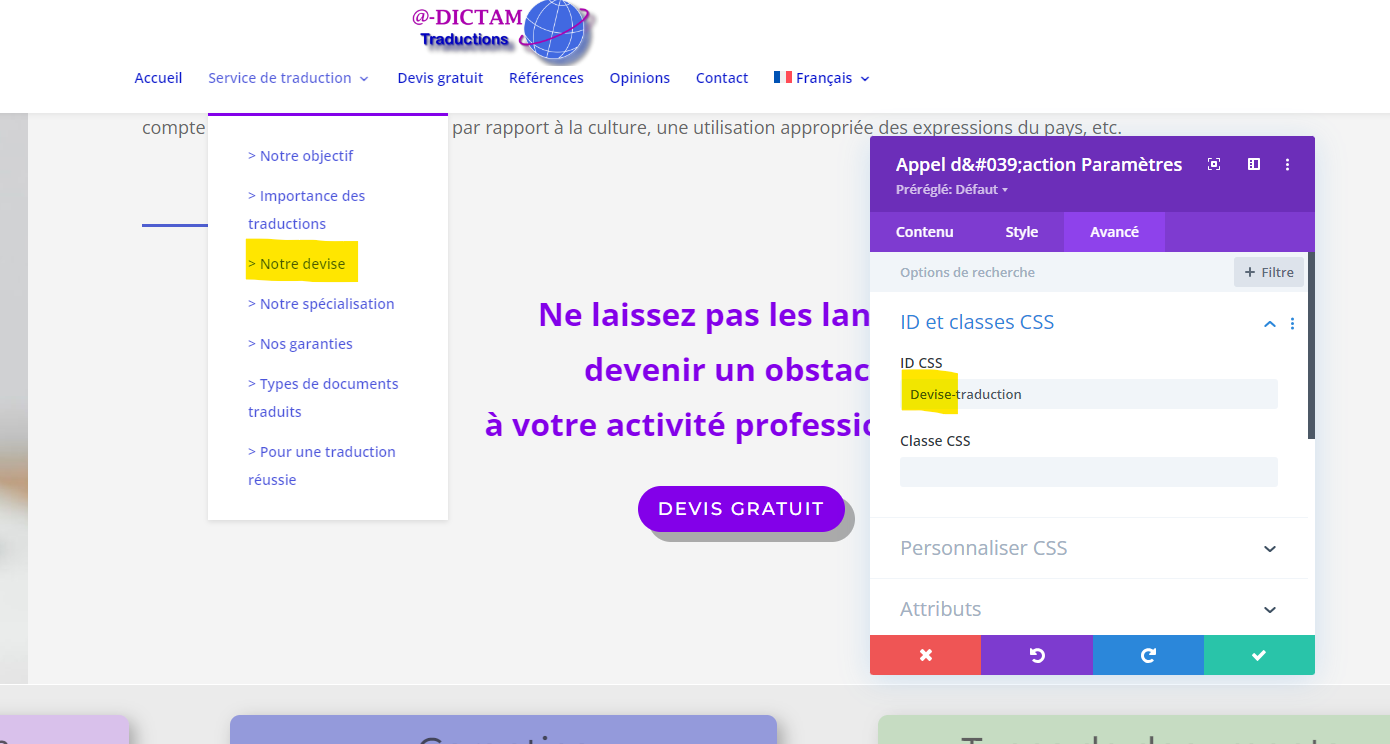

I set CSS ID to every section of my main page and to some lines in order to go directly to the section or a specific place in my page using the main menu.
For example:
The CSS ID is Devise-traduction (you can see the picture enclosed).
In the Spanish version, I have to manually translate some CSS ID because they are not translated. They stay in french o they don't appear at all so, I have to add them manually.
In my example, I had to manually write in the CSS ID in the Spanish page "Lema-traduccion"
However, other CSS ID work fine. For example, "Devis-gratuit" turn to "Presupuesto-gratuito" in the Spanish version
So, every time I update a translation to Spanish, then I have to manually access directly to the Spanish page and change or add some of the CSS ID.
Thank you in advance for your help.
Best regards

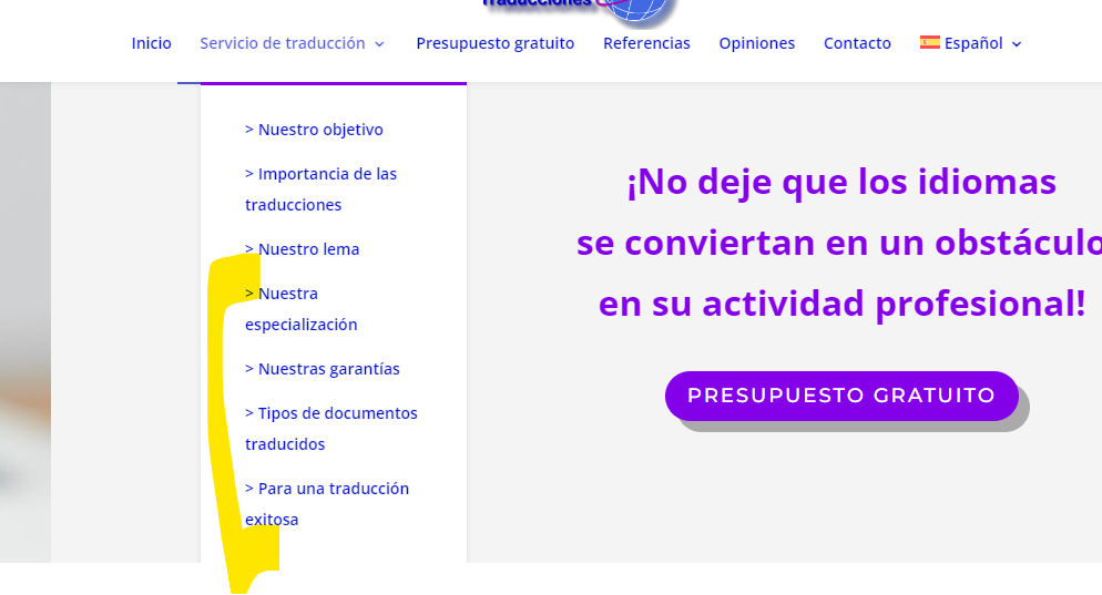

Hello, It did the trick for the first 3 items because the link is effectively on the divider, but for the rest, 3 are modules/sections and the last one is a line, I could also use a sections. Please tell me the shortcode I should use. Do I paste it before the first one I just used.
Thank you in advance. Regards,
October 4, 2023 at 2:02 am #14509107
Long Nguyen
WPML Supporter since 02/2022
For 3 modules, they are Call To Action module and the last one is the Row. You can try to use this custom XML configuration code to register the CSS ID for translation (including the divider module above):

Hello, I am sorry to tell you that this messed up all my translated H2 tittles. They are in French now in the Spanish version. I can't find them in the editor to translate them again.
However my first problem seems to be solved.
October 5, 2023 at 1:21 am #14516099
Long Nguyen
The heading on your site is the CTA module title and it looks like the custom XML configuration code that I shared overwritten the default XML configuration code. Please replace the code that registers the CTA above with this one and let me know how it goes.
