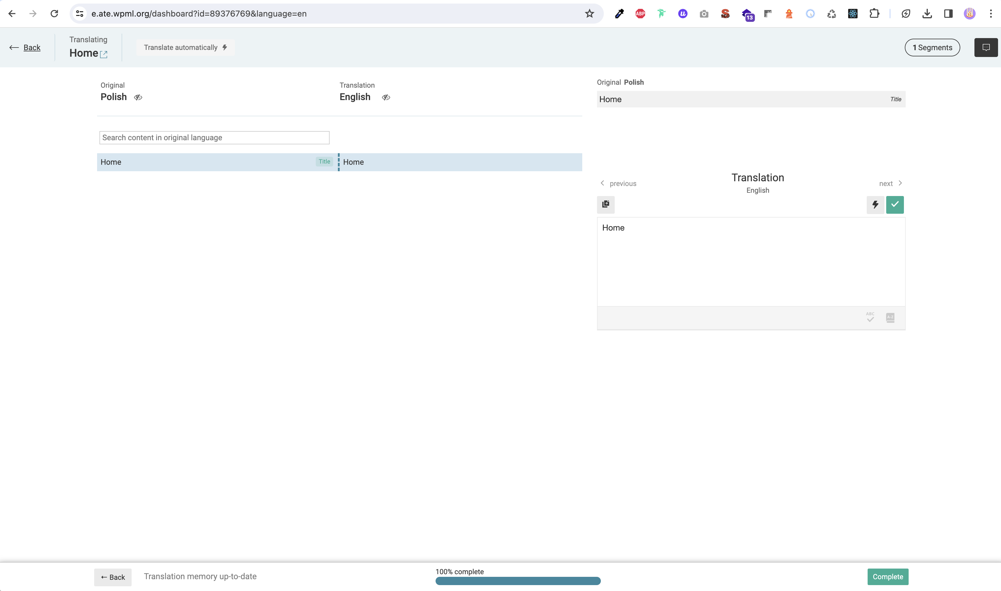

Hi, i have small problem with translate static strings on my home page. It seems they are not shows in wpml options.
As you can see on screen shots there are not any display on home page.
How can i fix this?

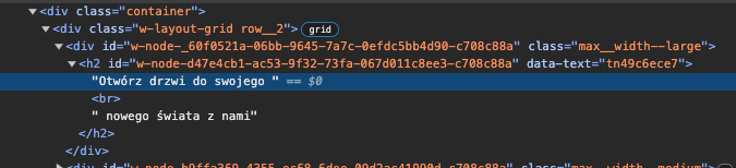

To be able to help on that I need to have context.
For example if you check the attached screenshot, it is the code which is generated in HTML that contains the string ou mentioned, but it does not give me any clue how that string is added.

Thank you for the login information. For the homepage you use a plugin called Udesly App which is not compatible with WPML.
You do not use the standard WordPress Gutenberg blocks.
That is why you do not see the texts in the translation editor.
You can check this page which you used the standard WordPress method and it works ok:
I checked the homepage and the front end editor that the Udesly plugin provides can not be used with manual method too as there is nothing to work on in WordPress itself.
I suggest that you contact the Udesly plugin developers and ask them to contact us to make their plugin compatible with WPML:
