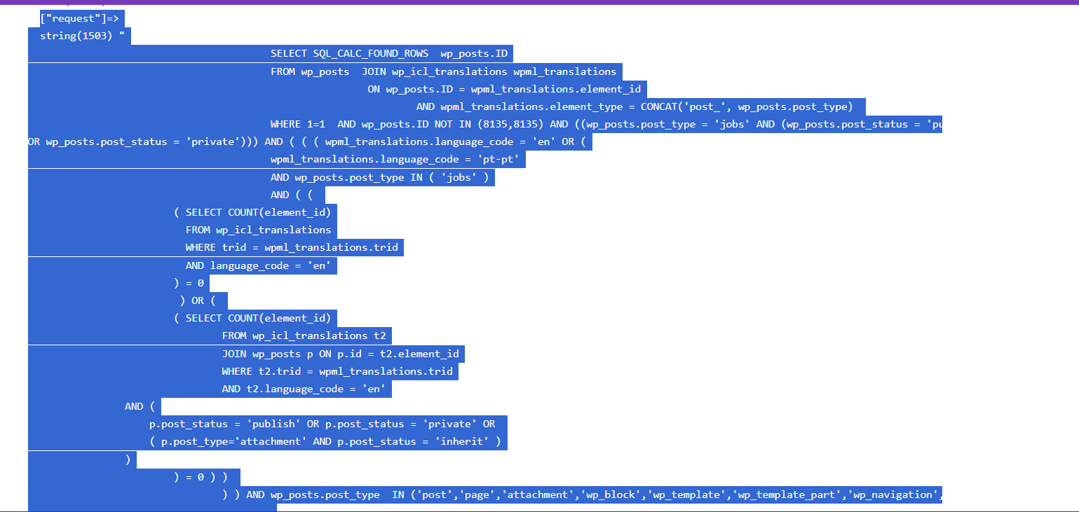

August 7, 2023 at 3:39 pm #14165021
miguelA-35
filter post by current lang
no
$args = array(
'post_type' => 'jobs',
'current' => max( 1, $paged ),
'paged' => $paged,
'posts_per_page' => 30,
'post__not_in' => $exclude,
'suprime_filters' => 0
$myPosts = new WP_Query($args);

Hi Miguel,
You are using a custom query to display posts on your site. I would like to inform you that helping you with custom code, is out of the scope of WPML. But I suggest you can correct the argument: "suprime_filters" to "suppress_filters" and recheck this issue.
Refer to the documentation https://wpml.org/documentation/support/debugging-theme-compatibility/#issue-wp_queryargs-or-get_postsargs-doesnt-filter-out-correct-posts-ids-for-the-current-language
If you are not able to accomplish this, I would recommend you contact one of our certified partners that will be more than happy to help you with this. In this link, you will find a list of our certified partners: https://wpml.org/contractors/
