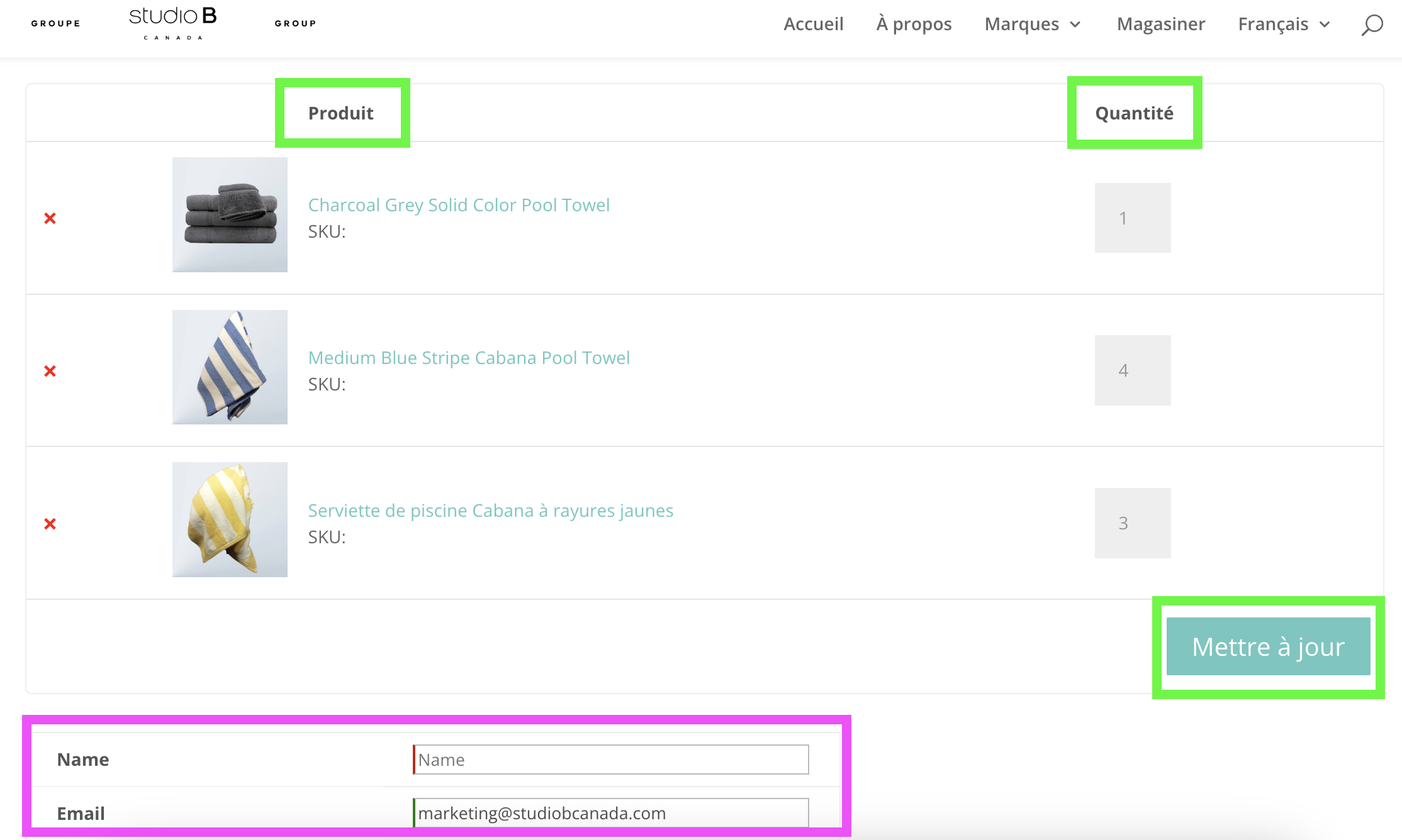

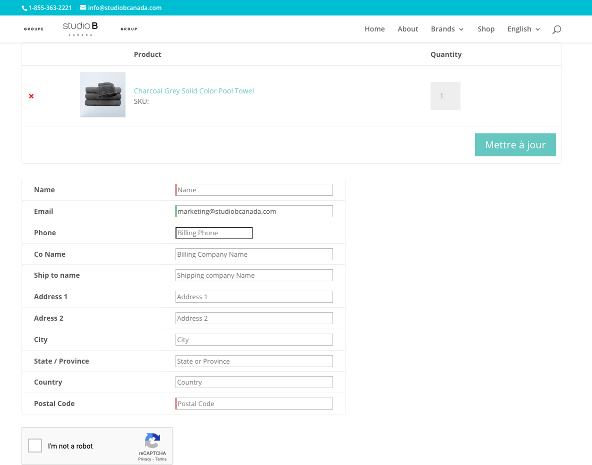

I have a visibility problem with form display on a quote page using B2B Woocommerce / WPML plugins and Divi theme. I checked with the Divi team and they confirmed it's not theme related. The form shows up on the English version but not the French.
The urls :
English =hidden link
French = hidden link

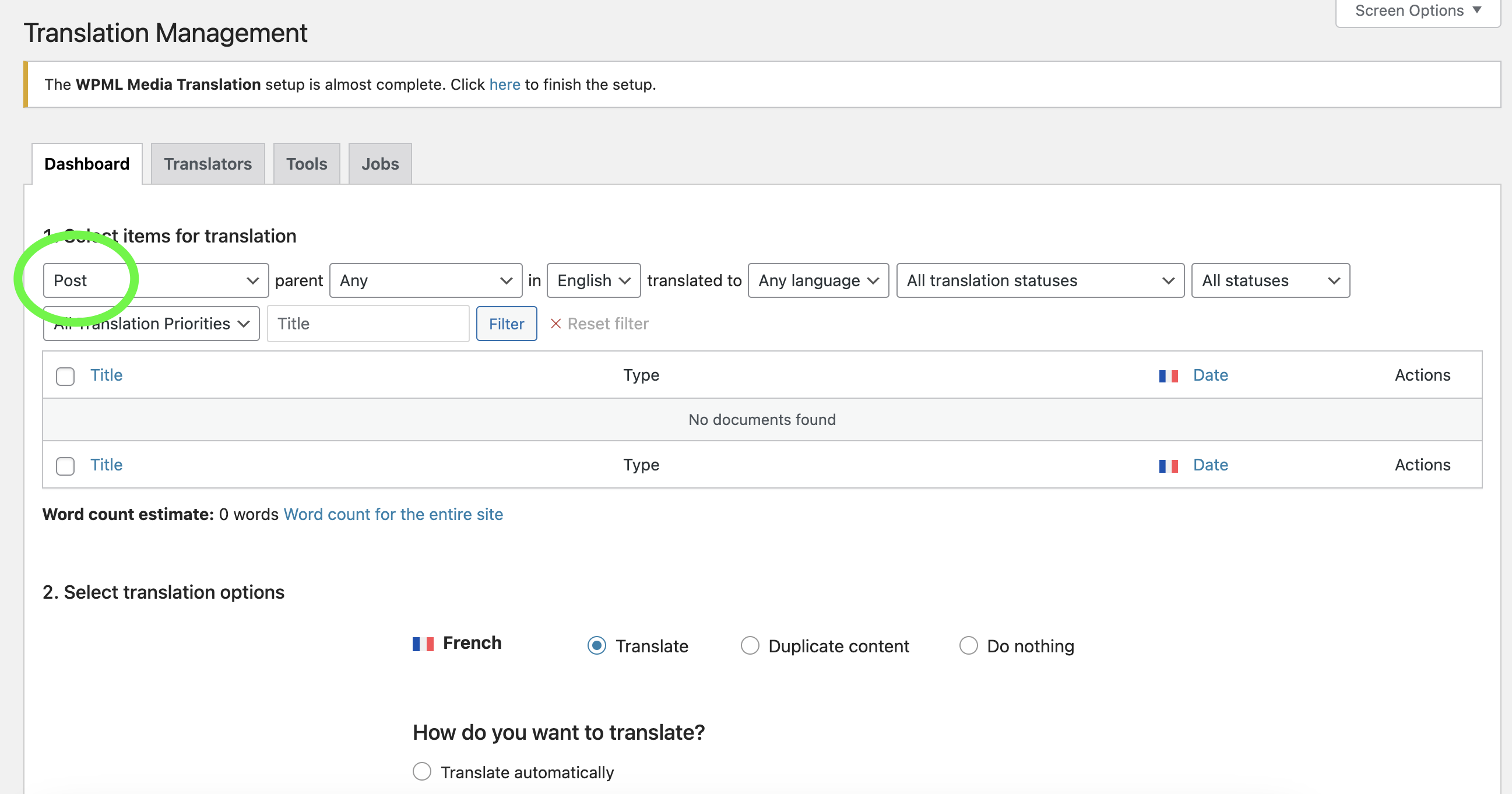

January 4, 2024 at 3:22 pm #15151945
timB-58
Hello Long,
I've looked for posts to translate in the WPML plugin but haven't found anything. I decided to go look at the page parameters in WP and found that when I want to change the setting of the page to require translation, it can't complete the task so that I can update.
Have you ween this issue before?
January 5, 2024 at 1:12 am #15153134
Long Nguyen
WPML Supporter since 02/2022
In the Translation Management board, you can filter by the post type, not "Post" to translate the form. If the translation is stuck, please follow the documentation below to solve this
https://wpml.org/faq/translation-status-stuck-or-displaying-the-error-wpml-didnt-manage-to-translate-this-page/

January 8, 2024 at 3:12 am #15158038
Long Nguyen
The page "request-a-quote" is set to display the quote fields by the option "addify_atq_page_id" and it is not translated. I go to WPML > String Translation > Translate texts in admin screens > Search for the option > Add it to String Translation. Then I translate it with the translation page ID.
Now you can see the quote fields displayed in the French language as well.
Refer documentation https://wpml.org/documentation/getting-started-guide/string-translation/finding-strings-that-dont-appear-on-the-string-translation-page/
Look forward to your reply.
January 8, 2024 at 2:32 pm #15160941
timB-58
Hello Long,
Thank you for your instructions, I followed the steps and I can see the form in the French version. I have a question regarding the translation of the form fields & labels. I know I did that already, so I'm wondering why the translation isn't applied to the form when the other items in the page template are translated?
Thanks!
