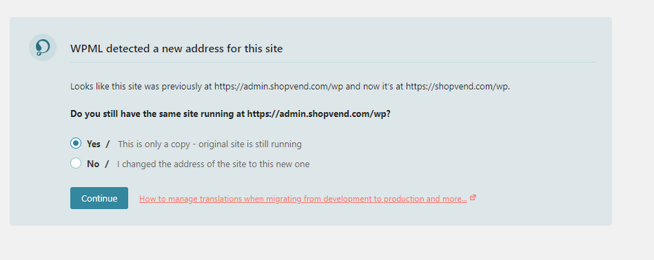

I have two domains, admin.shopvend.com and shopvend.com, both registered with WPML and using the same database. I am trying to manage translations across both sites.
The translation management is not working on both sites. Each time I try to enable it on one of them, it keeps getting disabled, and I receive the notification 'WPML detected a new address for this site'.
How can I enable translation management on both sites without it getting disabled?
How can we maintain both websites on the same database without issues?

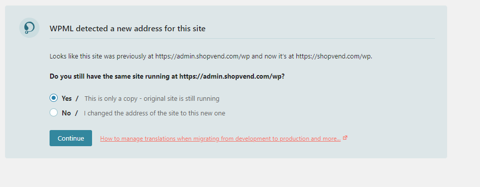

I selected this option but after a short time the same message keeps appearing again
both sites on same db

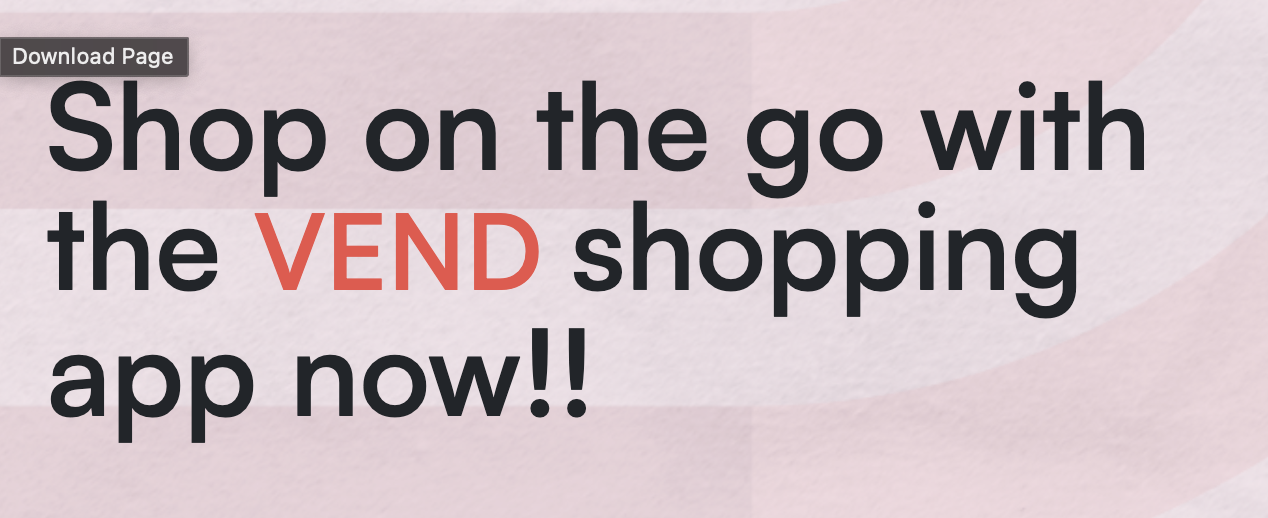

I went to the admin site and as a test changed something on the download page. Added an extra !. (screenshot)
Then the change is also shown on the shop page. I have never seen such setup.
So the problem is that the site is exactly the same! It is not a copy of the previous website.
So when a new domain is detected the WPML plugin adds proper settings in the database. But the database changes is now for the current domain, but the same database is also approached with another domain and that confuses WPML.
I do not think it is possible to use WPML on both website with this scenario.

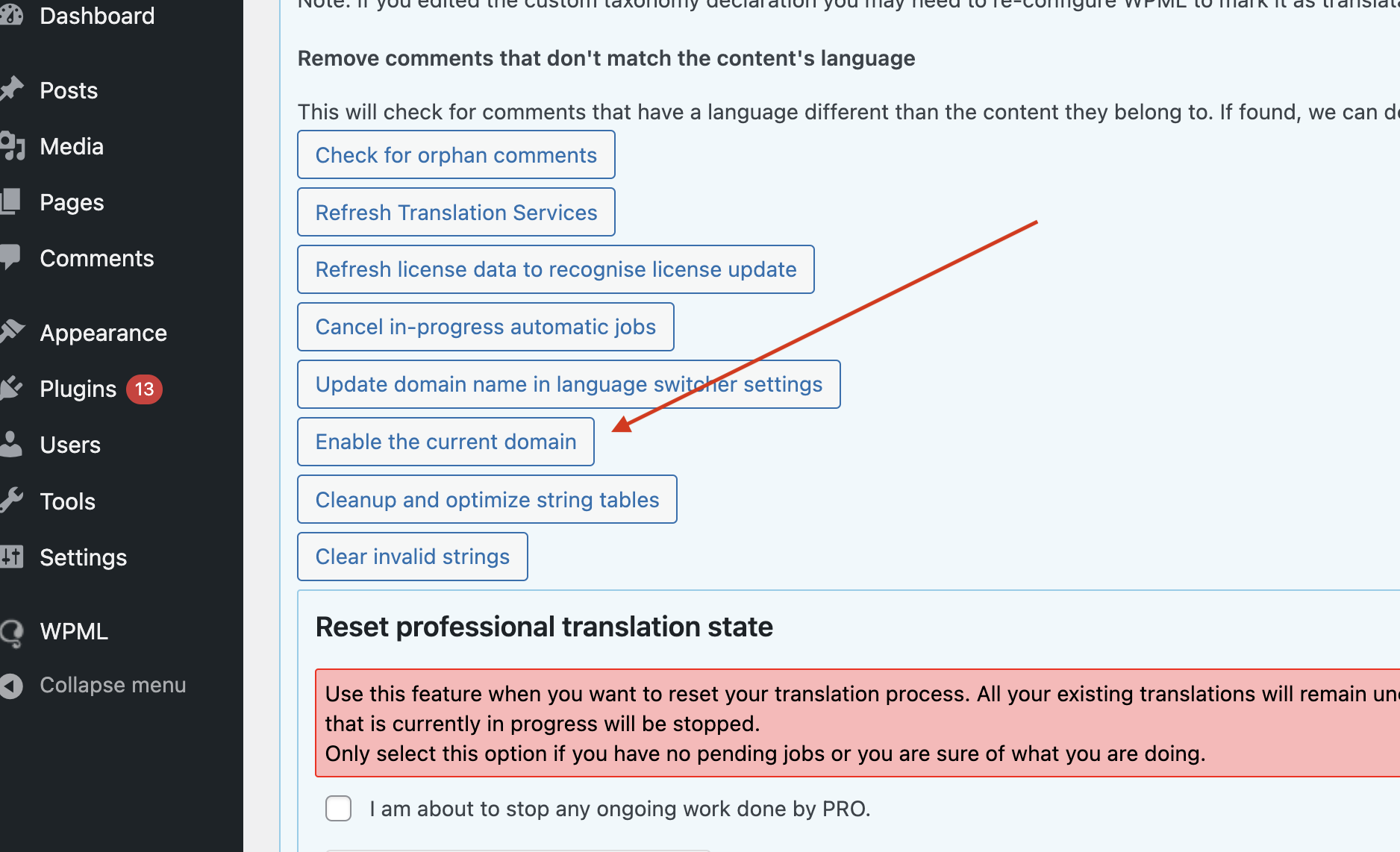

I have an answer. This seems to be also raised by another customer that had a setup like yours.
We will provide a feature in WPML 4.7 release that you will be able to enable the domain and get rid of the copy/move box. (Check the screenshot)
It is not available at the moment, and I do not have an ETA for version 4.7 release as it will be a major one and it needs extensive testing process.
For now, you need to live with clicking the copy option each time if you want to change something or you can using only one domain for your edits for the time being.
