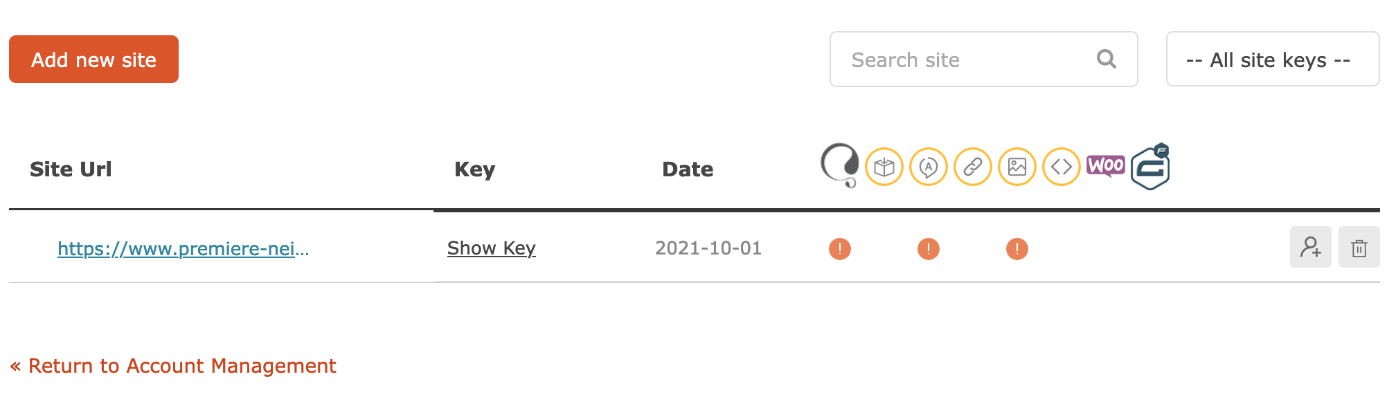

I wish to set up a staging site for hidden link that I can then push to live. How do I do this? Do I create the staging site and then register it, or should I do this another way. I am registered with Siteground.
Of note, currently my main site says it is not up to date - but on the site it doesn't notify me that there are outstanding updates what should I do? I'll need to sort this before I register the staging site I assume.

The staging site is created separately and you can use a new WPML key set up as "dev" instead of "production".
Then, you go to the backend of the staging site > install WPML > activate it > then register it with the new key.

With Siteground the staging site keeps the same name in this case staging4.premiere-neige.com. Does this mean I just need to register this as a dev site with a new key? Hopefully I only need to do this once? I believe I can have several dev sites without using any more of my 3 licences, can you confirm.

"I believe I can have several dev sites without using any more of my 3 licenses, can you confirm." - that's correct.
