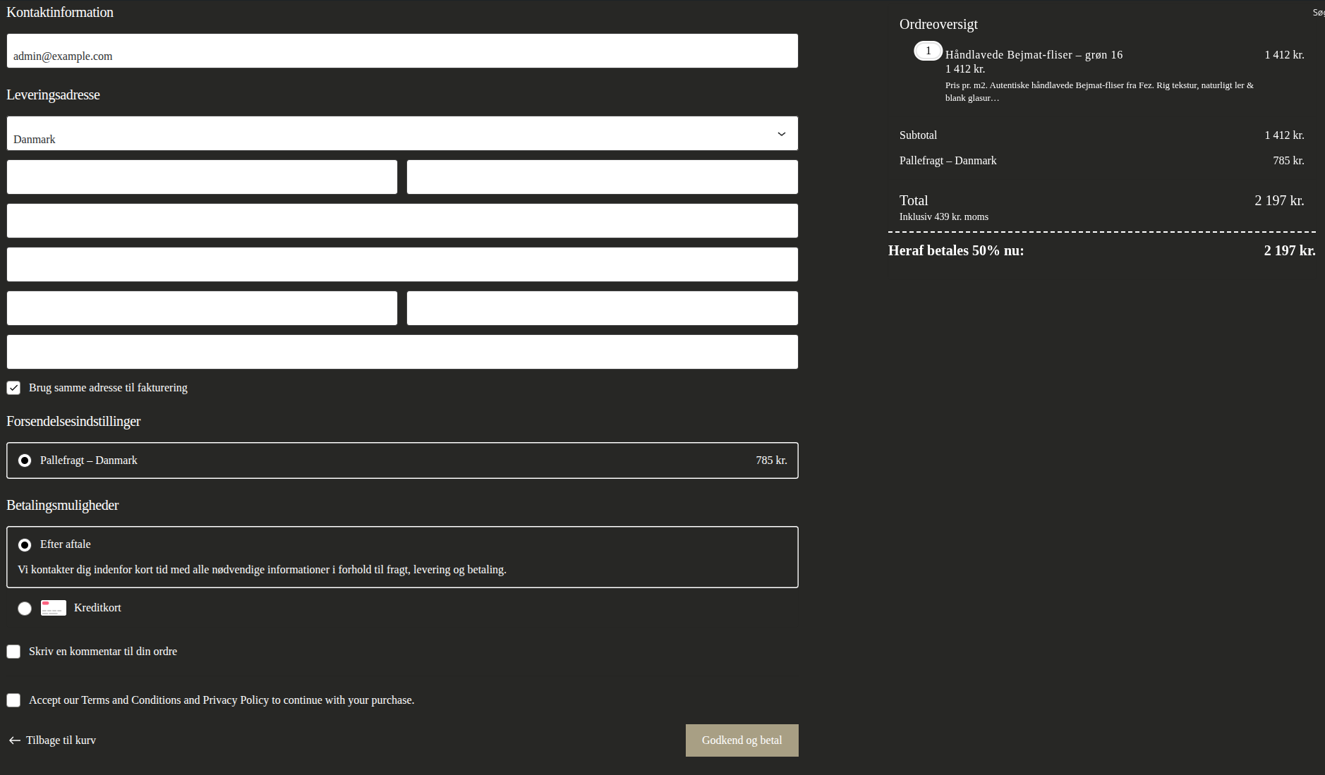

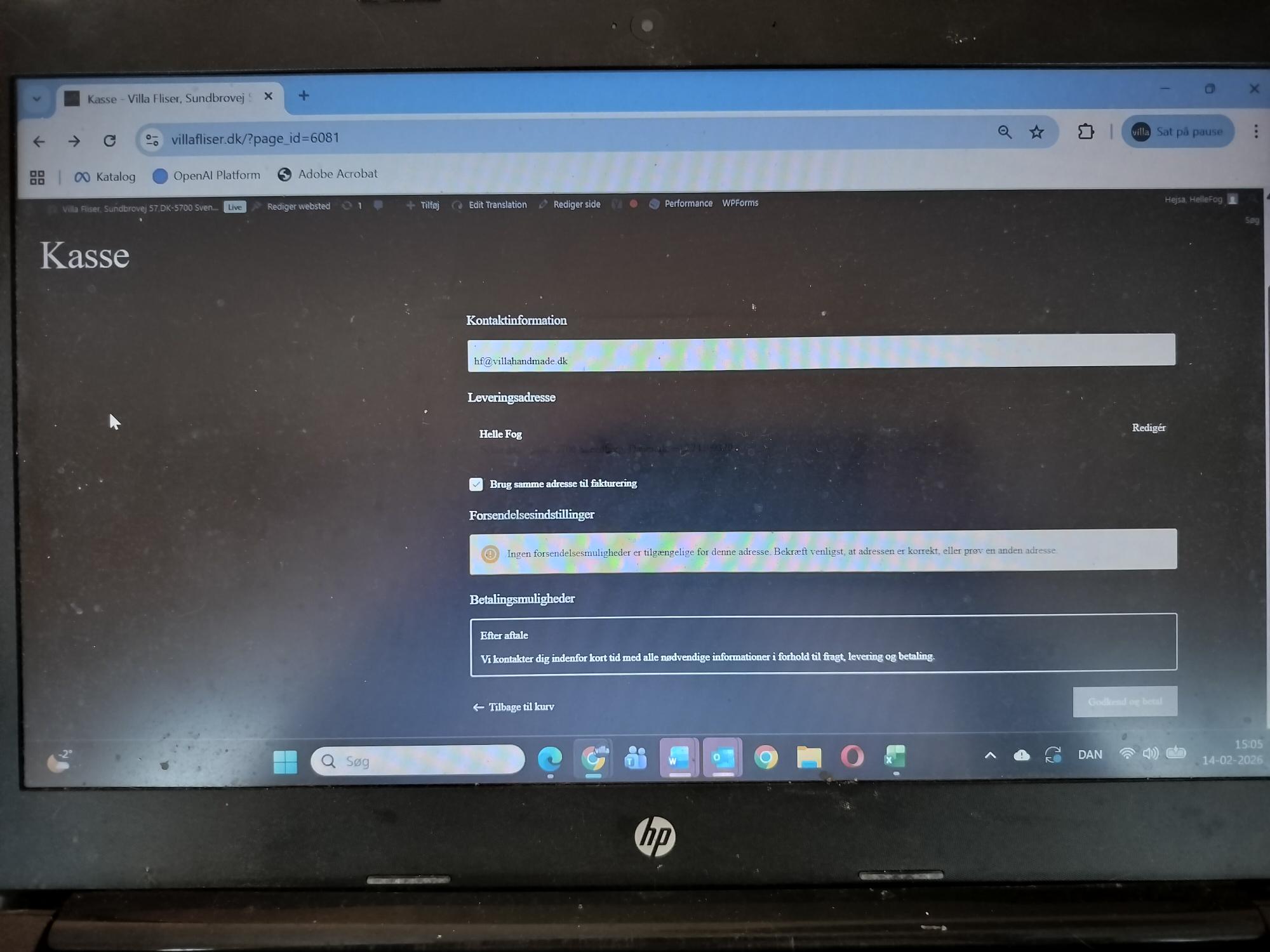

But it turns out that the problem mentioned is the lesser problem.
The BIG problem now is as follows:
The checkout is not working at all.
What I Want:
- Shipping according to weight rates - and a possibility to chose pickup at warehouse
- 50 % deposit that is drawn in by OnPay (card payment) when ordering - checkout showing the amounts for payment now - as well as for payment later when goods are delivered.
What I Experience:
- checkout that does not show order panel on the right side (only address etc.)
- no possibility of checking if 50% deposit works or not - or if clients get a proper information about terms concerning 50% payment now - 50% payment later
What I Have Tried in Order to Trouble Shoot and Solve the Problem:
- deactivated all snippets conc. checkout and cart
- deactivated OnPay
- deactivated all shipping set ups
- trashed the checkout with the missing right panel
- created a new checkout with WP tools
What I Find Now:
- checkout still not showing right panel with order information
- going from cart to checkout - the checkout is not loading - meaning it is not possible to access checkout from cart
Please help ASAP

February 14, 2026 at 2:27 pm #17822596
helleF
Hi again,
just to let you know. I also did a trouble shoot concerning the theme.
I changed to Twenty Twenty four to try out - but the problem did also occur in that theme. So it is not theme related either.

I did manage to solve the problem with 50% deposit and the right summary panel in the Danish frontend checkout. After around 15 hours of work over the weekend. You had apparently installed CORS headers between the domains - not enabling the transmission of data to the Danish site.
As OnPay is still not ready, I am not ready to check if the 50% withdrawal is actually working. If you have possibility of checking on that issue - please let me know if it is actually working. Thanks. For now: Please concentrate on the shipping data which is still an open problem to be solved.
Thank you.

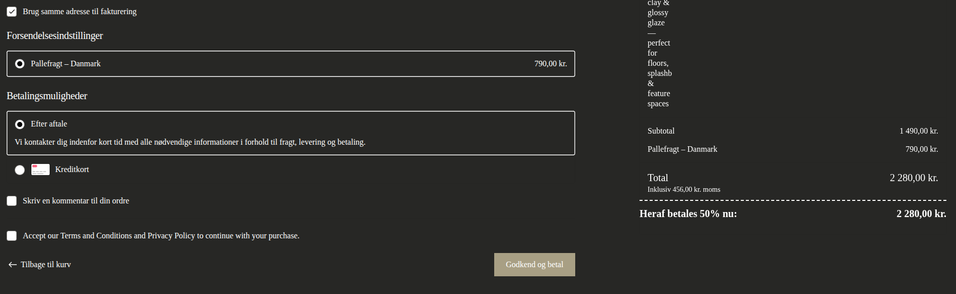

February 16, 2026 at 3:19 pm #17826340
helleF
Hi again,
Well - as it turns out. I did only partly manage to solve the problem with the checkout.
The issue concerning 50% deposit is not solved in relation to OnPay. The amount which is passed on to OnPay and drawn in is the total - and not the deposit of 50%.
the code which I placed in "code Snippet" is as follows:
* 1. TEKNISK (BLOCKS): Halver beløbet i det nye Blocks-checkout
* Dette rammer ordren lige før den gemmes og sendes til OnPay API'et.
add_action('woocommerce_store_api_checkout_update_order_meta', function($order) {
$current_total = $order->get_total();
$order->set_total($current_total / 2);
$order->save(); // Vigtigt: Gemmer ændringen i databasen
}, 10, 1);
* 2. VISUEL INFO: Besked i toppen af kurv og checkout
add_action('wp_head', function() {
if (is_cart() || is_checkout()) {
$is_dan = (defined('ICL_LANGUAGE_CODE') && ICL_LANGUAGE_CODE === 'da');
$msg = $is_dan
? 'Bemærk: Du betaler kun 50% nu. Resten faktureres ved levering.'
: 'Note: You only pay 50% now. The balance will be invoiced at delivery.';
echo '<style>
.custom-deposit-info { background: #e0efff; color: #004a99; padding: 15px; text-align: center; font-weight: bold; border: 1px solid #b3d7ff; margin: 20px 0; border-radius: 4px; }
</style>';
echo '<script>
document.addEventListener("DOMContentLoaded", function() {
var target = document.querySelector(".wp-block-woocommerce-cart, .wp-block-woocommerce-checkout");
if (target) {
var div = document.createElement("div");
div.className = "custom-deposit-info";
div.innerText = "' . $msg . '";
target.parentNode.insertBefore(div, target);
</script>';
* 3. VISUEL BEREGNING (HVID/FED): Vises i højre panel
add_action('wp_footer', function() {
if (is_checkout()) {
<script>
document.addEventListener('DOMContentLoaded', function() {
const observer = new MutationObserver(function(mutations) {
const totalElement = document.querySelector('.wc-block-components-totals-footer-item .wc-block-components-totals-item__value');
if (totalElement && !document.querySelector('.custom-deposit-row')) {
let totalText = totalElement.innerText;
let cleanTotal = totalText.replace(/[^\d]/g, '');
let totalNum = parseFloat(cleanTotal) / 100;
if (!isNaN(totalNum)) {
let deposit = (totalNum / 2).toFixed(2).replace('.', ',');
let isDan = document.documentElement.lang.includes('da');
let label = isDan ? 'Heraf betales 50% nu:' : 'To be paid now (50%):';
let currency = isDan ? ' kr.' : ' DKK';
const depositRow = document.createElement('div');
depositRow.className = 'wc-block-components-totals-item custom-deposit-row';
depositRow.style.cssText = 'color: #ffffff !important; font-weight: 900 !important; padding: 15px 0; border-top: 2px dashed #ffffff; margin-top: 10px; display: flex; justify-content: space-between; font-size: 1.25em;';
depositRow.innerHTML = `<span>${label}</span><span>${deposit}${currency}</span>`;
totalElement.closest('.wc-block-components-totals-footer-item').after(depositRow);
const target = document.querySelector('.wp-block-woocommerce-checkout');
if (target && observer) { observer.observe(target, { childList: true, subtree: true }); }
</script>
<?php
}, 999);
The problem is apparently that the block system does not accept the codes, - no matter how I do it. Could you please help with this as well. Thank you.

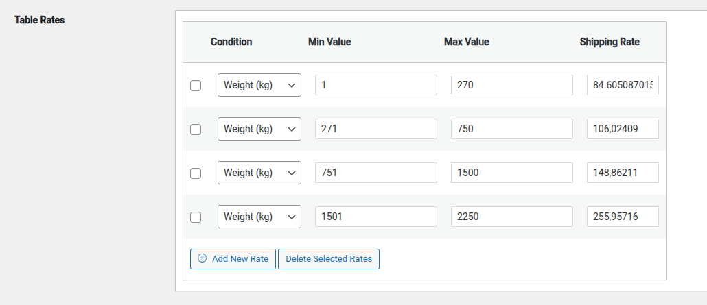

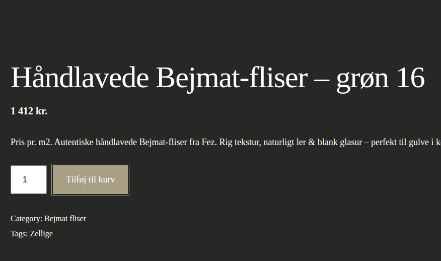

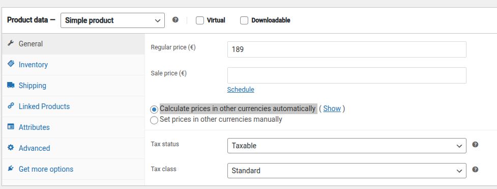

February 20, 2026 at 11:34 am #17837970
Paweł Halicki

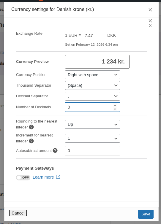

I have completed an initial analysis and since there are several issues, I will start with the one that affects the most mechanisms - converting from EUR to DKK. Then I will look for solutions for the next ones (perhaps this will eliminate some problems elsewhere)
The product must have:
- a single price set in EUR
- the option “Calculate prices in other currencies automatically” must be enabled.
Next, in the WooCommerce admin panel under WooCommerce → WCML → Multicurrency (tab), in the “Currencies” section:
- Click edit (pencil icon) in the "Danish krone" row.
- A popup will appear, where you need to click edit (pencil icon) again in the "Currency Preview" row.
- A menu will appear allowing you to configure the currency behavior. Here you can set “Number of Decimals” to “0” - only whole numbers will then be displayed.
- Below, there are also options to set price rounding
- documentation section for more details:
https://wpml.org/documentation/related-projects/woocommerce-multilingual/multi-currency-support-woocommerce/#secondary-currencies
This configuration should cause product prices and shipping to be displayed according to the rules used for the DKK currency
In the screenshots, I am attaching the final result
Please let me know if this is a step in the right direction, so we can move on to solving further problems. Or if you need any help (in this area) before we move on to the next reported issues.
- Are VAT problems already occurring at this level?
Best regards and I'm waiting for your feedback

3) I cannot set the shipping costs in fixed DKK (secondary currency). Either you fix that - or you tell me how to get WPML to calculate (not display!) with decimals (from Euro) - in order to display DKK prices that are not with decimals.
This should not be solved by changing the whole price policy on my page. If WPML shipping cannot be displayed properly in secondary currency, I will accept that - and live with this flaw. Tell me if that is the case.

3. The conversion is linked to rounding - that is why I made this suggestion. However, if the current state is correct, then with the current configuration it should be enough to replace “,” with “.” - I am attaching screenshots showing the result on my end.
Please provide your feedback, and I will prepare the next steps.

February 23, 2026 at 10:48 am #17842387
helleF
Thank you.
Ref. 1 and 3, - it seems to work now.
