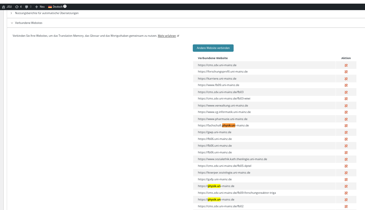

I am trying to automatically translate a page, but suddenly there are no credits available. The issue can be seen at the following link: hidden link.
The site connection for shared use of credits is 'lost'. So there are no credits for automatic translation available. I had to transfer the site key again, resulting in two entries in the list of connected websites. The key is in the list but not functioning.
How do I housekeep the list of connected websites?
Why is the key in the list but not functioning?
How can I anticipate this error and proactively check and replace 'lost' keys?

Ok, I have connected for you the different references you have for this site and also removed the duplicates.
The next step for you is to check the connected sites and delete from there the domains you won't plan on using again AND that are not live anywhere else.
Let me know if that helps you and if it does, then I'd like to know more about your migration but we can deal with that afterwards.

franzR-3
At this moment no housekeeping is necessary, since there are no duplicate entrys in the Verbundene Websites list.
