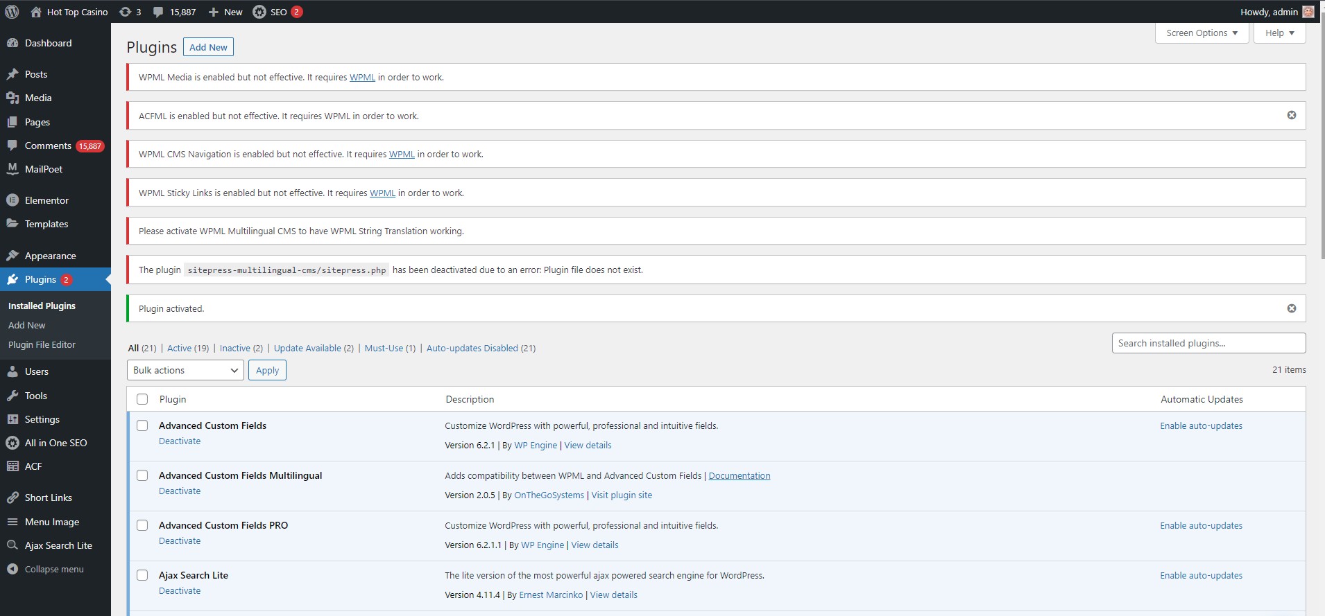

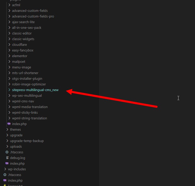

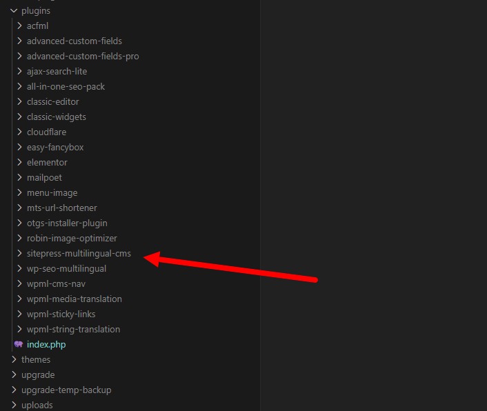

October 10, 2023 at 2:03 pm #14550913
almazK
Unfortunately I don't know the data but I can send you screenshots
I can't even enter the key
My site does not work only if this plugin is disabled, which I noted in the screenshot
Maybe I should delete the plugin and download it again?

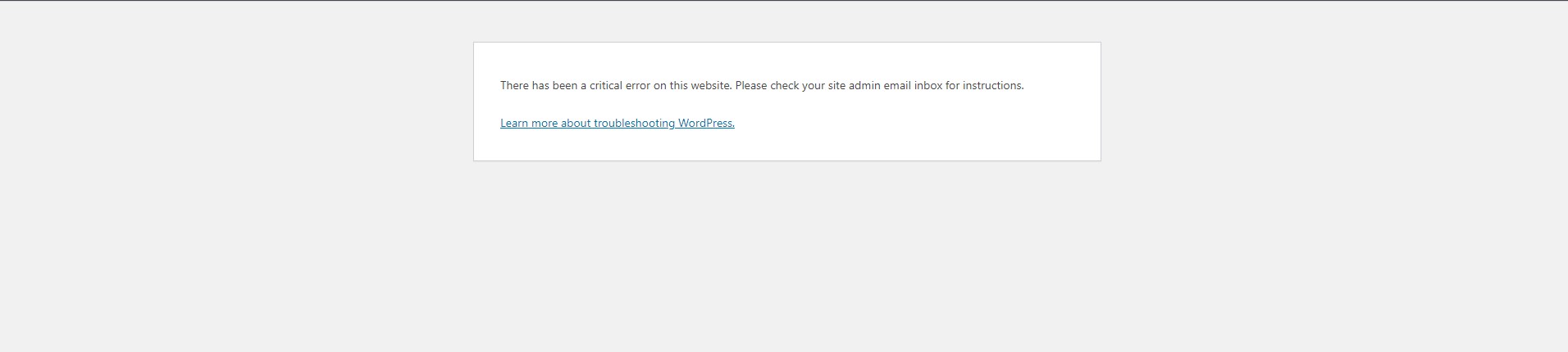

October 10, 2023 at 8:12 pm #14553665
almazK
Notice: Function register_sidebar was called incorrectly. No id was set in the arguments array for the "Right Sidebar" sidebar. Defaulting to "sidebar-1". Manually set the id to "sidebar-1" to silence this notice and keep existing sidebar content. Please see Debugging in WordPress for more information. (This message was added in version 4.2.0.) in /var/www/hottopcasino.com/wp-includes/functions.php on line 5905 Fatal error: Uncaught Error: Call to undefined function simplexml_load_file() in /var/www/hottopcasino.com/wp-content/plugins/sitepress-multilingual-cms/vendor/otgs/installer/includes/class-wp-installer.php:885 Stack trace: #0 /var/www/hottopcasino.com/wp-content/plugins/sitepress-multilingual-cms/vendor/otgs/installer/includes/class-wp-installer.php(105): WP_Installer->load_repositories_list() #1 /var/www/hottopcasino.com/wp-content/plugins/sitepress-multilingual-cms/vendor/otgs/installer/includes/class-wp-installer.php(86): WP_Installer->__construct() #2 /var/www/hottopcasino.com/wp-content/plugins/sitepress-multilingual-cms/vendor/otgs/installer/includes/functions-core.php(6): WP_Installer::instance() #3 /var/www/hottopcasino.com/wp-content/plugins/sitepress-multilingual-cms/vendor/otgs/installer/installer.php(15): WP_Installer() #4 /var/www/hottopcasino.com/wp-content/plugins/sitepress-multilingual-cms/vendor/otgs/installer/loader.php(227): include_once('/var/www/hottop...') #5 /var/www/hottopcasino.com/wp-includes/class-wp-hook.php(310): wpml_installer_instance_delegator() #6 /var/www/hottopcasino.com/wp-includes/class-wp-hook.php(334): WP_Hook->apply_filters() #7 /var/www/hottopcasino.com/wp-includes/plugin.php(517): WP_Hook->do_action() #8 /var/www/hottopcasino.com/wp-settings.php(610): do_action() #9 /var/www/hottopcasino.com/wp-config.php(105): require_once('/var/www/hottop...') #10 /var/www/hottopcasino.com/wp-load.php(50): require_once('/var/www/hottop...') #11 /var/www/hottopcasino.com/wp-admin/admin.php(34): require_once('/var/www/hottop...') #12 /var/www/hottopcasino.com/wp-admin/plugins.php(10): require_once('/var/www/hottop...') #13 {main} thrown in /var/www/hottopcasino.com/wp-content/plugins/sitepress-multilingual-cms/vendor/otgs/installer/includes/class-wp-installer.php on line 885
There has been a critical error on this website. Please check your site admin email inbox for instructions.
