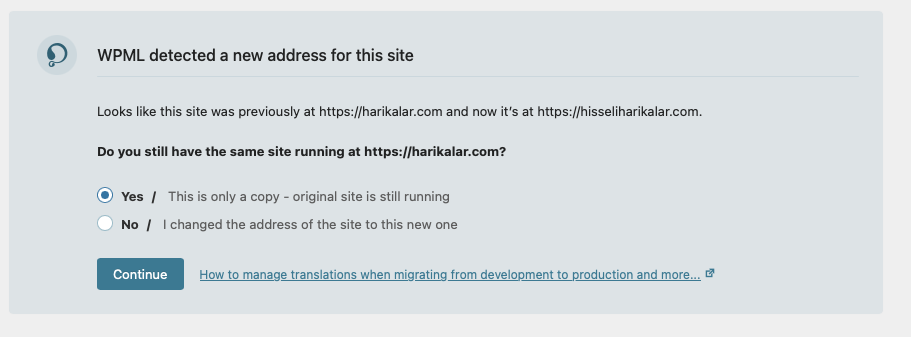

Hey,
Our website address was hidden link now we totally moved our website to hidden link. hisseliharikalar.com is only a redirect now.
But wpm thinks that we were in harikalar.com before and we ar now on hisseliharikalar.com so it asks for the migration code which I can not obtain.
Can we fix this?

This indeed looks incorrect and should not be showing.
From the debug information you supplied I can see that the WordPress memory limit is set to 40MB. You should increase this to 128MB, as that is the minimum requirement for using WPML in the best way.

After updating the memory, if the issue persists, please do the following:
- Go to WPML -> Support -> Troubleshooting and click "Clear the cache in WPML"
- Follow the migration wizard, selecting "No" and clicking "Continue"
- If after this you encounter any issue, re-registering (un-register, then remove sitekey, then re-register) your site will probably resolve it.
